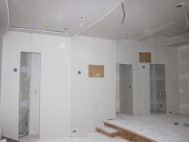

The ceiling of the isolation shell was framed at 12'. After clips, channel, DD, and then the level changes of the tiered ceiling, we average around 10' throughout the room.
post #153 of 387

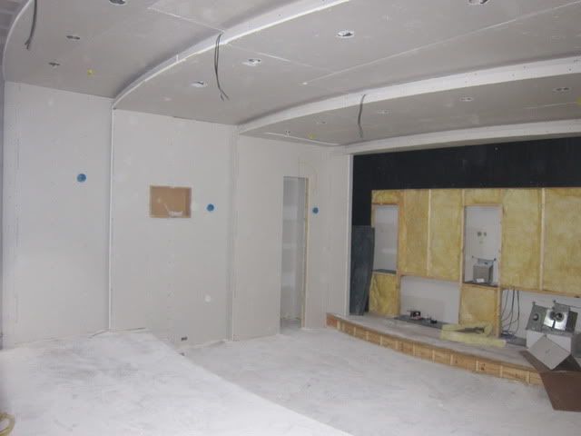

A little progress this week. Got the ceiling painted (color not very accurate in photos), cabinets installed in the kitchenette, and the bar framed. Here are the photos:
Next up--I am going to lay out the lines for the fabric tracks and build my equipment rack. The doors are being drilled and hung soon (hopefully).

The walls look stepped around 1 foot at a time. Was that ideal for your room, or did you reduce the size of each step to make the room look nicer?

I think you may be disappointed in the ceiling color. I would recommend something darker for sure.
I too am a little concerned. But in person, it is a shade or two darker than the photo. So, we have decided to leave it for now and repaint if we have problems once we get the PJ cranked up.
The decreasing size of each tier was Dennis' design. He would need to speak to the "why."
I think the varying sizes adds visual interest to the room. If each were the exact same length, I don't think it would look quite as interesting.
Not speaking for Dennis, but I am sure that is why.
