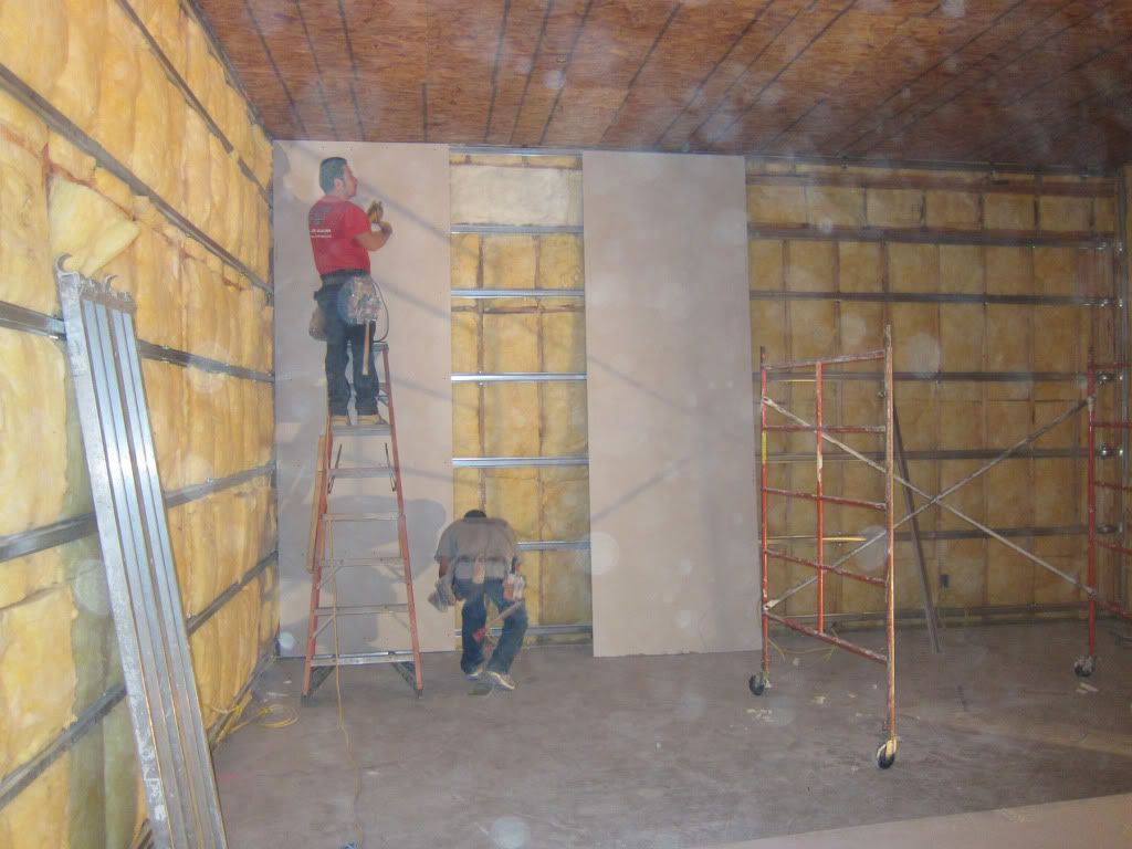

Feels like we are moving a little now. We got the R19 batts in the walls and the drywall crew started hanging the channels today. We are scheduled to put up the first layer of OSB on the ceiling on Tuesday, hopefully.

Did your drywall guys know how to do the clips & channel?
I'm also wondering how a typical home construction drywall crew does with DD + GG.

I had two meetings (one with the supervisor and one with the owner of the company) to make sure they understood where to place the clips. But I also started the staggered pattern of the clips by installing the ones on the bottom myself. So, that made it easier for them. They just had to follow the pattern.
As for the DD & GG, I think they understand the procedure, but I will be taking a day off of work to "supervise" when we get there.

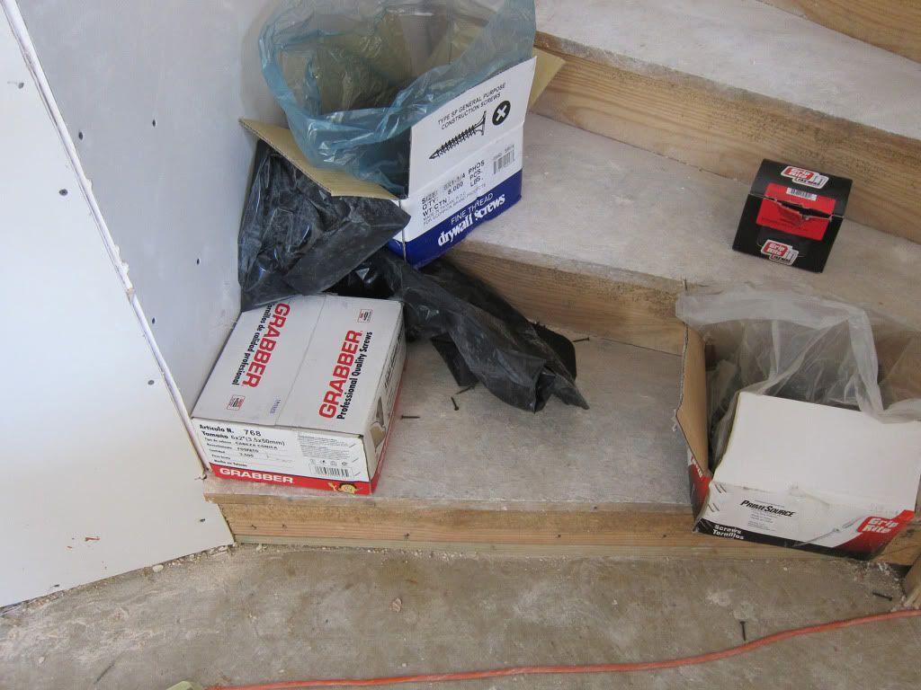

I supervised a spanish speaking crew installing GG and DDW and it is not that difficult (Bethesda build). The guys I worked with are hard workers and after you show them one correctly loaded sheet they can duplicate the next. They will however not speak up when the bucket gets empty and if the next isn't in plain sight you may find sheets going up dry. The crew I had was dropped off by their supervisor and worked at my direction for the day.
On the two layers of drywall, If you use two different lengths of screws 1 1/4 and 2 inch (assumes 5/8 DW) you can avoid them short circuiting the design. Just hide the longer screws until the first layer is up. Trust me, a polish crew used the longer screws for the first layer on the wood frame (Isolated with RSIC clips) section of a theater because it was the first box they found in the supply box I had on-site. I'm not making this up, look at the Making Bacon thread.

On the two layers of drywall, If you use two different lengths of screws you can avoid them short circuiting the design. Just hide the longer screws until the first layer is up. Trust me, a polish crew used the longer screws for the first layer on the wood frame (Isolated with RSIC clips) section of a theater because it was the first box they found in the supply box I had onsite.
BIGmouth, that is a good tip. What were the two lengths of screws you recommend? I know that they are supposed to be fine thread for metal, but I did not think about length.
I might need to go buy two different lengths tomorrow.
post #47 of 387
Updated my post. 1 1/4 and 2 inches. I really like the fine thread Grabber brand designed for metal studs. I get them for 1/2 the price of screws at HD/L's. My source is Global Building Supply.
post #48 of 387

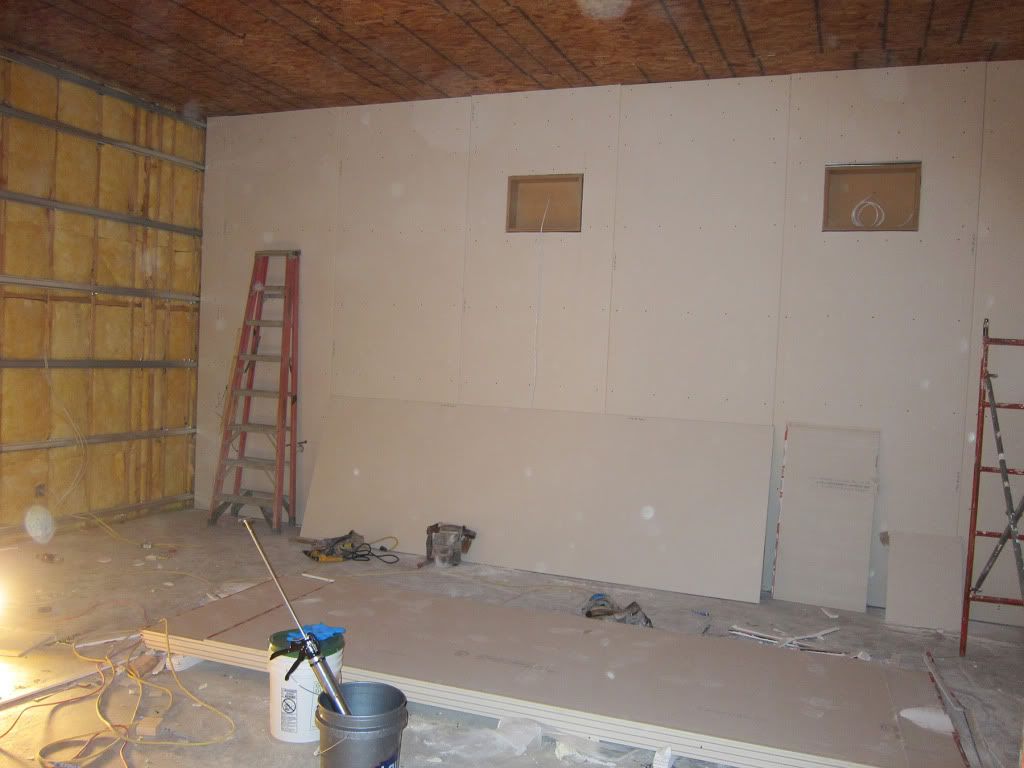

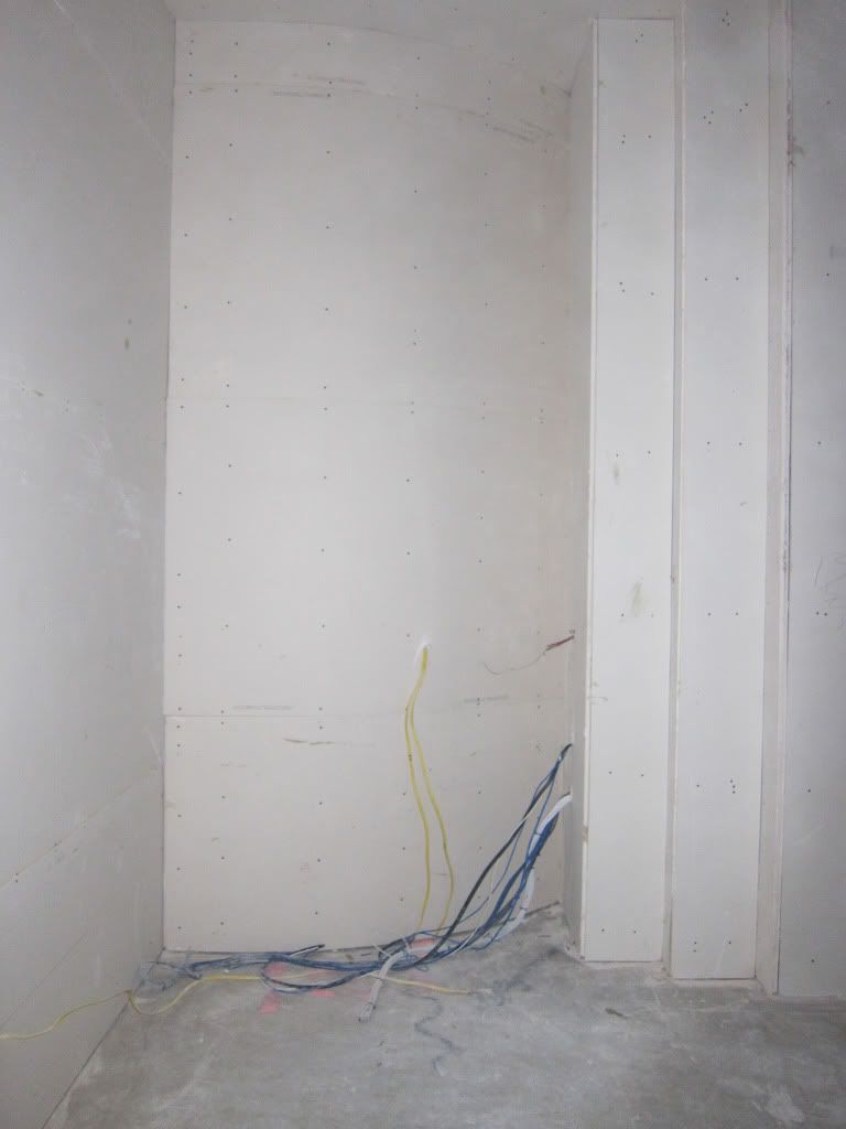

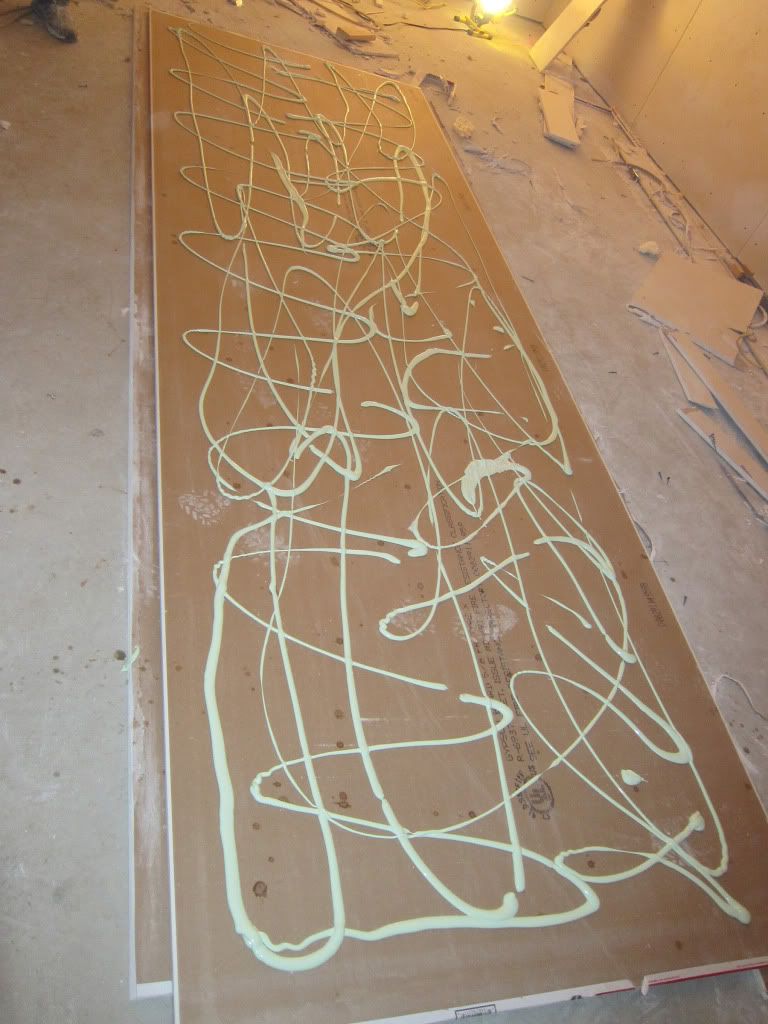

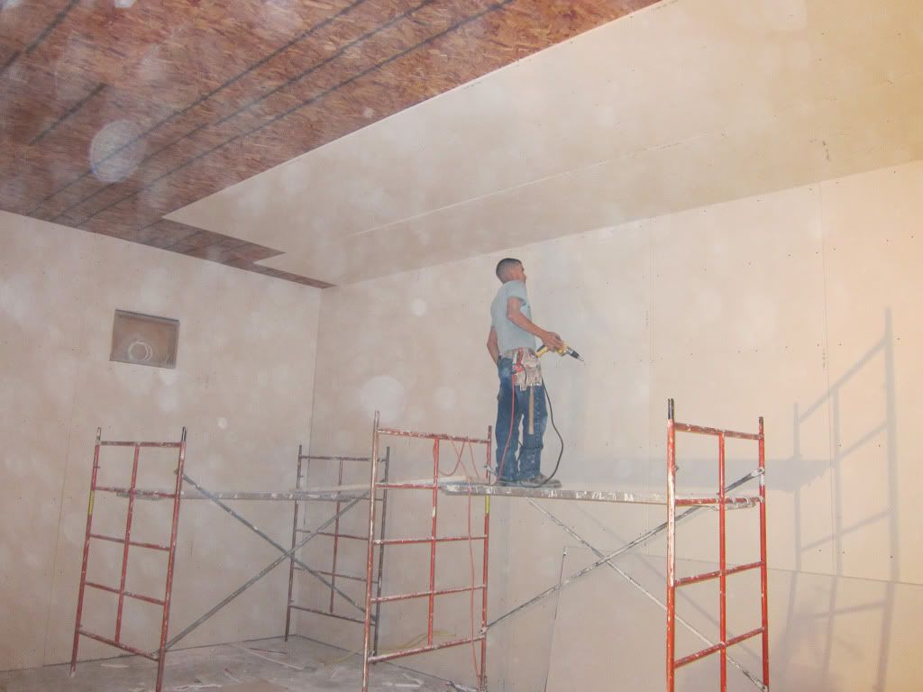

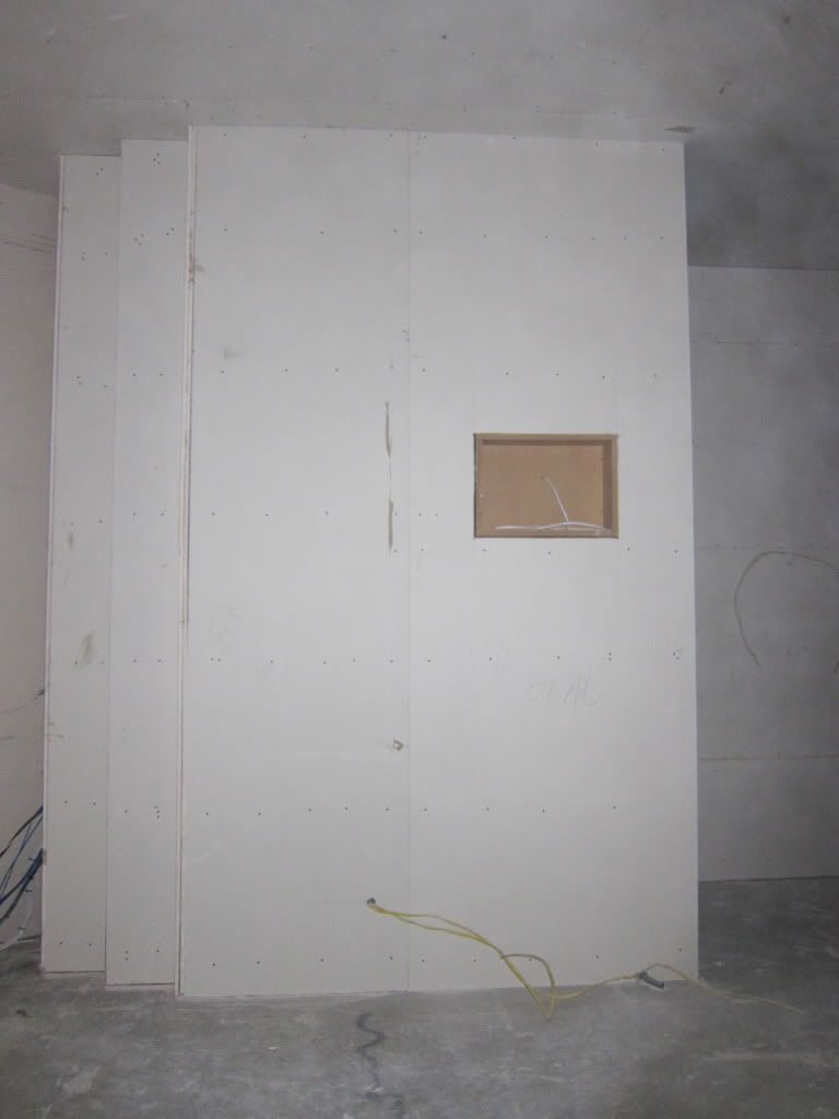

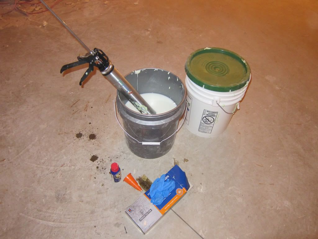

Had a fun GG & DD day yesterday. Started at 8:00am and got last layer finished around 6:00pm. All things considered, and after a few panicked phone calls to Ted White, it went fairly smoothly.
A few revelations:
1. Green glue sticks to arm hair. It sticks to faces. It sticks to Hispanic workers. It sticks to tools. It sticks to shoes. It then sticks to anything those shoes walk on (like house carpet). You get the point.
2. Green glue smells good, but it does not taste good.
3. On the first 5 or so sheets of drywall, you try to oh-so-carefully follow the "S" pattern described in the instructions. The subsequent sheets you say screw it and it just becomes a "sling it on there" in graffiti fashion process.
4. Drywall dust sucks -- big time.
Here are some photos of the progress. You may be thinking to yourself that my camera lens was really dirty, but no, that is drywall dust in the air. It now resides in my lungs.
Here are the 1 & 1/4" and 2" screws. Thanks Bigmouth!
Here is my GG workstation:
My graffiti art:
Second layer going up on ceiling:
Finished product:
Next step is to seal the corners with caulk and lay down mats and 3/4" OSB flooring. Then, seal between the floor and walls. That is my project for this weekend.

Wow, it looks great, things are going quickly in your build. What thickness OSB did you use in the room? Are you using 5/8" for both layers of drywall?
post #58 of 387
We used 5/8" OSB for the first layer of ceiling, followed by 5/8" drywall. The walls are two layers of 5/8" drywall.
