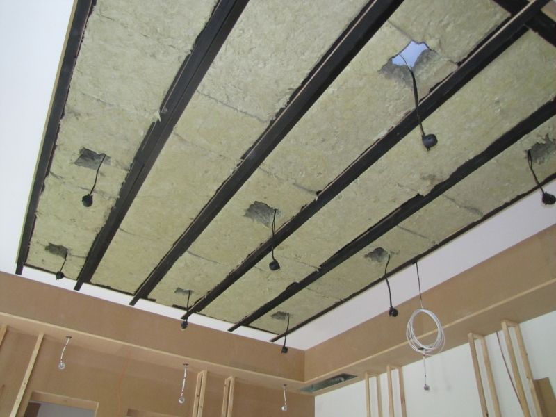

What is that ceiling baffle framing made of?
post #493 of 497
It's galvanised steel. The bottom flange is painted black so it wouldn't show through the fabric.
Cheers,

Originally Posted by Peter M View Post
Bass absorber baffle is finished, soffits finished, ceiling baffle insulated, downlight wiring done, speaker wire in, column framing underway, one speaker hole cut in baffle wall ...
Cheers,
hmm then framed around with wood, running 2X4 lenth-wise, stuffed with rockwool, wrapped in fabric, then the wood slats are on top of that? am i on the right track?
btw, thanks for all your assistance!
post #495 of 497
Basically, the fabric was temporarily taped to the underside of what you see above, and then the 2x1" timbers screwed to the gal steel framing.
Cheers,
Peter
