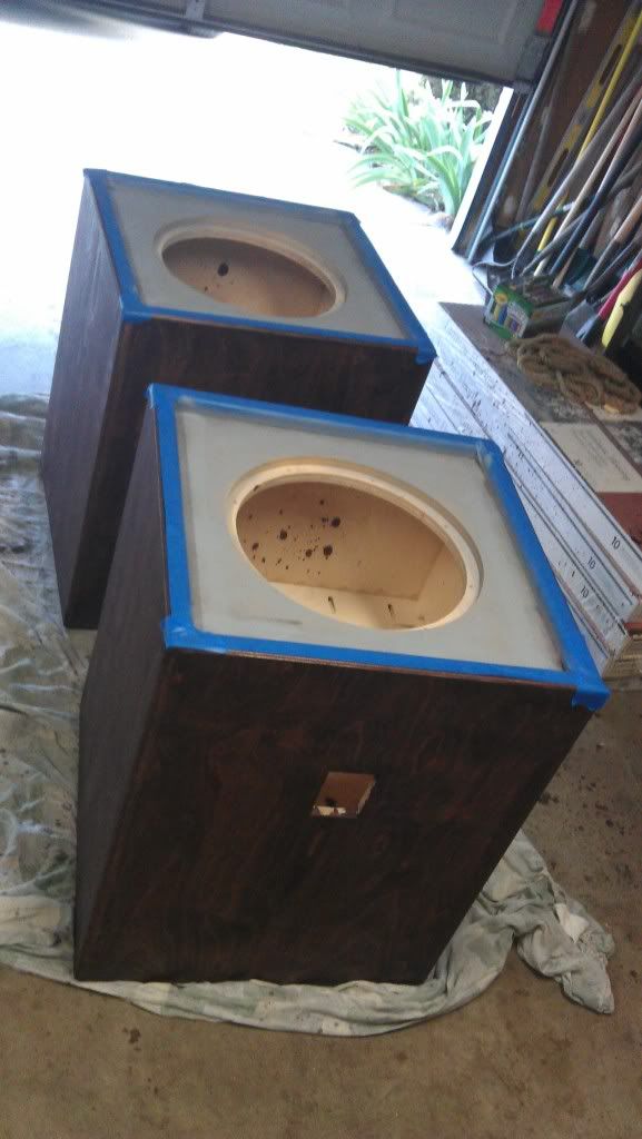

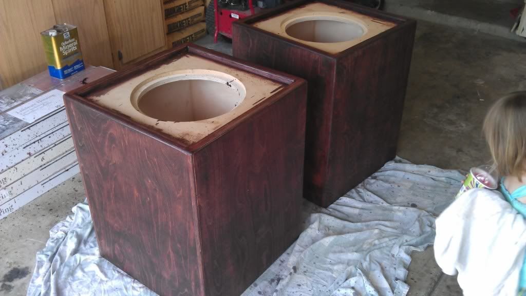

Here is a pic of the fully stained cabinets.
In that pic you can see the little baby, (soon to be big sis) drinking her free slurpee.. And the cabinets. lol. As you can tell they are just stained no finish for now, waiting for the stain to dry 100 percent. Going to be using the bar top epoxy that eric h talked about on his build.

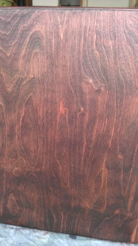

Here is another pic of just the grain on one side, I really like the way they are turning out.

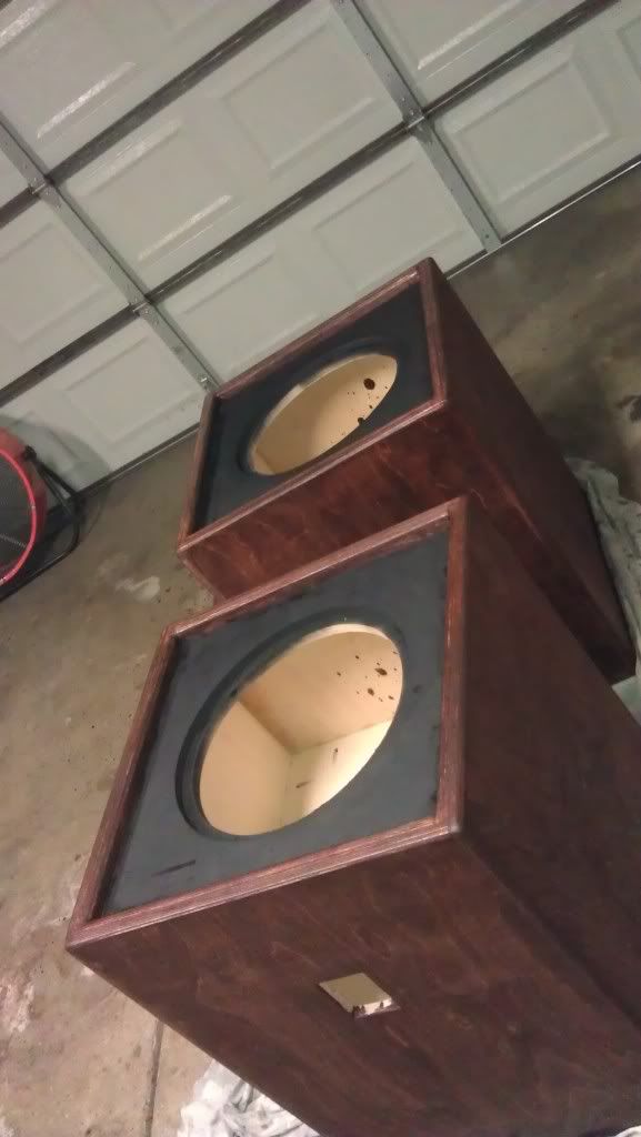

And once the stain was dry enough, I figured, hell lets tape it off, and commence to spraying the outer baffels
In that shot you can see the tape, and the primer.. Once the primer was dry it was time to spray the black.
Now imagine the black and the stain covered in a high gloss outer protective fininsh. Thats the plan, but its going to take me awhile, so stay tuned!

The stain took awhile, but I like the way it turned out, so far....
I used a brush to spread the stain, and too keep it evenly distributed. Kept brushing until the stain started to stiffen up then wiped off with a clean towel everytime.

As post number 11 shows, the untreated baltic takes stain rather unevenly. Resulting in very dark areas, and uneven tone. So I treated every area to be stained, to allow a more consistent result.
I did notice however, that you have to leave the stain on for much longer to get the color dark at all.
