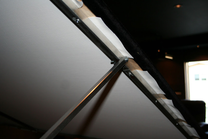

I posted in another thread a while ago how I added supports to prop the screen open when needed, but thought I'd add it here in case it helps anyone:
After thinking and thinking about different ways to prop the screen up when I need access behind the screen, starting with linear actuators, I decided to get off the pot and just do something fairly simple, which you see here - a couple pieces of 3/8" rectanglar steel tube, bolted to the back of the screen frame on one end, and drops into a hole drilled into false wall blocking on the other end.
Thanks for all the suggestions guys!

Do you think that the screen would warp if the center supports were not in there?
post #43 of 79
Yeah, definitely - when I removed the vertical supports (to paint them black, to get rid of reflection that could be seen through the screen), the frame flexed enough under the screen tension that it wasn't tensioned properly anymore. But when I put them back, all was well, and didn't have to retension the fabric.
So maybe it wouldn't warp, but I don't think it would be strong enough to maintain the screen tension.
