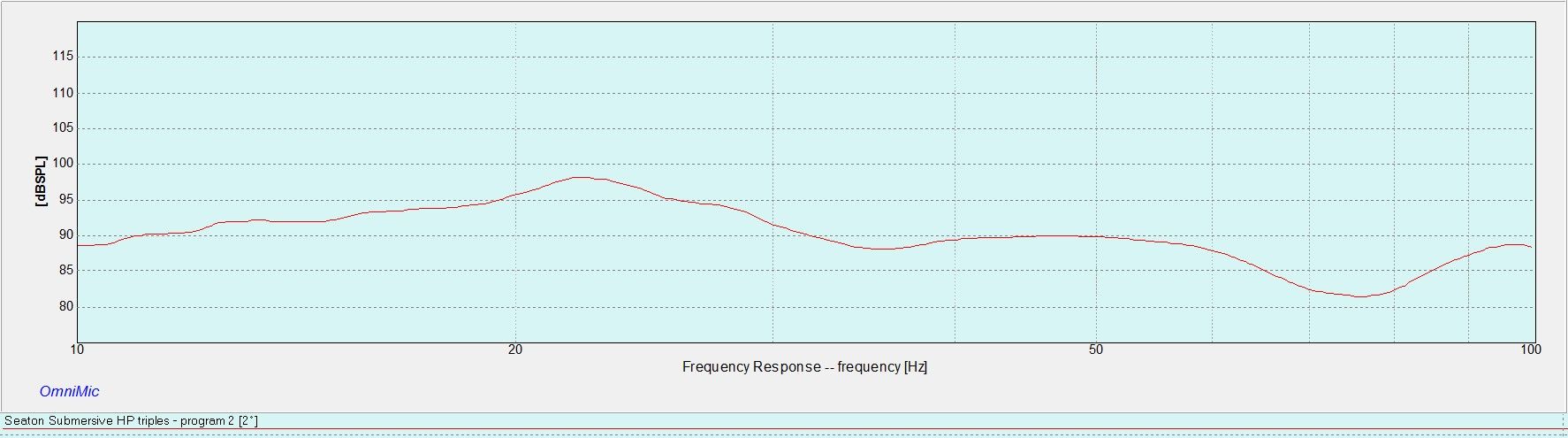

We did two tests tonight at the Gorilla83 meet. Mixed results on one test and definitive results on the other.
We had three Submersive HPS. One F2 HP, two traditional dual opposed Submersive HPs.
Here was the uneq'ed frequency response in Gorilla83's room as we listened to the three submersives. FR captured 10x's and averaged at MLP.
For the Tracks we used the most recent Incredible Hulk cop car smash scene and a snippet of the Bass I love you clip. We played both clips back to back with a minidsp engaging a HPF at 18hz, and then with the HPF removed. Then we blind tested the two tracks again and had people vote on which A / B replay had deeper bass.
On the incredible Hulk Scene 12 out of 14 people voted correctly in blind voting done by show of hands with eyes closed.
On the Bassotronics - Bass I Love You track (which contained 15 and 7hz content) - nobody could tell and we didn't even blind vote because nobody knew and everyone admitted so before the voting.

OK, most people noticed infrasonics and you were not even flat for the infrasonics. You were 6 dBs low at 10hz and who knows how much lower at 5 hz. Now imagine if you boosted the low end to have a -3 dBs point at 5 hz! Having 4 times the power just at 10hz makes a difference. That is like having 3 more submersives just for 10 hz.

I don't think they were down 6db at 10hz, there was just a 6db hump around 23hz or so. At what volume was the test run if I may ask?
post #577 of 582
To me it is the same thing because that peak is in the wheel house of many movies and will be noticed more over infrasonics(it is anyways when flat). Also you can see there is much more overall energy down low from TIH than bass I love you. Gorilla looks to have similar room gain that I have from the uneq'd graphs. I am just glad to see the guys having fun no matter what their preference is. When I went to my only GTG two subs were compared in similar fashion and just level matched with no EQ and everyone picked the same sub to sounding better(including me). Of course with EQ it could have been different. It was still fun. Now imagine running about 6 submersives with boost down low and a smaller room and that is just about right for me! You guys wonder why I talk about the low end now?

Originally Posted by ironhead1230 View Post
As far as I know, there was no difference between the two clips except for a 18hz HPF. If I remember correctly, the subs were about 8db hot and this was at +4 MV with an 80hz crossover.
-Mike
Great stuff Mike, I didn't even know you were recording this.
FYI, let me correct the calibration notes. While the subs were +8dB over the mains, the mains ended up calibrated 3dB below reference due to various concerns with gain structure and wanting to not set the outputs of the receiver too far into the +dB range, while also reducing some line induced noise due to the dimmers and grounding.
Translation: +4 on the MV was more like a "calibrated" +1dB MV with the subs +5dB.
