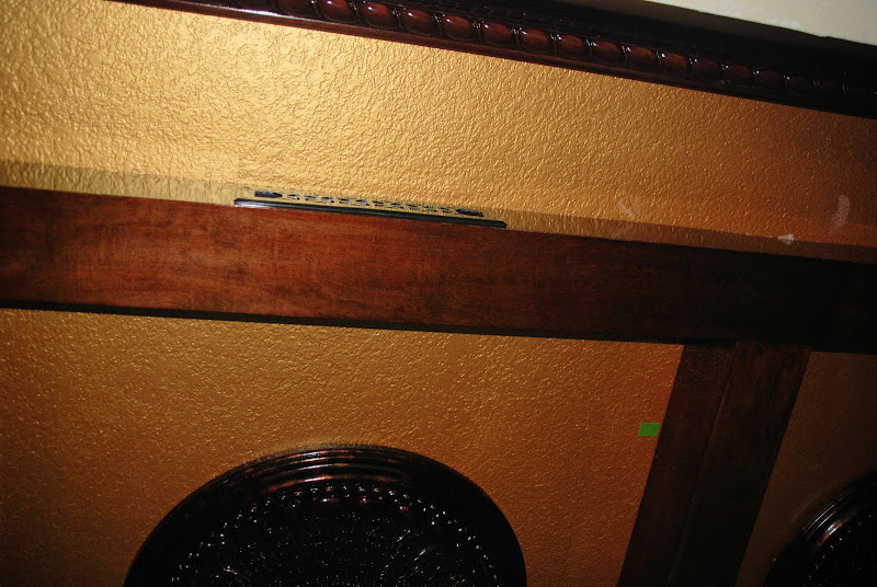

Yes, some of the materials you see are for completing a bedroom conversion. My wife and I are converting it into a den/library. The room was pretty plain-vanilla before we began on it. It will have raised paneling on the lower part of the walls around the room. I took a break from that project to make some subwoofers, since I do all my relaxing at the table saw. I didn't think it would take me so long. I was wrong.
Sorry I got off-topic.

There are recessed lights in the 4 corner medallions.
The beams are hollow (I used 1/4" plywood). Two of them carry the heating and cooling air (1 intake and 1 output), each with multiple vents which face a wall and blend in pretty well.
Sorry about the off-topic stuff, folks. I'll be back on the Howitzer build real soon.
