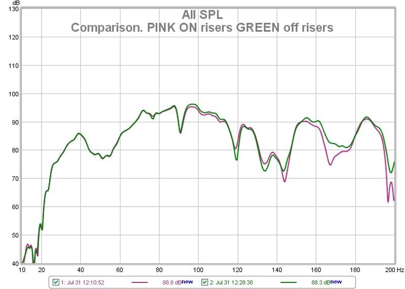

Originally Posted by terry j View Post
well done test.
one small quibble whilst we are at it, note the different scale between your FR measurements and the waterfalls? In the FR you have linear sweep, and log in the w/fall.
All our graphs are usually log represented (the way our ears work) so there is a tab up the top right somewhere to switch to log from linear. Just better that all graphs are represented the same way.
Maybe extend the comparison graph to 200 hz, any interaction changes could be higher than 89? (which seems a weird one to pick!!)
Anyways, an 'echo' of others comments and a re-iteration of mine, well done on having a look. Very few would have. And for not throwing in the towel in getting results with measuring.
One last thing on 'doing more measurements/investigation', the operating basis is that 'if you can hear it you can measure it'. Admittedly I (at least) think that hit's real world problems (can WE measure it? Do WE need specialised equipment/knowledge/experience etc etc) but as a guiding rule it is certainly valid.
The short of that is just because you did not see much in the FR domain, does not mean there is no explaining difference elsewhere. All it means is that as yet you have not measured the right thing. (it is also NOT saying there will be a measured difference!)
FR is often a very limited tool if you will. It explains a hell of a lot tho!! so is a very good guide. But, for sake of completeness, why not check a few different measurements, if you are still curious.
One last one, having done what you have done, do you STILL hear differences?? If not, then chalk it up to your mind (our mind, we ALL do it), if you do, then maybe these extra investigations may come up trumps.
Thanks for one of the 'good story' threads, they are rare and it sure 'warms the cockles of our old jaded audio forum 'earts' it does!

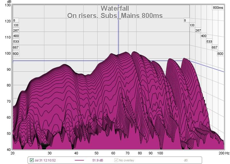

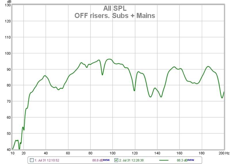

Ok everyone,
New round of REW this morning. I'm getting quite the workout
Not much difference than before.
Here we go! ALL SPL first. No smoothing applied.
Now on to the waterfalls:
I don't know how to overlay waterfalls, but upon close inspection there is a difference between On and Off risers.
Is it enough to hear a perceivable difference? I don't know, I will rely on you guys to let me know.
If any of you have some other measurement ideas let me know soon because I have yard work to to do later....
It really is looking like (at least in my case) nothing is be had with 6-7" risers.
I may have to raise them to 2 feet and try again...lol
**Added**
I have the REW file for the waterfall comparison. For those who know how to use rew I can e-mail you the file and you can load it, generate the waterfalls again and click between 2 measurements to see more easily the changes.
Test,

looks like some very severe modal ringing / LF decay issues!!

Originally Posted by test4echo101 View Post
I haven't done enough testing to prove or disprove those claims yet.
Yes you have. The FR overlay in the post following the one quoted contradicts the 10dB differences stated in the BR forum thread.

Originally Posted by localhost127 View Post
nice work.
I thought it didn't look bad - but didn't notice that the time scale goes up to 800 ms! I'm used to seeing them scaled to 300 or 500.

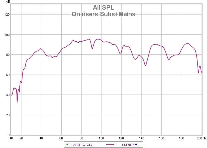

Test,
post #141 of 272
Hey Brad, yea were trying to see if decay modes are causing the "perceived" improvement is Sound Quality some experience.
I guess the longer 800ms in water data will show what a 300ms will not.
pretty sure the spectral decay is just the same as the waterfall, just presented different;y.
I don't see much difference in the waterfalls, 800 seems to much anyway. If you have a look, what I see is the sound decaying into the noisefloor...all that stuff nearest us is not the bass anymore, background noise. (bit hard to tell, but from around the 500 (?) marker, seems when we hit the background.
I can't however marry the spectral and waterfalls together...it might be an optical illusion as the waterfalls are presented on a slant as it were, the spectral from straight on if you follow. The spectral is just individual slices at the listed times.
In the OFF spectral (it's also hard scrolling up and down a long way to see btw!) look at the latest two slices (blue) at 90 hz, looks like it RISES again after having been down earlier. I don't see that in the corresponding waterfall, skewed angle not withstanding.
So something is odd, either the graphs OR my interpretation.
Oh, and the first few FR still had linear graphing, not log> No biggie, but hey.
Yes I know its tough to see a difference in the waterfalls because they are not overlaid.
But I do have the file. I could send it and you could load it into REW for yourself.
I notice a difference between them because I can click back and forth in REW quickly. On/off/On/Off.
The spectral decay is pretty surprising in a way for me because it suggests that Off Riser freq. are all over the place in the db's. They are not "playing together"
While ON the risers, the freq range seems to be moving in sync in the db range.
I would guess this is important no?
Test,
