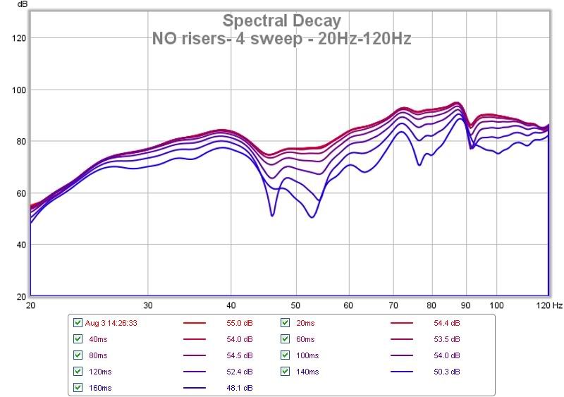

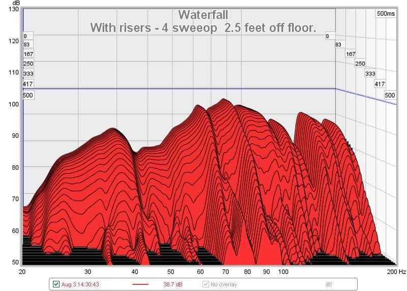

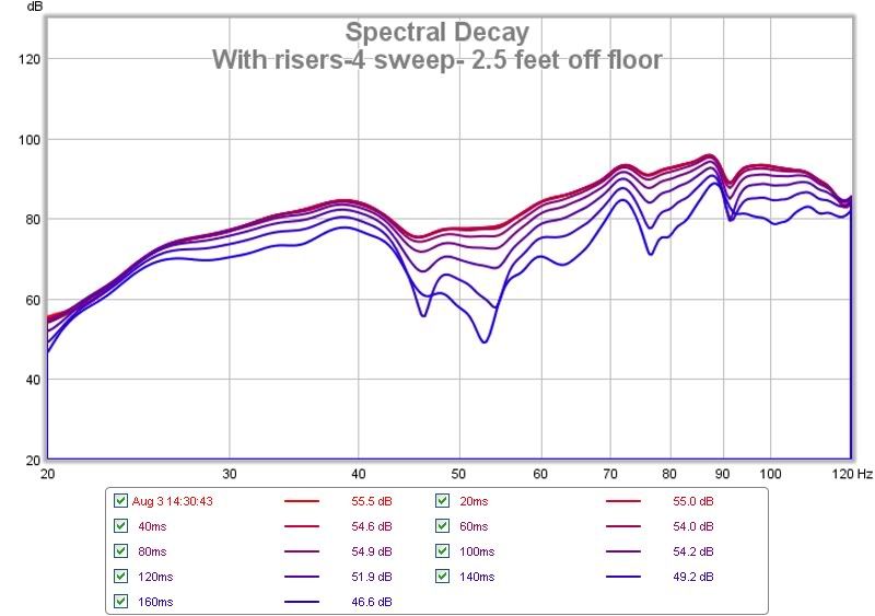

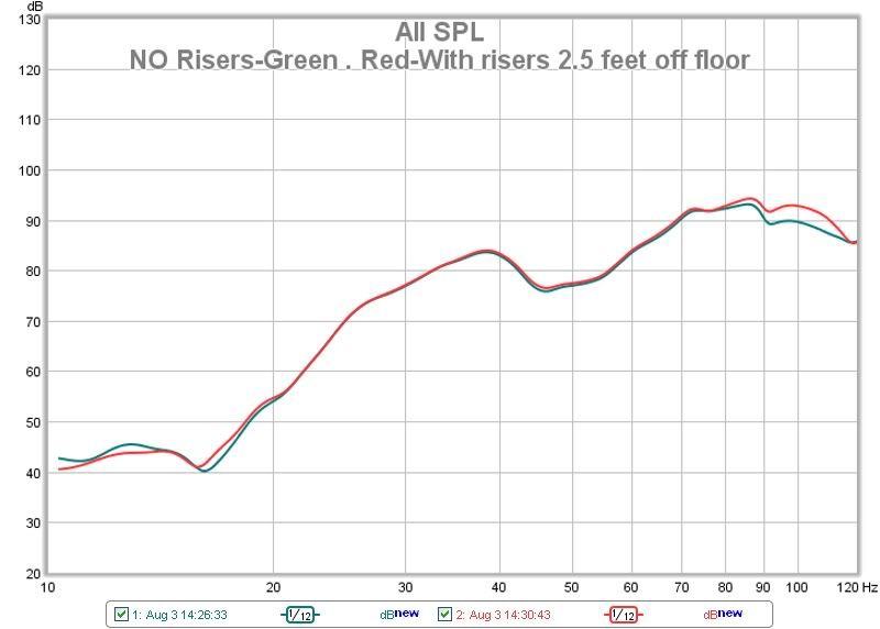

Alright fellas, this is as far as I'm taking this.
Let me re-iterate the basis for this thread.
It was suggested that rising your subs 2 feet or less could improve them.
Then, the game changed and it had to be 2 feet.
Now, apparently it can't be any old riser it has to be a "subtrap" riser.
The problem? Too many people (including me at first) are saying magical things about risers.
Well, At 7 inches I proved it's baloney.
No benefit was gained at all. It might have actually degraded SQ.
i
Today, I have measured the results from a 2.5 foot riser (My ceiling is only 7 Feet 8 inches at the highest..)
(Which actually places the top of my sub to a ridiculously high height).
I have down firing subs so the driver itself is at 2.5 feet but the top of the subs rise to over 3.4 feet.
Here are the results. On the floor and on the risers.
So, where am I at now?
I'm thinking the mind is very powerful. It hears what it wants. Regardless of the evidence.
Do subdudes work? Sure, for decoupling.
Thats a benefit. But so do Hockey pucks.
As for addressing vertical modes or increasing the db's of your sub by raising them?
Not in my universe.
Now of course my subs could use significant improvement.
However, those will come from better horizontal placement and room treatments with a BFD. NOT by going UP.
I mean seriously, take another look at the ACS Bass trap SPL LOG chart.....For $600 WITH a Trap built into the riser it don't look all that good folks. Not much better than what I've done. Which is proof to (to me at least) it doesn't work.
I hope we've done some good, at least in this thread.
Remember, I was certain in the beginning that risers were a new found godsend. Now, I just feel duped.
Maybe, just maybe, I DO have to hang them from the ceiling! hehehe
Test,

So let's get this straight. You place a sub 2.5 feet above the floor and expect the room and the sub to do new tricks with dramatic changes in the waterfall plot at the listening position? Think about this-- much of what you see in the plot is the room- you made no changes to the room.
There were changes in decay, dramatic, of course not, but a few hundred milliseconds here and there at various freq's that may be audible (no comment on how it sounds).
What if you had multiple subs, or even different subs, say in a room with a typical OSB floor? Would the effect be additive? You need to keep in mind that you have only tested one scenario, in one room, on concrete. You did not test the sub in an anechoic to see how it's output may be affected by a change in coupling, nor the floor for the same. It's quite possible that as a source of sound, a change in the coupling of it's cabinet changes the sound quality.
And where is the test correlation between this, and speaker wire or interconnects? 4DHD mentioned it twice as to make a connection with this test- there is no connection.
Joe, not sure how to take your post. Are you speaking about me and my tests?
Do you believe that risers work?
Let me be clear again. I was led down this path by those who are trumpeting the risers as wonderful. 7" risers, 4" risers, 2 foot risers and on and on.
They ALL said in various ways that yea, it worked for them.
So I tried it.
My setup is no different than most of the setup's I saw, yet i don't measure any improvement. (Don't bother looking for measurements from them because they don't have any).
All I'm saying is that, In my case and my room in my universe, it didn't work.
I don't have an anechoic chamber at my disposal so..........testing in that environment is out..:-)
This is a really simple issue. People need to start taking their own measurements in their rooms and be a part of this.
Whether your for or against, measurements can only help.
If we had 50 people here, raise their subs post room characteristics and measure I'm sure we may find a few who it did help.
But that can't happen if no one participates.
Yes?

What I'm trying to convey to you is to not excuse [or accept] something based on one round of testing, particularly when using any tool for the first time.
I see this all of the time, someone makes a change, experiences a result, and rationalizes without a full understanding of the basis of the test and corresponding results. They then go forward with this experience as if it's factual. You did it first as a subjectivist in hearing a difference, then as an objectivist in making the measurements.
The fact that you took the time to actually measure it was great, but you need much much more background and time to fully understand what it is you have measured before jumping to conclusions.
For example, did you ever think to consider that what you were measuring was in essence the room, not the sub? The sub supplied the acoustic power, the room did the rest. You measured the sound of the room at the listening position in an attempt to measure a change at the sub without taking into consideration the many variables that could sway the results either way. That's the part that takes lots of trial and error experience in doing in order to have a meaningful set of tests, and meaningful conclusion.
So keep measuring, keep listening, and never stop second guessing yourself.
