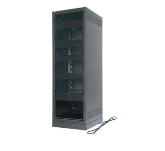

Sorry if this was posted, but what size is your rack? did the door come with the rack, or did you add it after? I am going to install my rack in the back of my theater as well and I really like the idea of being able to lock the door.

The rack is a middle atlantic EGR-2428 Rack. (28 rack slots high, 24" wide on the outside). It did not come with either door. I purchased it from B&H Photo/Video as they had the best price I could find at the time as well as having it in stock. The plexi door I found on ebay for under $100, and the back side has a cable entry door which is made of steel and also lockable EGRRDC24. I also purchased this at B&H.
I had considered the ERK-2725-CONFIG rack, since it comes with everything out of the box. But it would be dimensionally a lot smaller than the hole I had originally made, and I wanted a door. The ERK config rack came with your typical home theater black blank front panels for an open design.
http://customavrack.com/Products/130...25-config.aspx
