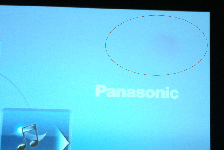

There is a purplish blotch on the upper right corner of my screen. It's pretty annoying when there is a white background. Is this something that will shake out over time (I have 70 or so hours on the projector so far)? Or should I return it under warranty? Not easy to see in the photo, but thought I would include anyway.
post #1328 of 1393
From what I recall, blotches are not a good thing. You may need to return it. You can try running the focus all the way in and out to see if the image gets any sharper or changes size. If not, it sounds like a bad area of the panel or filter/polarizer. May want to ask in the Owners thread.
