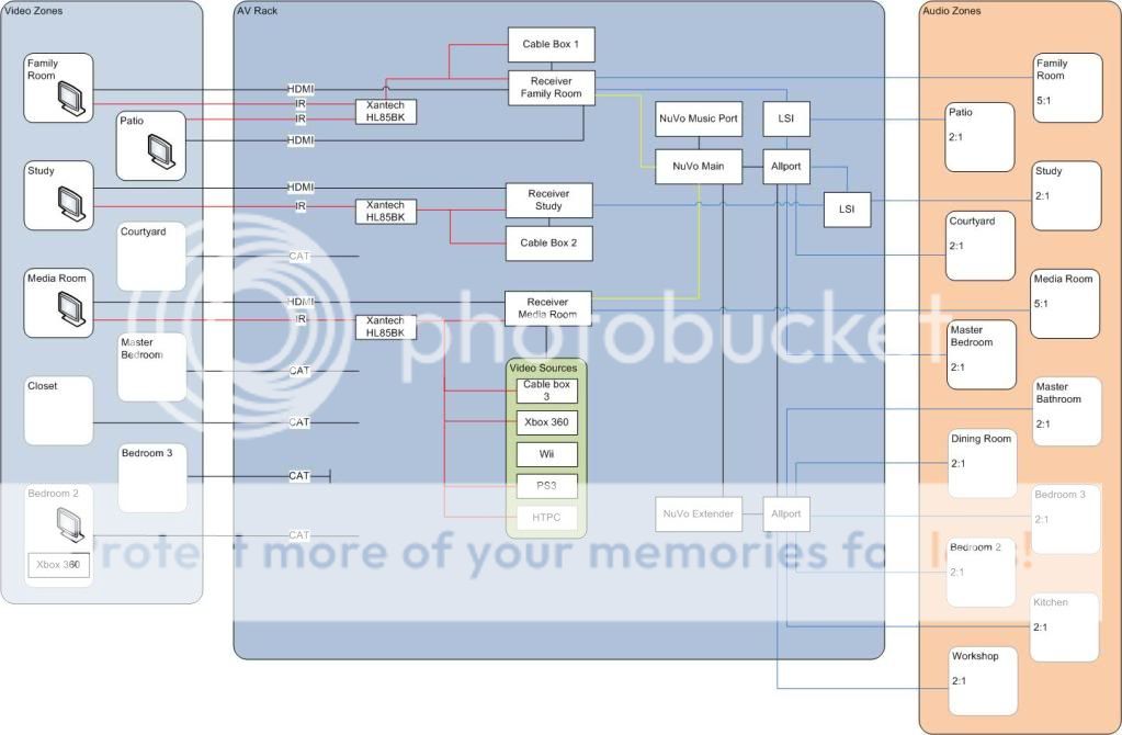

So here is my dillema. This was my plan for the initial build of the house. I will have the provisions in place for a matrix, but at this point I dont think Ill have the funds for it up front. The wife and I agree that the whole home audio is the bigger desire first, and she really likes the Nuvo stuff (Essentia). As of now I still have my receivers handling a second zone of audio each. If I go with the Nuvo system up front those zones will obviously be handled by the Nuvo directly.
The source question was semi cleared up above, so Ill update that at some point soon after I price the music server and look at the budget impact. I will also update the house plans to reflect the 11 zones (the 12th is a standalone workshop). I think Im right on how to handle the 5:1 zones with my amps. The Nuvo will feed it 2 channel audio and the Amp will use 2 speakers when its pumping that audio. I went with LSA40 amplified local interrupts in the two kids bedrooms so they can push their TV audio through the speakers when the Nuvo isnt active. TV audio out is generally line level correct?
My big question is IR control. I know the Nuvo stuff has IR and 232 controls, but there is overlap with my video stuff that wont be tied into the audio anywhere. Can I use the Nuvo for all my IR (and/or 232) distribution or do I need to use some third party IR control and use that to control the Nuvo stuff?

Can you wire two IR receivers together to a single 3.5mm into the block? Im thinking of using the second HDMI out from the AVR to push video to a second zone, but I would need IR control to the same devices from two separate zones. I realize that the second HDMI is slaved to the output of the first, this would be a patio/family room thing where we would likely be watching the same thing (football game) on both.
And if I havent said it enough, thanks for all the help. You (and Neuro, Canuck, and others) have been great at walking me through this stuff.
EDIT: Disregard, I found some Xantech documentation that says you can, up to a maximum of 12 on a single block. I can probably get away with a single block and do everything I need. So the next question is, are IR receivers pretty universal? Will I be able to reuse the receivers in each room with a matrix down the road (generally, I know thats a hard question)?

So I tried to bring everything together into a single diagram, I think Im pretty close.
Red is the IR distribution. Blue is speaker, them running through the Nuvo keypads is understood, I just didnt want to get that detailed in a block diagram. Yellow is the fixed output from the Nuvo running to the AVRs. All the cabling to the video zones is going to be 6x CAT-6 and 2 RG6 with HDMI running through conduit where noted. The Study receiver is a bit of overkill, Im using it to push other sources to that room (plug and play) if the need arises until the matrix is in place. I put the LSI in the study because Im considering making that a 5:1 zone as well. Ill have my computer stuff in there, and there is the possibility that Ill game with that set up from time to time.
The LSI on the patio is because those speakers will not be ceiling mounted, they will likely be some kind of high mounted external speakers in the corners of the patio area projecting horizontally. I think that will work well for both TV and stereo music.
For usage, we are looking at 4 people living in the house; my wife and I, 10 year old son, and 18 year old daughter that is moving out in the next year or two. As stated before, my wife and I arent big TV people. We enjoy movies, and we watch the news, but we dont sit down and watch TV from 5-10 PM. We are serious sports fans though, watch a ton of soccer, college football, hockey, and the NFL. That is mainly a weekend thing though. The kids watch a fair amount of TV, but they are just as likely to play video games all day if they were allowed.
The family room will get the most usage obviously. We will probably do quite a bit of family room / patio stuff during sporting events. We grill a lot (outdoor kitchen) so the ability to keep track of the game going back and forth from the big kitchen to the outdoor one is important. That is why Im running the second monitor out from the family room AVR to the patio. Slaving to the famly room's channel shouldnt be a problem 90% of the time, and shouldnt be critical until we get the matix in down the road.
The whole family enjoys music, I have an Itunes server that will go along with the XM streaming to feed the NuVo stuff. I think that will be enough sources but we will adjust as we get a feel for how we will use it long term. Our TV habits are understood, how we will deal with having music at our fingertips all the time isnt.
Internet access will be plentiful, Im planning on putting in 3 WAPS in strategic locations (Study, Family Room, and Bedroom 2 closet) to ensure there is plenty of good wifi access in any point of the house or patio area. There will be plenty of CAT taps located to adjust that as we figure out usage as well.
Budget will dictate our priorities to some degree. Right now our plan is:
1) Wiring the living crap out of the house to include conduit on any external or soundproofed walls. Then adding some more.
2) Nuvo Essentia and Music Port. Still working out the priorities what 6 zones we consider a priority
3) Ceiling and in wall speakers (paint matching, no place holder plates)
4) Nuvo Extender for the additional 6 zones.
5) TV for the patio
6) CAT matrix and additional TVs.
As of now we think 1-5 will make the initial budget, but we are still early in the build plan. Worst case 1-3 will make the initial cut.
Please review and tell me where I may be going wrong.

Looks like you have your priorities correct!
Note that the LSI (local source interrupt) requires a powered local source, while the LSA (amplifier) takes a line-level variable input. Just wanted to make sure you were clear on that...
If you're doing the LSI/A for TV sound, and the set-tops boxes are located centrally anyway, do what I did and just feed the set-top box audio to the NuVo as a source. I use TV audio via NuVo every morning to listen to the news while getting ready for work... And gets used in many rooms for sporting events.
Don't buy those additional wireless access points until you've checked the coverage once you move in. I suspect you won't need them, or perhaps only one to cover your patio area.
Jef
post #88 of 105
Jef
I like that idea better. Some of that could be a pita before the matrix is installed (like getting a TV to the right channel to listen to the news through the NuVo from the bedroom in the morning) but for the patio audio its a great workaround.
The speaker wire is coming from the AVR, so that means its powered correct? I thought the LSI was essentially a relay flicking between the two different speaker wire "sources"?
post #89 of 105
No, it's pretty easy. Three choices, assuming the source is the set-top box, located in the closet with the NuVo:
a) TV remote to the IR repeater in the bedroom, change channels, even without the TV on.
b) TV remote to the NuVo keypad, with IR emitter also in front of the set-top box
c) "Learned IR" codes for the 'favorite' channels into the NuVo system, select favorite channel from NuVo menu, IR emitter on set-top box changes channel.
Yes, sorry, I was thinking TV sound coming from the TV, not the AVR. Yes, it's a relay, you'll have to do some extra cabling bits to intercept the speaker wire in the closet after it leaves the AllPort. And a cat5 cable from the LSI to the keypad in that zone. You're effectively running a remote-local-source
Jeff
