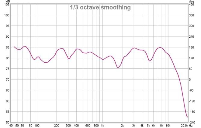

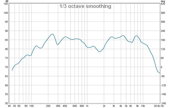

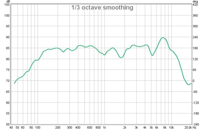

OK, I went home for lunch to EQ the front 3 channels at the speakers(3 feet) and sub but I ran out of time for the subs(moved them slightly). I never got a chance to listen to them yet but here they are.
Front right speaker(DR-200 and 30 inch wide T-39)
Center speaker(DR-200 and 20 inch wide T-39) Disregard the output below 100hz as I had the subs on for that one(sharing same amp)
Left front main(Dr-200 and 30 inch wide T-39)

Yes, I still need to get a long xlr cable to connect to the behringer mic. I ran the sweep from 40hz to 20khz and it was strong all the way. The highs are very extended. I am running a 80hz XO to my subs so there is a rolloff starting at 100hz until I add the subs as you can see with the center channel response which uses the same amp as the subs. I didn't bother to unplug the interconnects. I will go home and listen to this and take a LP response now. I am curious how flat they will be after 10 more feet. EQing is a breeze now and it takes me about 5 minutes to manually input about 10 filters. Next up are the subs to make sure they are still flat. I am using a 1/3 smoothed response because I read that is how we hear. Otherwise the higher in frequency you go it becomes a mess.
