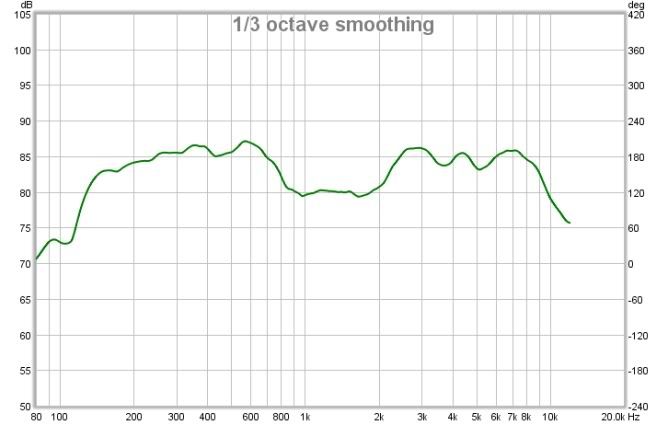

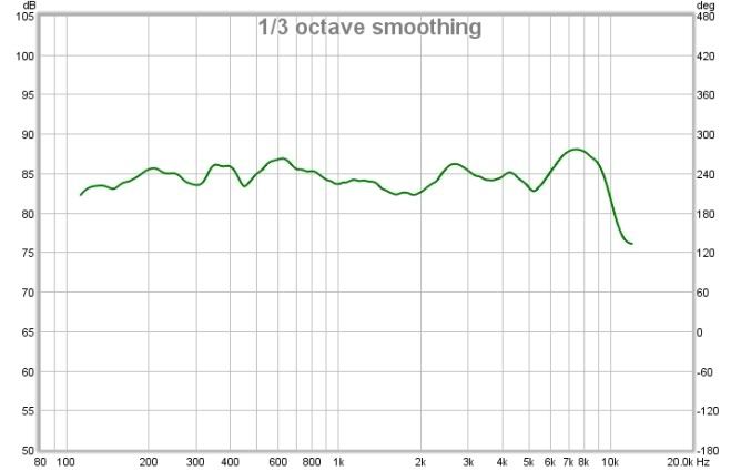

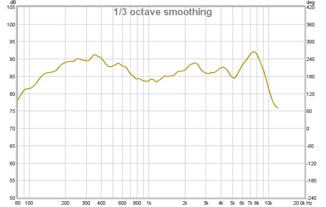

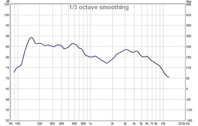

OK, I am learning to use this new processor with it's PEQ so I think the response of the no eq has some. I will post another no EQ on the right DR again. Here is what I have now when listening to the DR's.
Right DR with no EQ(I think it was on and used some of the lefts EQ, not sure)
Right DR with EQ
Left DR with no EQ
Left DR with EQ
Response while listening in stereo with no EQ
Stereo response with EQ(just letting the 2 EQ'd speakers run together)
I listened to the DR's again and now they sound like a different speaker. The sound now wraps around you. There is more energy and the roughness is like the M&K's, not quite smooth as the Triads. They are very clear and can play as loud as you can stand. They kind of remind me of the JBL's and M&K's combined. I still have to rerun the M&K's and Triads and still get others opinions. So far I am the only person who has heard the DR's setup like this. I ran Tron Legacy in DTs-HD without a center and for those who don't use one you should, it makes a big difference. However, the DR's pulled it off good enough and was very clear. Wait until I post the response from my subs after EQ, I EQ'd it to have a house curve at 15-22hz but 10-15 and 30-80 is flat with each other.
The DR's are proving to be a worthy opponent. Still not broken in all the way but I don't know if I believe in long break in as I think we can loosen up the drivers in 4-5 demos and with me running all these sine waves for EQ it breaks them in as well. I wish one of my friends can come over to help, it would speed things up. I have a feeling I will go with 3 DR's up front and would get 7 but they are too big for my room as surrounds. I will wait to see which speaker will go back there. Maybe the 5000's or one of the new ones coming.
post #86 of 1136

post #88 of 1136
They're not extending to 12kHz. Looks like they're down well over 10dB at that point.
MK, are you ok with that? I know the ears should be the final arbiter, but it seems there's got to be an audible impact with essentially no effective output above 10-11K
post #89 of 1136
This is an EQ'd FR of the SHO-10 at 0 and 25 deg off-axis at the MLP and at approx. 1M. The room influence is clear at the MLP, but the roll-off is beyond 12kHz in both measurements.
I have no idea if flat to 12 Khz matters, but I've always been under the impression it would.
post #90 of 1136
