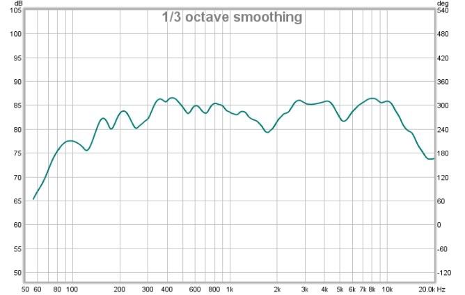

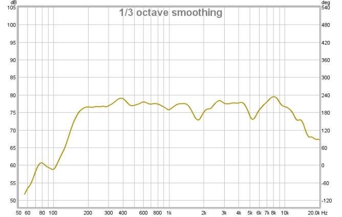

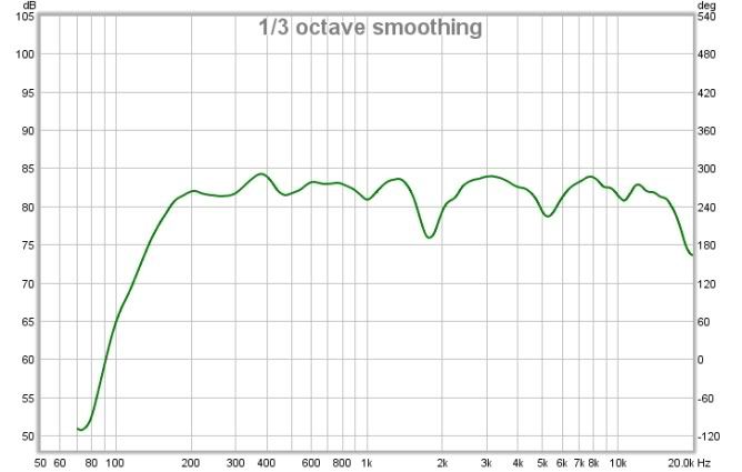

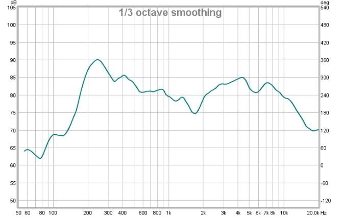

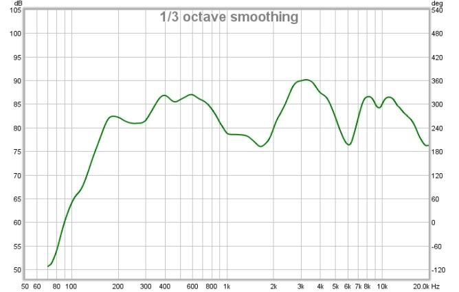

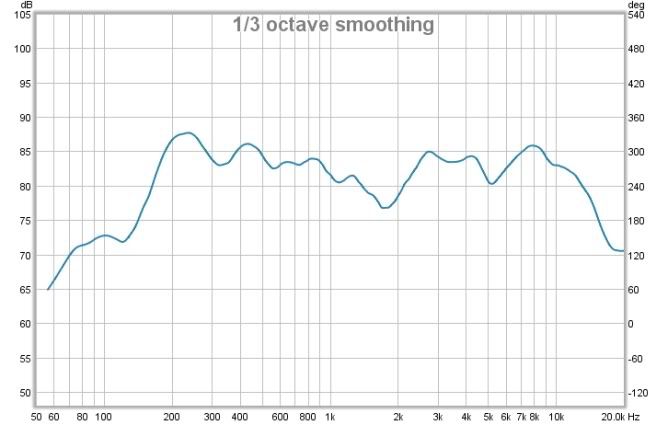

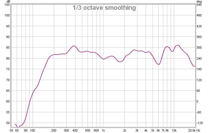

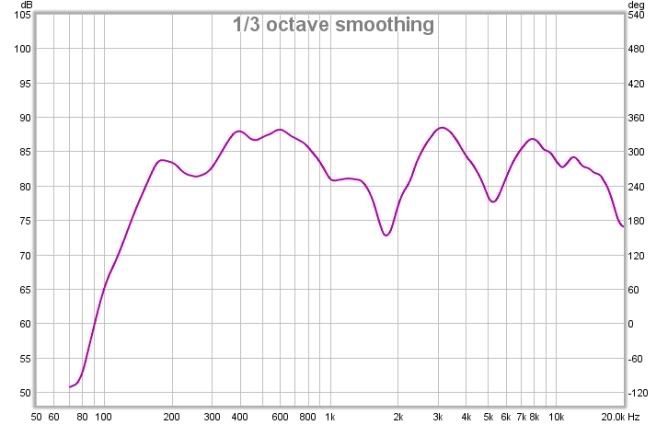

I measured the DR-200's last night, mine have just high pass and low pass filters so they will be peaky in the response. I have them aiming at the LP(downward a little) and the left and right and toed in only about 10 degrees or so. I treated my room so that I wanted to hear the speakers and not the room but I still get some room interactions. I have always put in speakers without EQ and they always sound awesome! For example, M&K S-5000's, Triads, eD cinema 12's, JTR triple 8's, JBL's cinema, you name it. They have always sound excellent without any tweaking whatsoever and the DR's sound aweful without tweaking and I figured the reason was the crossover! All those speakers have crossovers so they are flat at 1 meter and when placed in my room they all have a similar response which is my room which sounds great! The DR's don't have a crossover and at 1 meter they are far from flat. Now if I was sitting in one sweet spot I would just EQ all the speakers to that one spot and call it a day however I have 7 seats and again all the seats sound really good with the other speakers with crossovers. So my thinking was to EQ the DR's at 1 meter and let the room do the same thing to them as the other speakers. I also EQ's the DR's at the seat to hear the difference and there was a difference. I can tell you to experiment and do whatever sounds best but in my room EQing them at 1 meter(each speaker was EQ'd to 1 meter) has a better sound to the room than eqing to that one spot at the LP, especially when you moved from seat to seat. Now what I did was run a sweep on each DR-200 and then let the REW EQ function set the filters for me with the DCX in place. I used 1/3 smoothing so I can see a line which without smoothing is it more like a seisometer! It is very simple, Here are the graphs. Keep in mind they are behind my screen as I wanted to EQ them how I will use them.
First here is the 1 meter response with no EQ(raw) on my left channel
Here it is EQ'd using DCX and REW(8 filters)
Here is the right channel raw at 1 meter
Right channel 1 meter EQ'd
Here is the center channel 1 meter RAW
Here is the center EQ'd 1 meter
I then used the center channel and measured what happened at the LP at 0 degrees.
Center at LP without changing EQ from 1 meter
As you can see my room does a pretty good job at keeping it tamed!
Now I measured to the far right seat about 30-40 degrees(estimated)
And finally the far left seat
You can see how the off axis response changes but overall not that bad from 14 feet away all using the center. So you can see what people are hearing from seat to seat and like I said, crystal clear and very dynamic! So I played Immortals and some music to compare this EQ to my MCAAC and I hate to say this but the Ada with the DCX sounds much better! I am also flatter at the LP than what MCAAC did and the mic was at the LP with MCAAC and I EQ'd with the DCX at 1 meter and still was flatter at the seats! The sound is just smoother and more audible. I once again can play at reference levels without any strain where the Elite was too loud at reference and hurt my ears so I turned it down anywhere from -5 to -10MV depending on the movie. With the Ada gear I set at 0 MV for any movie! Music was the biggest difference as it was more palpable like it was before! I am sorry guys but I will stick with used high end(ada at least) than brand new AVR's. The elite came the closest but I have not found one AVR so far that can play reference without sound too loud for some reason and you guys read it all the time and say how can you watch at reference, it is way too loud! Not on my Ada gear!

I understand, but I try to get a flat response at the LP and the elite was +/- 5 dBs. It still could not play reference without being too loud. I don't think it is the response, it has to be how they calibrate with their test tones, or something else.

But why would you want it to measure flat at the LP?

What other response would I want? The Elite does have the ability to tweak the bands if I wish. Trust me, I still like the elite, it was my favorite so far out of Denon and marantz but they were older models before the audyssey XT32 which I have not tried. I know I like Integra as well from a long time ago before HDMI. All I know is that it sounds amazingly good right now, there are things I can hear or understand I could not before(immortals) but I am still in the testing phase. Music was more palpable which means that I could feel it on my body more(not the subs). Maybe Ada does Reference differently I don't know because I have had people over before and thought it was lower than reference which is was not. I have also measured peaks from the same scenes and they are the same so why does one sound much louder? Who knows but I just turned it down a bit with the Elite.

I would use this slope:
Its recommended in most studies. I've tried both flat and the target above, and prefers the tiltet response too. (I roll of a little steeper though, because the JBL Pro drivers are better this way.).
If I were you, I would try to correct the speakers using the DCX and then do a A/B test with the ADA and the Pioneer where the Pioneers EQ has been turned off. Then you would actually compare the two processors without multiple variables.

Thanks for the graphs, MK! Could you show me 1/6th and 1/12th smoothing on one of the graphs? The hole at 1800Hz is to be expected due to no delay compensation between woofer and piezos, as well as piezo and woofer rolloff. The off axis behavior is a little better than expected; the drawback to the design is that horizontal polars bloom once the piezos take over, and narrow in the upper range of the woofer horn. In your room, though, with limited off axis angles and lots of absorptive treatment, the uneven polar response is masked well. Vertical polars are handled easily by both absorption and careful aiming.

Thanks for the graphs, MK! Could you show me 1/6th and 1/12th smoothing on one of the graphs? The hole at 1800Hz is to be expected due to no delay compensation between woofer and piezos. The off axis behavior is a little better than expected; the drawback to the design is that horizontal polars bloom once the piezos take over, and narrow in the upper range of the woofer horn. In your room, though, with limited off axis angles and lots of absorptive treatment, the uneven polar response is masked well. Vertical polars are handled easily by both absorption and careful aiming.
The big plus to this design is the headroom. It's sensitivity is very impressive. I wonder what voltage you were using during those sweeps. I bet less than 1/2V.
JSS
I had my processor at -30MV when I did those sweeps and the gain on the DCX for each input was -10MV and the outputs were 0. The Ada amp does not have gain controls. To calibrate to reference I had to turn up the input gains about 4 dBs per speaker. I think I saved the graphs this time so I will see what can do. My JBL's rolled off the top like you guys suggest but I prefer the extended flat response and it does not sound too loud or harsh at all at reference.
