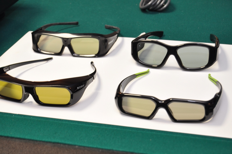

thanks to your post, I decided to dig deeper with the Xpand 103's and my Monster Vision 3D RF glasses.
Here is some findings that are going to be a little shocking... I found settings within the MV3D transmitter that almost completely eliminated ANY signs of ghosting, even during the most difficult scenes. I don't know how I missed this the first time I tried it a few weeks ago.
Here is some info:
1. Expand 103's - cycled through the various modes to get it to sync with the HW30. I believe it's #4 on the cycle (it's the only one that will sync as far as I can tell). This causes 5-10 second flashing. If I lower the 'glasses brightness' in the HW30 menu, it will be rock solid and offer identical performance as the Sony's, WITHOUT the bizarre effect of the polarizers creating ghosting while moving your head around. The tint of the 103's isn't my favorite, but it's certainly not a deal breaker.
2. Monster Vision 3D - I have the RF transmitter powered by a blackberry charger. I am using the IR receiver that comes with it and keep it close to the Sony emitter. Perfect 5 bars of sync signal. After going through some of the timing adjustments randomly, I found one that reduces the ghosting by a substantial amount as you can see in the photos below. The best part is, now that it's RF, I don't have to fuss with the Sony emitter if I choose to use the RF glasses.
Photos: 1st is no glasses, 2nd is the Sonys, 3rd is the Xpand 103's and 4th is the Monster Vision 3D. Notice the sign, the ghosting is almost completely imperceivable in the photo and is invisible to my eyes when A-B between the Sony, Xpand and MV3D's.
I also find the MV3D's the most comfortable since I wear prescription glasses. They are larger and don't have the curved arms.
no glasses - look at the sign and the light behind his left ear.
Sony
Xpand 103
Monster Vision 3D
no glasses - look at the sign and the light behind his left ear....
WOW the MV3D really do a great job of reducing x-talk. They also seem to preserve the color balance much better than the Expands. Did you get the ethernet pin assignment to wire them? I may have to look at getting them.
Subjective question; Do you feel the color balance, brightness and 3D effect of the MV3D's as good or better than the Sony's?

I didn't get the ethernet pinouts yet... I originally assumed it wasn't going to work with the IR since it didn't work with the JVC IR emitter. It works just fine with the Sony which is good news.
The MV3D's have a unique cooler colored tint than the other glasses, although the Sony (when activated) looks closer to the MV3D tint color than the yellowish/green Xpand103's (which stay that color when the shutters are activated).
I have to spend more time before deciding which glasses are all around best, it was 4am when I discovered the setting that looks as good as it does. Since I can have all 3 glasses (Sony/Xpand/MV3D) running at the same time, I'll go through more of the tough ghosting scenes to see how the MV3D in this particular setting works and let you guys know.
