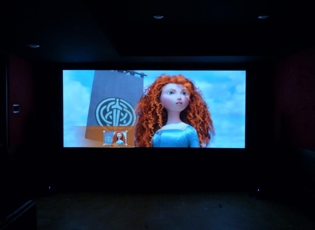

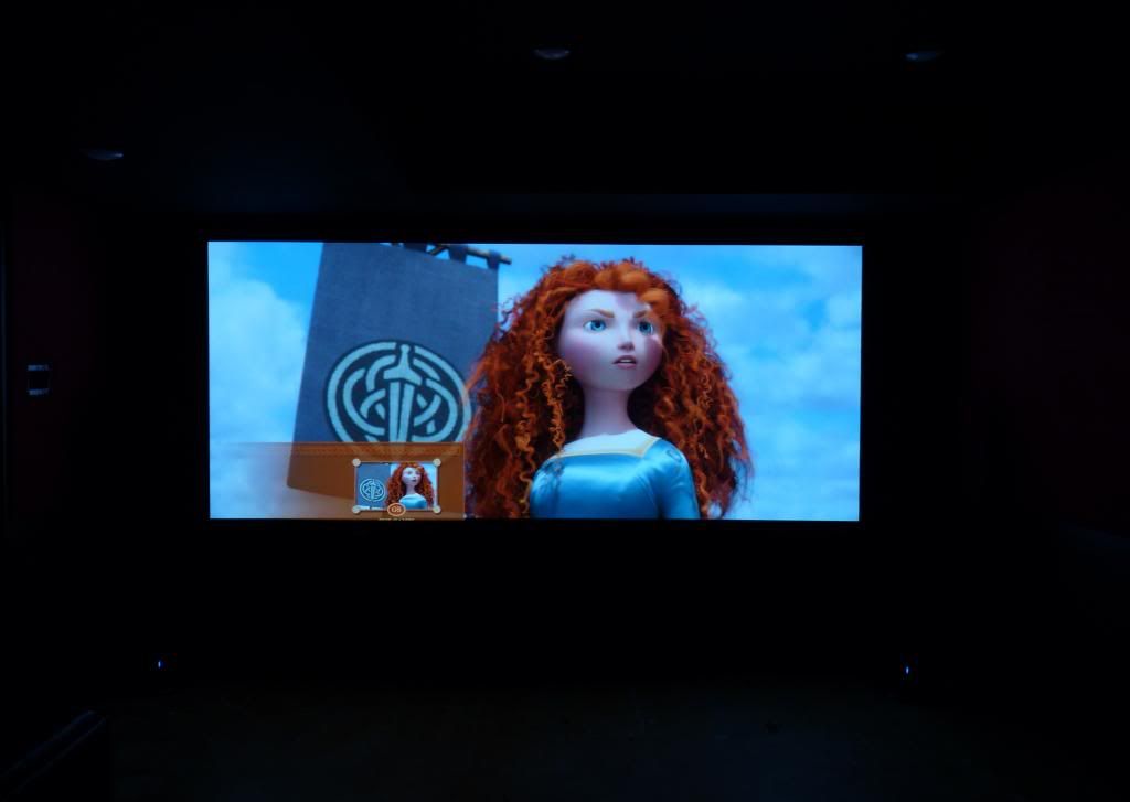

Borrowed my neighbor's tripod for some better shots.

Spent a good part of the evening putting the screen frame up and I have to say I am not happy with the French cleats I bought. Perhaps its the screen track on the back but there is very little metal overlap. I used 3 of these:
And I just don’t see how I’m going to be able to get the screen centered and all three cleats on and level once the spandex is wrapped. Think I paid $10-$20 each for those things too. I even bent the cleats out a bit and it didn’t help much.
So now I either need to toss those and just take some wood and make my own cleat or attempt to hang it with 2-3 people and then if that doesn’t work make my own.

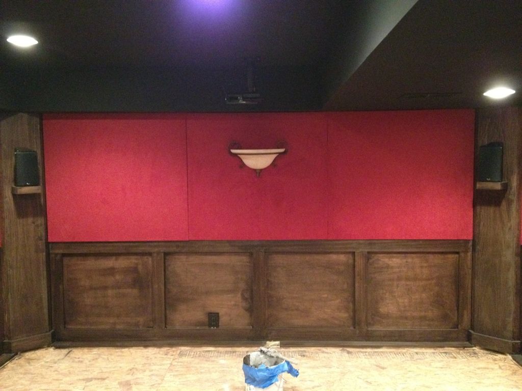

Screen wall trim and center channel stand are done.

Screen frame is wrapped and hung and projector is mounted. Don't worry electrical isn't done yet so progress will continue.
I must not have drilled one of my pilot holes enough as I sheared off a lag screw. I also forgot to put washers on but it's solid. I will need to buy a metal bit to drill out the bolt; any reccomedations?
First layer of the screen is silver matte spandex second is white matte. Perhaps I should say silver is inner and white is outer.
The chief mount and hardware isn't cheap but it's worth it in opinion, very good quality.
