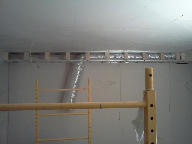

I worked on the soffits over the weekend, got the HVAC registers hooked up and the plywood skins on the soffits. Also got to work on the curved front soffit, using a technique from Jesto's thread:
3 separate pieces of 1/4" drywall, glued and clamped to form the curve.

I took a couple pictures while it was clamped. Each layer was glued to the next, now I understand why it takes several layers. The first layer was not very curved, the second layer was more curved but still had some straight edges, by the third layer it was a smooth curve the entire length of the soffit.
Yesterday I got the final plywood hung underneath the curve, and cut in the four 3" holes for the can lights. Tonight I'll start the final layer of greenglue and drywall on the soffits, when that is done it will be time for mudding and taping!
