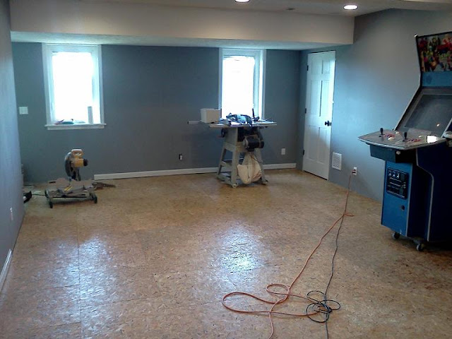

My wifes baby shower is being held in the basement this Sunday so I am cleaning things up and snapped a few updated photos. Work on the theater room will start back up next weekend. This weekend is crazy busy, the brewing club is doing the annual "Big Brew" and we are going to have 85 gallons total this year.
