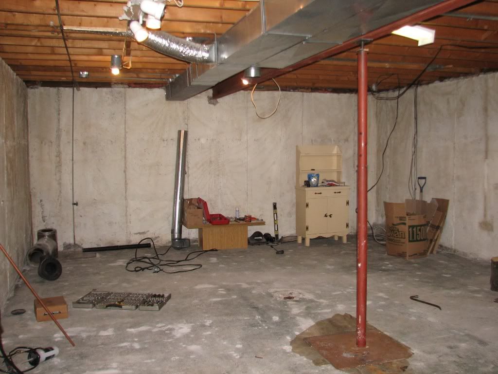

Hello all,
Going to re-do my HT in the basement for the 2nd time.
I will start in about a month from now.
I've had a HT Room for about 15 years and this time I want it done right.
I started with a 32 inch TV to my now 4th projector in the 15 years.
My priority no.1 is Soundproofing the room to the rest of the house.
I want my sound to stay in the HT room.
I have been reading for a little over a year now and "think" I am ready.
Man, there are so many beautiful HT rooms here that I'm totally inspired!
So here it is:
Room size stripped is 17'8"L x 15'1"W x 7'8"H.
Option 1:
2x4 all around (3 walls are foundation walls) 1" of the foundation wall.
Insulation (Pink unfaced), vapor barrier, RSIC-1 clips and DD with GG in-between. (Is this OK?)
For ceiling: RSIC-1 clips and DD with GG in-between.
Option 2:
Closed cell spray foam 2" on the 3 foundation walls, 2x4, Insulation (Pink unfaced), RSIC-1 clips and DD with GG in-between. (Is this OK?)
Thanks in advance for any guidance and help offered.
Here's a picture of my room stripped.
post #2 of 71
Great that you're asking before you get too far.
Option #1 is close. I'd start with that. All you need to do is eliminate the clips fom the walls. They are already decoupled. Use R19 fiberglass in ceiling, R13 in walls.
Consider the big holes now. Ventilation and doors
Side note: foam is not our acoustical friend in this case. Avoid foam and use fiberglass.

Thank you all in advance for your responses. I appreciate your feedback greatly.
Ted, I'll need to order some RSIC-1's and some green glue and have no idea how much I need and where to get it. Please help!
Also thank you soo much for your response. I know you're very knowledgeable.
Question?
Can I not put 2" spray foam from foundation to 2x4 then put R13 insulation and so on?
Is this a bad idea?
Shawn,
You're completely right, I'm ready but not quite.
I wish I can put a layout but don't know how to draw one up for attachment.
I have a pretty good idea of what I'm going to do as a layout and by that I mean,
Where the chairs, speakers, screen, front stage, back stage, lights, plugs, soffit, doors, ventilation are going to be. I have been collecting lots of pictures (from here) and am ready to tackle this project.
J_P_A, Yes I am also concerned about water intrusion.
No I have no ideas how the outside wall is made.
Here's what I know...house is 52 years old. been living in it for 20 years. Never had water leakage. After striping everything, the basement is super dry. Wall was covered with a plastic sheet, no insulation and then sheetrock. Never had a problem with humidity downstairs.
Then Irene came along and not a drop of humidity anywhere. We got 4 inches of rain here.
I know I have alot of work to do and can't wait to start.
I'm just worried about doing it right the first time.
I hope I've answered your questions and hope I can continue to get help cause I need it.

That house is 52 years old? I ask because that looks like a poured concrete basement with Steel I-beam. 50 years ago I think they were still using concrete block foundations and built up dimensional lumber beams. If it's the typical concrete pour then it likely has the black tar stuff on the outside and thats it....In your case though it's not a concern as you have already stated that it's been dry for many years.
p.s that support post, is it on a steel plate? if so it may be that way because it was added later and is not on a proper footing.....

post #12 of 71
Hello Chris,
My house was built in 1959 and it's poured concrete 10" thick.
The support post you see, I moved it and placed a 24"x24" 3/8 thick plate at bottom of support post. I moved it from the 12' location to the 15' location of the foundation wall.
An architect approved.
It's a bungalow with a living room upstairs.
