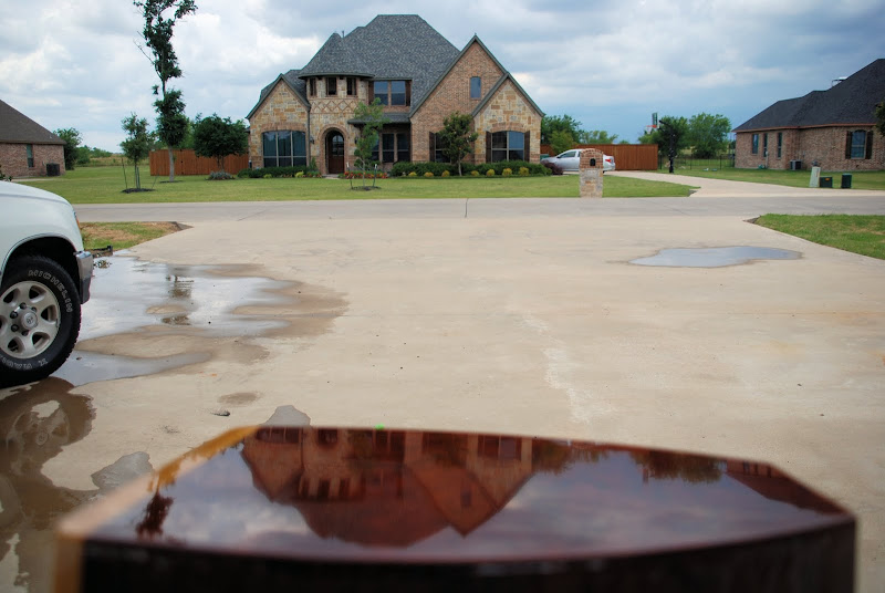

I polished the bottom before I thought to grab the camera, that's why you see some gravity-defying runs in this shot.
I began by dry-sanding with P-400.
Then I used Rubbing Compound.
Then Polish.
The photos came out better than I hoped, considering it is very overcast today.
I machine-applied wax, then hand buffed it.

damn, that's a beautiful finish
post #205 of 352
Looking good!!
post #206 of 352
Damn... Even though it goes without saying, I'm going to say it anyway: Beautiful job! You're obviously very skilled and have done a fantastic job on everything. I also love your attitude toward helping all the rest of us who may not have the skills or knowledge for these things.
The post that demonstrates this:
Originally Posted by PassingInterest View Post
... I'm actually glad this happened, because it gives me a chance to demonstrate a solution, which might be useful to others, should this ever happen to anyone else.
Awesome. Good on you for such a great attitude, and keep up the good work!

Thanks, guys!
Ezcl--Thanks, man. I'm happy to help bring others up to speed.
TC--Rubbing Compound and Polishing Compound are like liquid sandpaper, with Rubbing Compound being the coarser of the two at about 1200 grit or so, roughly. There are actually many grades of coarseness. An Automotive Finishing Pro like jstslamd could give you a better rundown of the different compounds than I could. Oh, and there are some that break down as you use them, becoming more fine as you go.
I meant to get some shots of the cabs after I finished polishing them, but the sky opened up and dumped a bunch of rain as I finished waxing them. So, more photos will follow later. My indoors photography skills are not very good.
