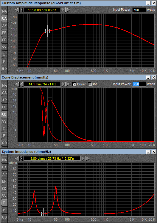

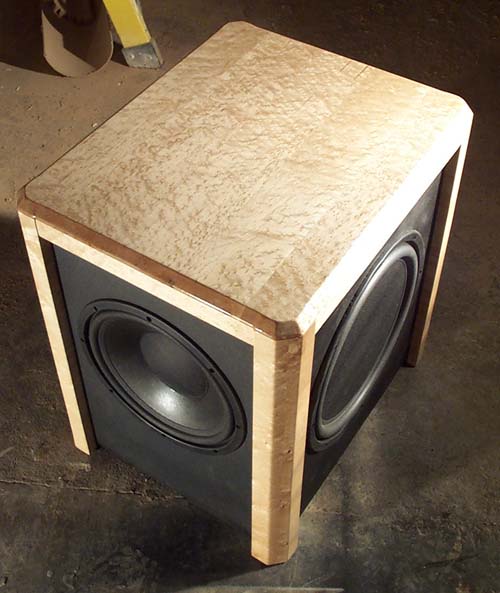

What determines the difference between a midwoofer and a woofer? It's all about having enough displacement to get the output you want. You may want to spend $1500 on a single woofer and apply 3000W to it if enclosure volume is a big issue. If you can get away with larger enclosures you could go and buy 2 or 3 woofers with less excursion that would give equal or more output. You would spend much less money and with much less power needed your overall distortion is significantly lower. It's really just about picking what is best for the application.
Some of the best subwoofers I have ever done use the TD woofers. Playing the lowest frequencies is really the easiest part as it's all about moving enough air. Where most subwoofers greatly lack is in the upper end due to high inductance and distortion. This is where the TD woofers excel. The largest recording studio in chicago uses a subwoofer with a pair of TD15H's. It's a vented enclosure tuned to 15Hz and will easily reach 120dB at 15Hz in the room. The hiphop guys love it. Another studio locally here that Mark Seaton and I worked on uses 4 SPB15's (same VC, cone, surround as the TD15) in sealed enclosures. These 4 woofers will reach nearly 120dB at 10hz in the studio and flex the sliding glass doors enough that you would think they are passive radiators moving.
A single TD15H in a 28" external cube with 1.5" thick walls (8.8cf internal) tuned about 17hz will reach 111.7dB at 17hz. The interesting part is that it does this with only 450W. The single 15" woofer and pair of 15" PR's works extremely well for this. If you build 2 and double the power, you're adding 6dB more. Then factor in any gain from your room.
For a music only subwoofer, the original Lambda GOT12 was and is the best I have ever heard. It doesn't play to 15-18hz but it is extremely efficient and detailed and reaches to around 22hz. 3 cubic foot with a TD12H and pair of 15" PR's with 1400grams each. It has a gentle sloped off response that works great with room gain to not be overbearing. Here is an example of the one I had for myself with a dustcapped woofer at the time.
The only limit is displacement. However with 14mm Xmax, the TD woofers still move quite a bit of air. The only ones for midbass use only are the TDM's. With 6mm Xmax they won't let you get very low.
John
John, thanks for pointing out that the TD drivers can go low. I know my TD12S woofers had very good performance down low.
Can you comment any differences between the AV15X vs TD15H in a PR design tuned to 17Hz.
Also, can we have that dust cap instead of the phase plug???
