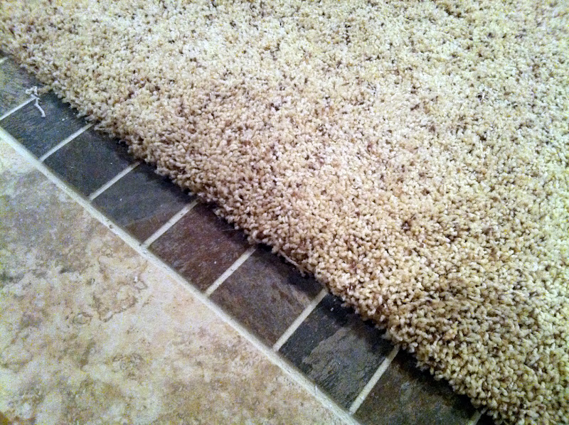

Some progress.
Carpet went in today. Sorry for the cr@p photos
Detail against tile.
Also repainted (for the second time) the Jr. Mancave, and installed the soft tile floor.
I wish real tile was this quick and easy. As a bonus the tile doubles as knee pads.
SEATS TOMORROW!!!
