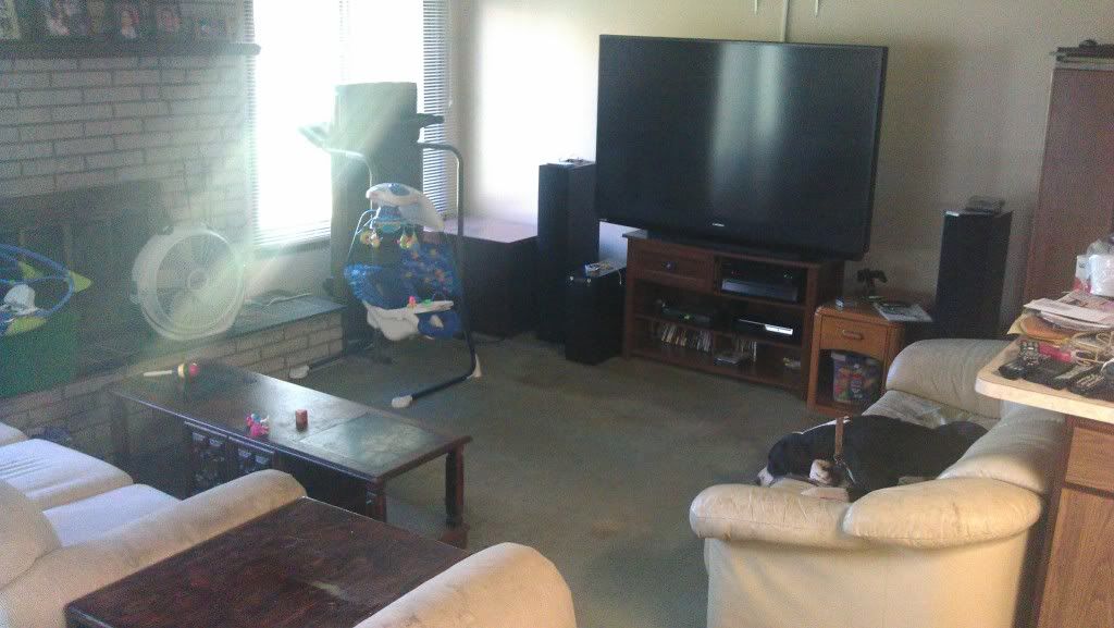

Ok these are all takin today with my phone, and mobile photobucket was being a pain but I got it to upload.
First off from the LP
As you can see the center is mounted high above the tv, but I have it angled down into the listening area, so it's not intolerable.
This is a shot from the kitchen area looking into the living room.
You can see the second of the subwoofer cabinets in that shot, directly in between the main lp, and the chair.
He is a shot of the surrounds.
The left/right surrounds are mounted high but again angling into the lp, where as the rear surrounds are about ear level.
And one more without the grills cause some people like that look..

I'd suggest a phantom center with 3π or 4π for left and right. Can you move the book case?
Don't move the dog. He (she) looks really comfortable.

I can, but then I would have to relocate the ep4000, It's on top.. lol..
post #35 of 58
I tried several different placements and toe ins to try the phantom center and the stage was always a little finicky. for my MLP it was perfect for the most part, but anywhere else, it was just too far off. maybe I just didnt find that perfect toe in. There was also a slight amount of compression that I could catch every now and again in the L/R having to do the vocals along with their dedicated content.
