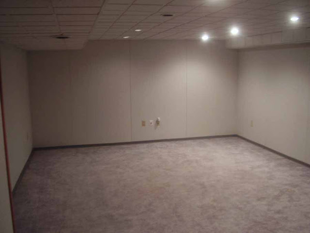

The room at the start:
Instead of ripping down the paneling, I just put about two or three layers of joint compound over the whole thing and sanded it down. It was labor intensive, but pretty cheap. Here I am with my little helper:
