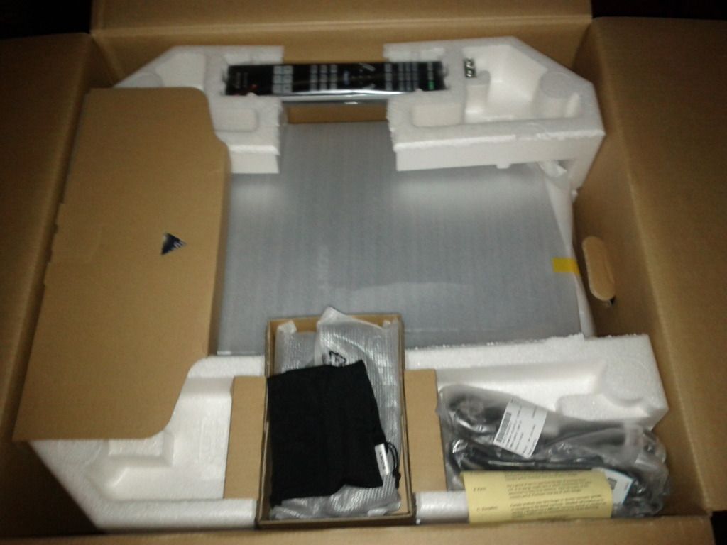

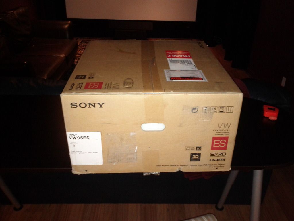

Ok, just finishing installing my new Sony 95. The first impression is really good but I will have to do more test before making any comments and comparison with my last projector the Sony HW30 and before that the JVC RS40. I choose the Sony 95 in hope to combine the best of the two.
I am no expert but if you have specifics questions, I will do my best to help you.
Should post my first impression on sunday night.
