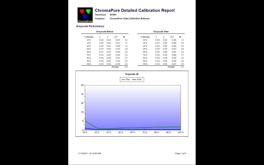

I plan on getting dE of 1 or less once done calibrating.

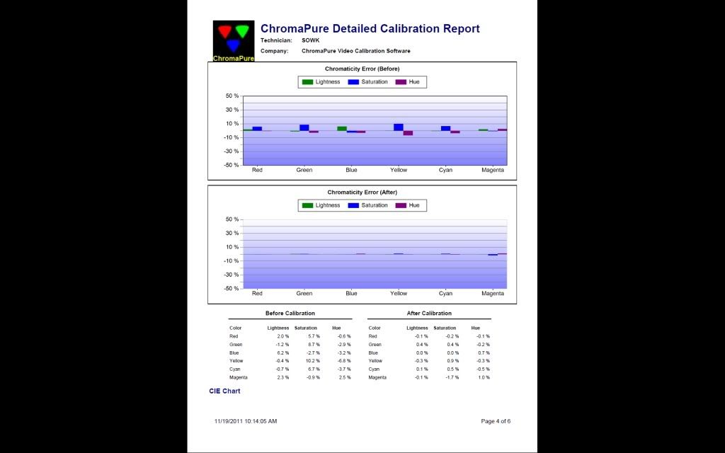

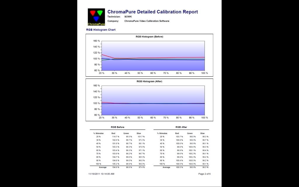

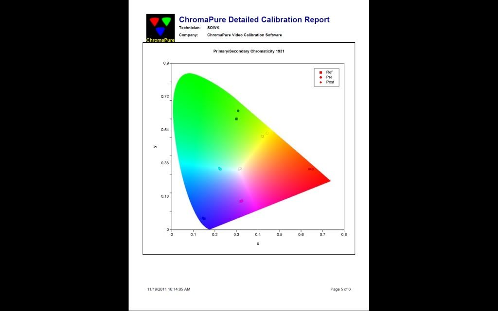

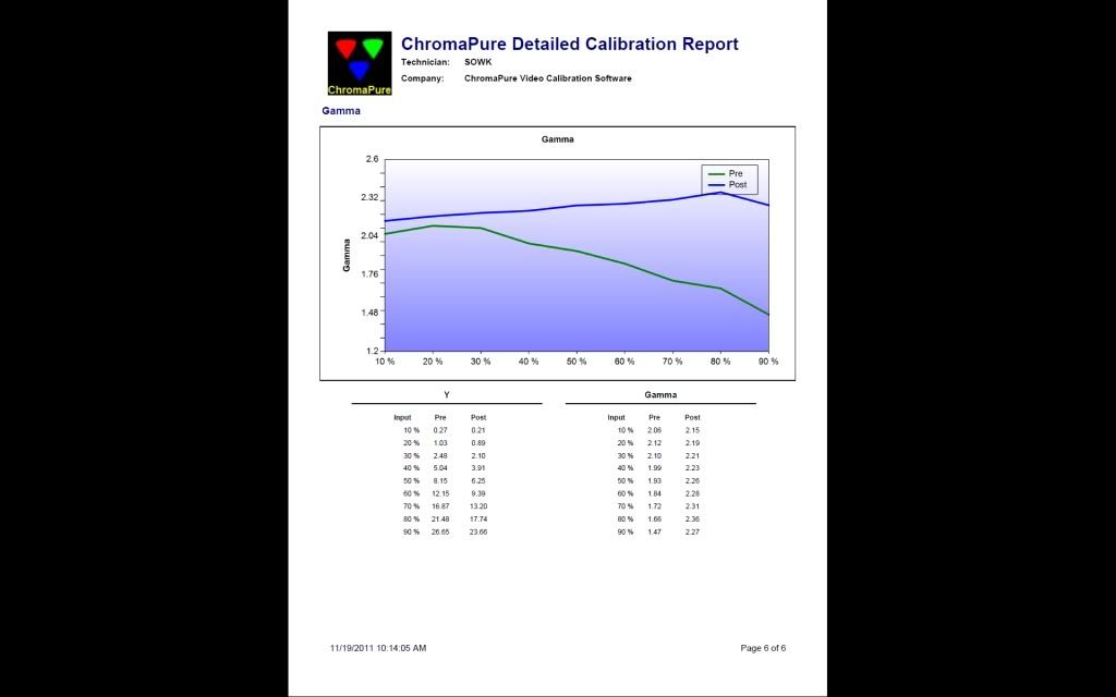

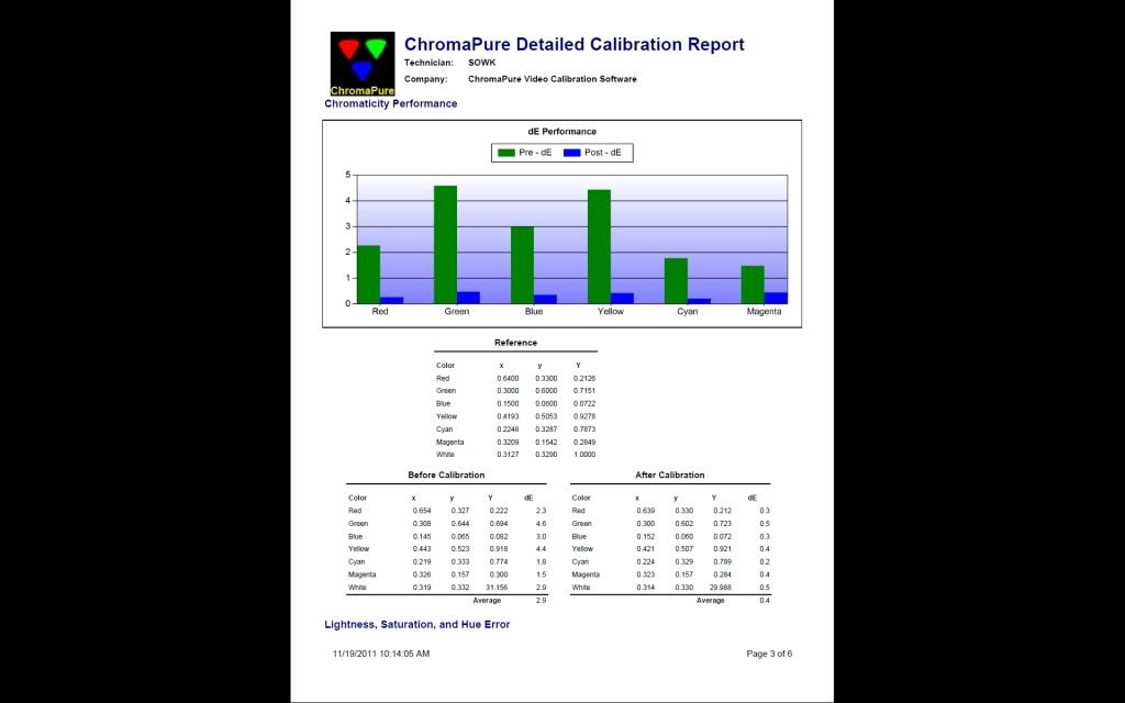

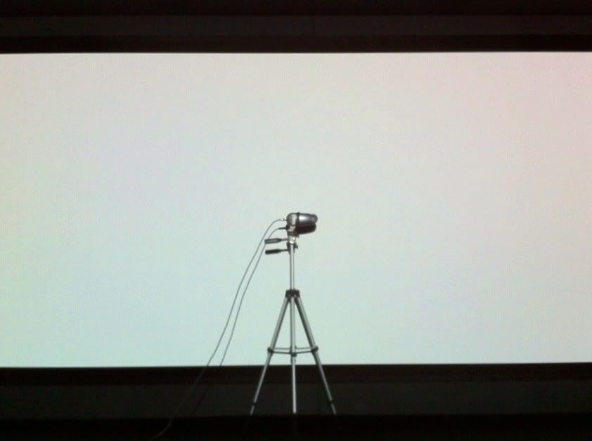

SOWK's Sony VPL-VW95ES 2D Review
Reviewers Setup:
http://i1224.photobucket.com/albums/...y/1e82fb69.jpg
Room: Fully Light Controlled / No Windows / All black/dary grey within 14 feet from the screen
Screen Size: Seymour AV Center Stage XD 163" 2.35:1 150" Width X 64" Height - *This is equivalent to a 172" 1.78:1 as I am only using the zoom method
Throw: 21.5 feet

Color - REC 709: 9
Positive: Very accurate out of the box in Normal color space mode.
Negative: RCP is not accurate/linear enough to use to correct all saturation levels.

Calibration report...
During calibration:
Focus:
Looks even better in person and focus is even from edge to edge.
Couple of things I would like to say...
- It is very very good in cinema 1 preset out of the box. By far the best projector I have ever tested calibration wise. If I would have had gamma set to off and sharpness to off, you would not need a pro calibrator if you have a color neutral screen
- After calibration it is extremely close to reference and you would not need a external video processor.
- All results in report above are with dynamic iris "ON".
- Gamma was a little flatter to 2.22 with the dynamic iris off.
post #1009 of 3430
Wow, pretty amzing post cal results there SOWK. The only issue I'd have is that bump in the gamma at 90. I wonder if the main contrast is set a fractioin too high or whether it's just a quirk of the auto iris perhaps. It's the sort of bump that the Lumagen Mini3D would easily be able to manually adjust out, but IIRC you're just using the '95's controls?
post #1010 of 3430
How did you managed the color!? Wide2 ? Which values do you used in the CMS?
post #1011 of 3430
Normal with RCP in user 1, adjusted only the color/hue/lightness settings. Did not touch range or scale settings.
post #1012 of 3430
it was at 80, and a dynamic iris will always affect gamma, but I will tell you it is certainly worth the trade off for the massive increase of on/off. Plus I'm sure there is no way to tell during actual material. Or even test patterns for that matter. This is some of the best DI gamma results I have ever seen btw.
All settings were done directly in the Sony, no external processors.
*Note - Gamma is flatter with DI off.*
Results below...
post #1013 of 3430
Thanks for the further feedback SOWK. For internal controls only that's even more impressive...I already have the Mini3D so maybe when the time comes I might not need it.
post #1014 of 3430
