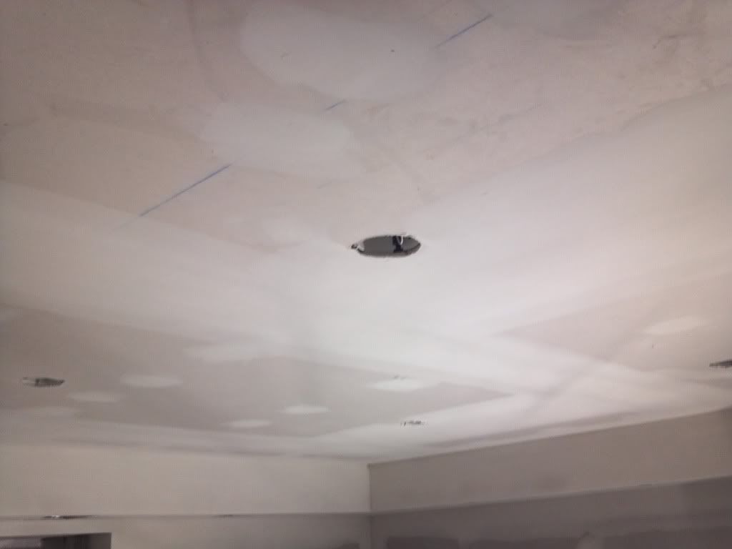

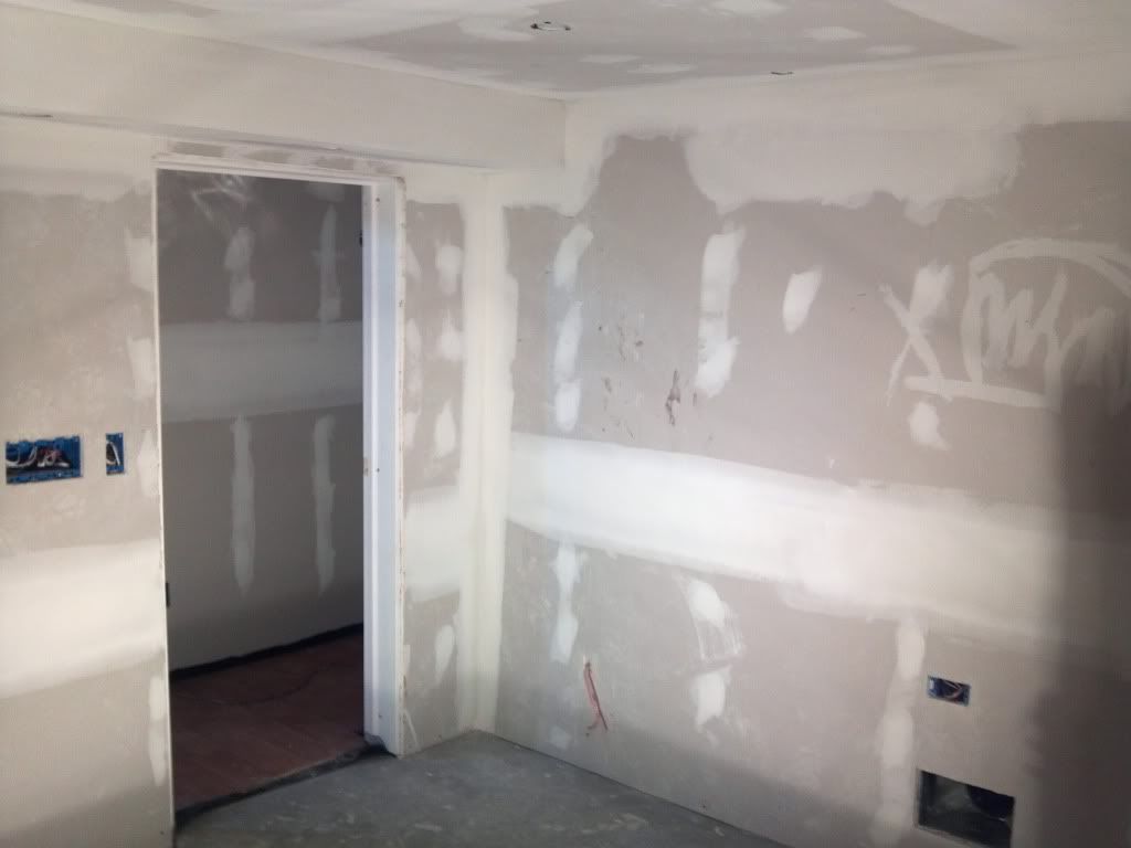

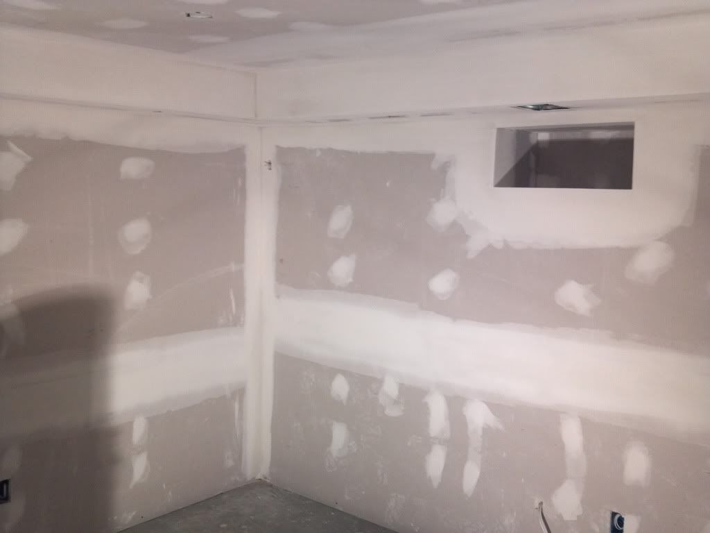

14 hours and two "Five Hour Energies" later and I'm back!!!
And guess what? I was visited by the theater progress fairies!!
That's right everyone, the drywall taping and mudding is finished!
It turns out our friend came over while we were away and got it all done. He said that it only took him one day since he used quickset joint compound for the first two coats and then skimmed everything with the 24 hour stuff to finish it off. I owe him lots of free movies when this whole thing is over!!
So tomorrow will be sanding and then I get to use the new paint gun! Yippee!

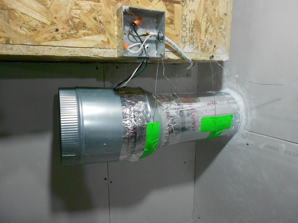

I did work on the dead vent for the room's return and managed to get that close to completion. When I went to install the fan, the duct that goes through the drywall on the side of the dead vent was very tight in the hole. As a result, when the fan was on, it vibrated the whole structure and produced a very annoying buzzing sound. So I have to cut the hole a little bigger and then suspend the fan and duct with some wires to "float" it inside. I'll have some pics once it's all completed.

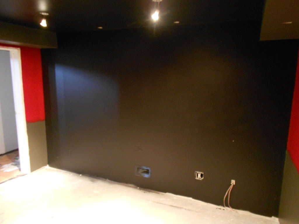

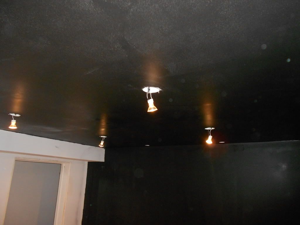

I also managed to get the first coat of black on the screen wall and ceiling. This is the "Mouse Ears" color by Behr.

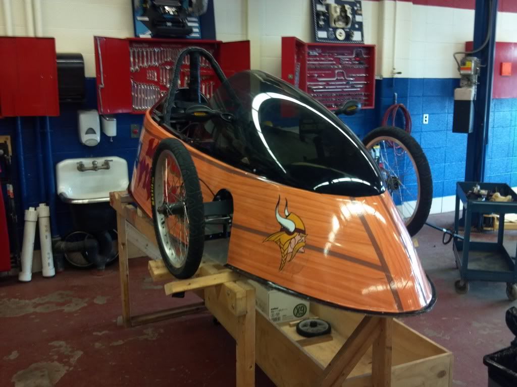

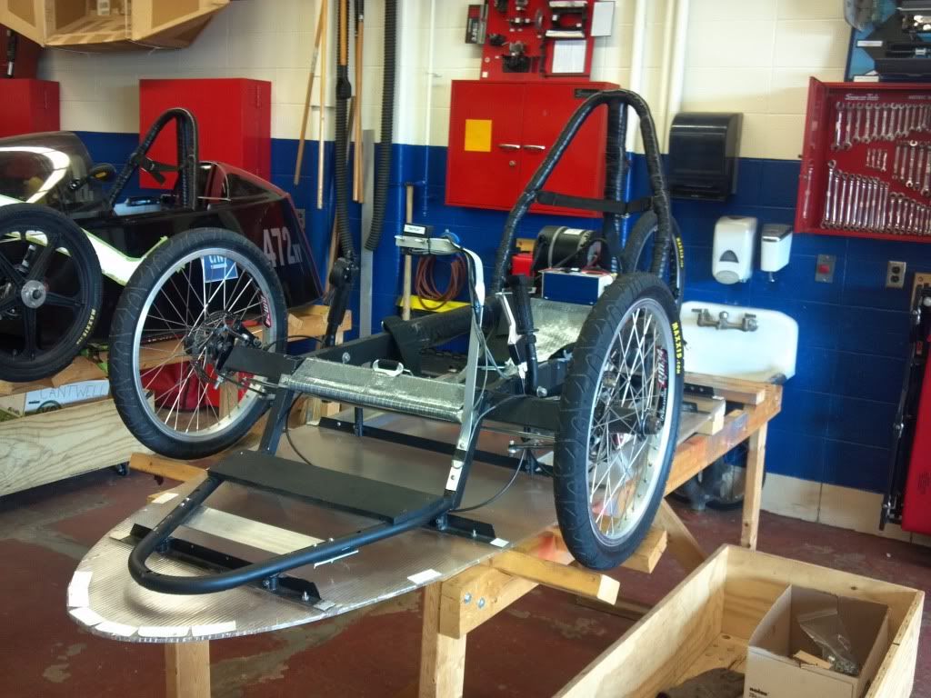

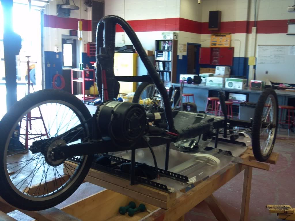

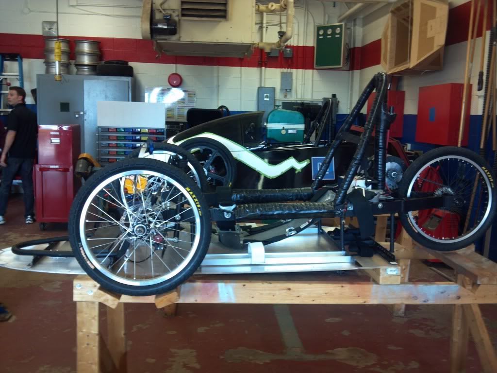

To prove that I haven't just been sitting around all week, here's some pictures of what I have been working on.

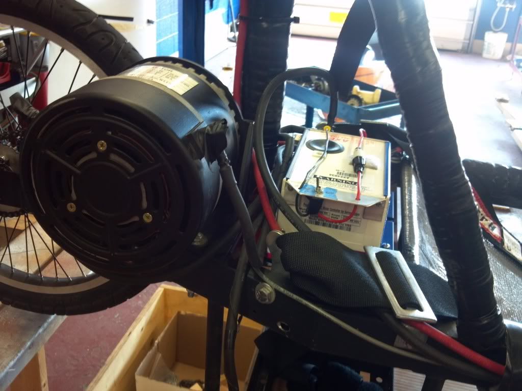

This is for the electrathon club at my school. Electrathon is an "electric marathon" in which the winner is the vehicle that can travel the farthest distance in one hour. The car frame is all welded tube steel and it runs on two car batteries. It uses BMX bike tires and has an electric motor which allows it to reach a top speed of about 55 mph. It goes without saying that it's incredibly fun to drive around.
The other black car that you see behind it is another one that we have been working on as well.
We've been working on it for a couple of months and our first race is supposed to be tomorrow, but unfortunately the weather doesn't look good as it is supposed to rain.
I've got my fingers crossed though!
The other black car that you see behind it is another one that we have been working on as well.We've been working on it for a couple of months and our first race is supposed to be tomorrow, but unfortunately the weather doesn't look good as it is supposed to rain.
I've got my fingers crossed though!So if we have the race tomorrow then Saturday will have no theater progress. If it's canceled then I'll work on finishing up the dead vent and painting. Then Sunday I've got to meet with the director of "The Producers" and then make a Home Depot run to buy materials for the set, so this weekend potentially won't have much progress in the basement-sorry guys.

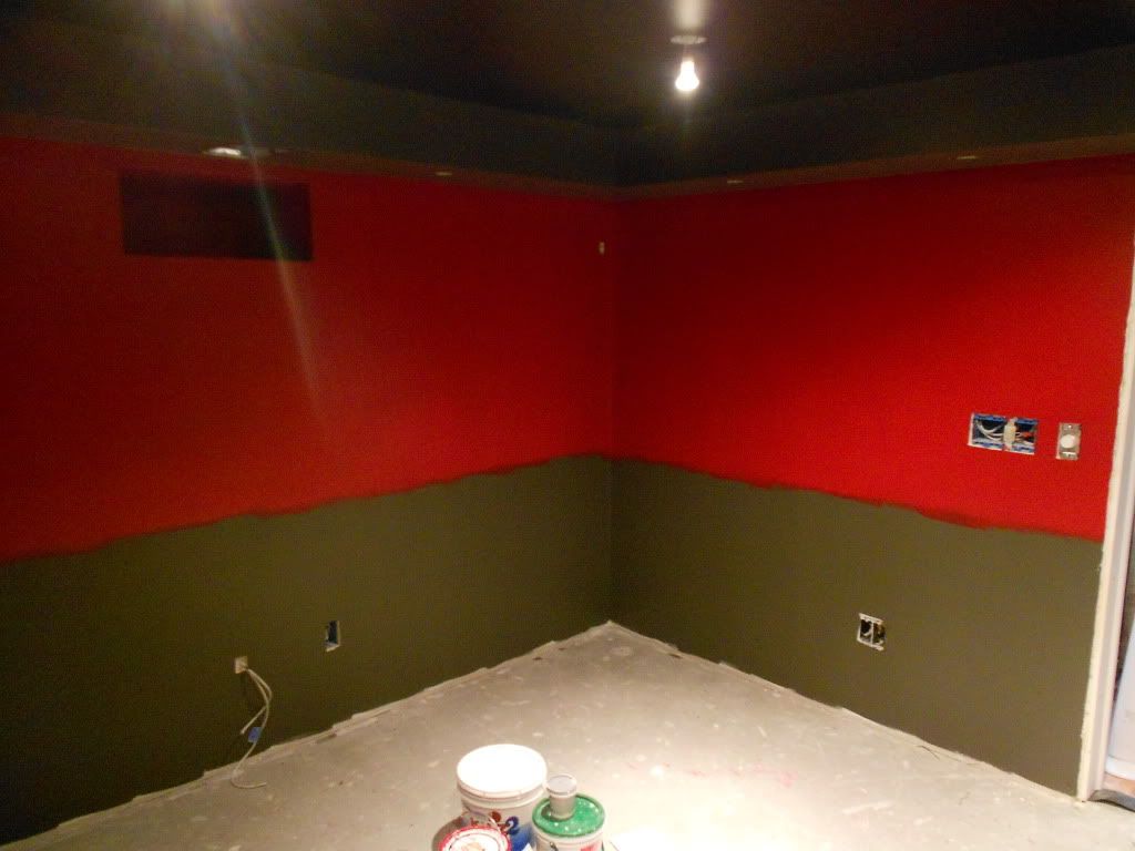

Well the race was canceled
....... but that meant lots of theater progress!

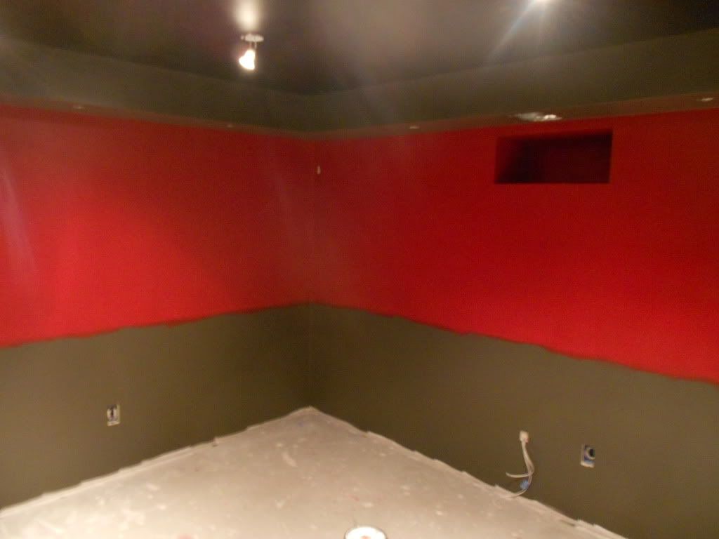

I got the dead vent finished and the room painted (I'll do a post later tonight with a description and pictures) but right now I need some advice.
The painting was going great until the red. I've come to the conclusion that there must be something wrong with the paint. Even after two coats it dries very blotchy, almost like lots of little bumps and if you look closely at it you can see the white of the primer. In addition to this, even after drying all night it still felt tacky in the morning.
It's a Glidden paint in eggshell finish. What's really strange is that the gray color on the bottom of the walls and the soffits is also a Glidden paint (although in their Martha Stewart line) and it covered beautifully in only two coats. The gray and red are actually the same base with different pigments.
I just put on a third coat and will let it dry to see what happens but I'm not optimistic.
So what should I do now? Take it back and get my money back then re-prime and try again? I really like the color so should I try the Glidden again and hope that the one I have now is just a bad batch? I also thought about having them color match the little paint swatch and then get it in a different brand like Behr which also covered beautifully on the screen wall and ceiling.
Any advice that you guys may have would be appreciated.
....... but that meant lots of theater progress!I got the dead vent finished and the room painted (I'll do a post later tonight with a description and pictures) but right now I need some advice.

Since no one else has responded yet, I'll jump in with my limited experience.
In our experience with using red paint, it can take a number of coats to get it looking right. It looks good when it is done, but can take a little extra work getting there.
I'm no expert, but we have ended up with four coats of red on a smooth plaster wall...and they were applied by someone we knew that actually knew what he was doing!
That said, if the paint is not drying as you expect, I would get in touch with the store and see if there have been any other complaints about this color recently. There may be a bad batch of base or colorant going around.
The store might also hear what your concerns are and quickly realize what the problem is and get things straightened out.
Good luck!
Good luck!

I may just be the quality of the paint. I've painted more than I care to remember, but in my experience Glidden was the worst paint.
Granted it's probably been about 20 years since I've used Glidden (tells you something about how bad it was).
Behr is pretty decent. Sherwin Williams is better than Behr. Benjamin Moore is the best paint I've used.
It took 3 coats of Benjamin Moore red to paint my living room from a white base. You may want to try one more coat. If it doesn't cover, your idea of switching to Behr is a good one.
You're prep and technique is fine; more likely the paint is at fault.
Tim
Tim

^^^I sure there is a scientific explanation but I have always had a harder time painting with reds/darker colors. Light colors cover better with two coats darker colors typically for me take three or more coats of paint. I would say that if you don't get the results you're after with four coats, would be a good time to look at other options.
I have had good luck with Sherwin Willimas and Lowes paints, I have even used Dutch Boy from Menards as well. I can tell you that the quality of paint matters. Behr comes highly recommended. Don't know much about Glidden.
The race car looks pretty cool if you ask me. Something that low to the ground going 55mph would feel like 100!
Glad your mom is on board with all of us "old farts" besides this forum is my "Facebook", now if only Mrs. RTROSE would get on board with my AVS addiction.
RTROSE
RTROSE

Gray Primer-Doh!-I should have known! Well now I'll be prepared for next time I guess.
I just finished the fourth coat and it finally looks like it's covering nicely so I'm keeping my fingers crossed. I will probably have to pick up another quart to have enough to do a fifth coat. I'm still a little worried about the tackiness when dry but I'll give it a few days and the reevaluate.
Thanks for all of your responses guys!

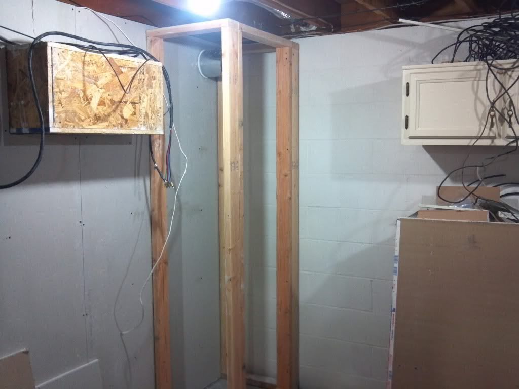

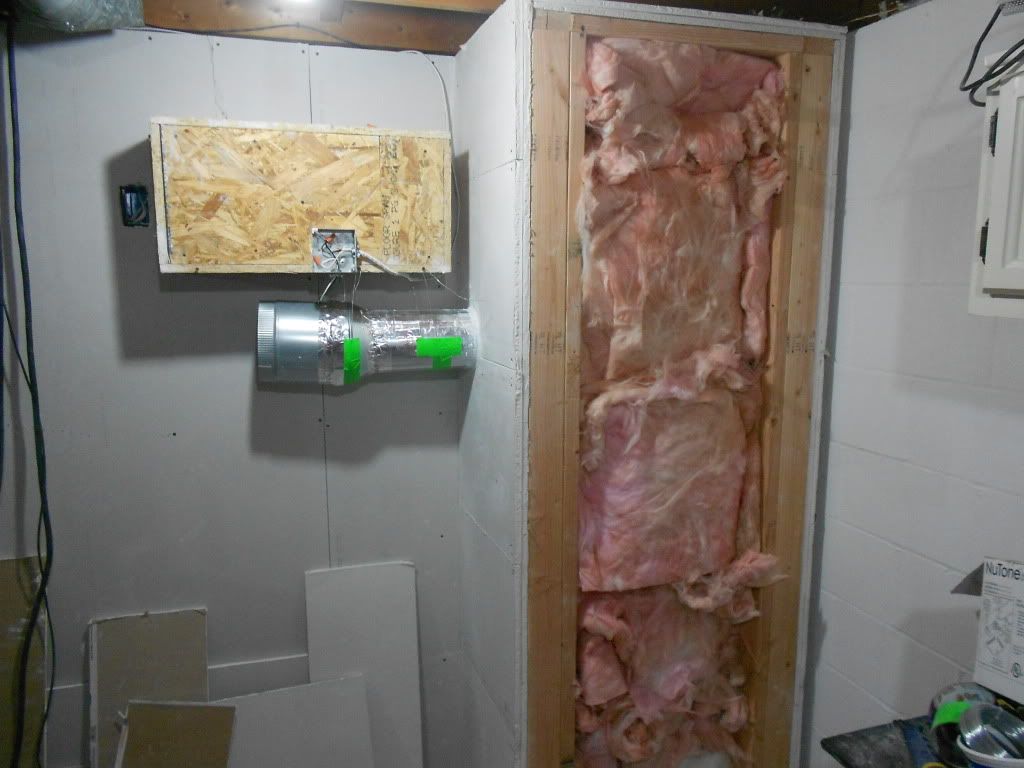

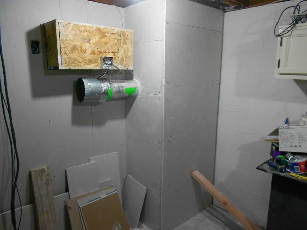

Well this weekend was supposed to have almost zero progress but it ended up being one of my best yet!
I tackled the painting and then worked on the dead vent in between drying coats and ended up getting a ton done. Here we go.....
Let's start with the dead vent:
I built a simple frame that would sit in the corner outside the theater next to the bump out for the projector box. The dimensions were 20" x 30". You'll also notice in this picture the drywall that was put up on the outside of the theater walls.
Then I covered the top and the side next to the foundation with double drywall and green glue. I put one layer on the back that attaches to the theater wall since the drywall that is already up will act as the second layer. Then I slid it into place and secured it to the theater wall. I ran the flex duct through it and then filled the cavity with insulation. So.....much...insulation......
Then I covered the remaining side with double drywall and green glue.
You'll notice in those last pictures the fan that draws air out of the theater. Here is a close up.
It is an 8" inline fan that I got at Home Depot for about $30. I don't know how long it will last but it has been working great so far. I thought I might as well try it first since other fans (such as ones by fantech) can get pretty expensive. It is suspended by the wires which are used for drop ceilings to "float" it inside the hole where the duct enters the dead vent to prevent the vibrations from making an annoying buzzing sound. The gap between the duct and the drywall is sealed with caulk to prevent any sound leakage. The fan is controlled in the room by a dial commonly used for ceiling fans. I've got to pick up a cover for the junction box next time I'm at Home Depot.

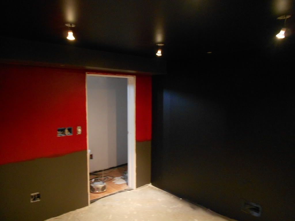

Now onto the fun stuff!
I've got a painted room!!
I started with the black on the screen wall and ceiling and did three coats. Then I moved onto the gray for the bottom of the walls and soffits. That only took two coats. Next was the red which after four coats is finally looking good, but I'm thinking that I will do a fifth to finish it off.
I must say that I am VERY happy with my color choices. I always knew that I wanted to do dark red walls and a black ceiling but it wasn't until I saw some other theaters on here (RTROSE and azula) that I decided a two tone wall with chair rail would look even better. I really couldn't be happier with it.
So my list of things to do looks something like this:

The car is awesome and I have really enjoyed working on it since it has given me the opportunity to learn some new skills (like welding) that I wouldn't have a chance to do otherwise.
You're absolutely right about the speed RTROSE. Remember that low riding exotic car from azula's thread? Well this is it's young child!
Looking good!
FWIW, you should have an electrical box mounted directly onto the fan. Mount a 4"x2" (trade name "handy box") directly on the fan with some screws. The Black/white/green wires will enter through the bottom of the box using a connector (I would use a plastic one versus the NM connectors you have).
Also, if you look on the bottom right of the 4" square box you used, there is a threaded hole. That hole is for a ground screw. You can buy the green ones or use a 10/32 screw.
Tim

Originally Posted by Mr.Tim
Looking good!
Tim
Looking good!
Tim
Thanks for the advice Tim! I will definitely pick up those materials and do that.

The red looks really nice in the pics. I just want to throw out there that I had really good luck with the Behr Ultra Premium + Primer. The mouse ears went on in one coat. I also recommend the Sure Line 3/8s nap roller covers, They seem to pick up more than paint than other and the Behr paint was thicker than others that I used. The red went on really nice. However, I should mention that I did have a gray primer on the walls and one crappy coat of red (different brand).

Thanks Tom. I noticed that the Behr was a little thicker as well. I definitely prefer it over the Glidden.
Vanice;
It is very nice to have the fan be easily accessible. It's located in the adjacent storage space.
I have been impressed with it so far. It has been running on high since Saturday to cycle some air through to hopefully aid the paint in drying. I can only faintly hear it when I stand in the open doorway so once I get that all closed up it should disappear.
The real test will be once I get the door sealed and I have a chance to test out how air tight my room really is. If I did everything correctly then the only place for air to enter the room will be through the other unpowered dead vent under the stairs. So ideally the airflow coming through there should be almost the same as what the fan is pulling from the room.
Vanice;
