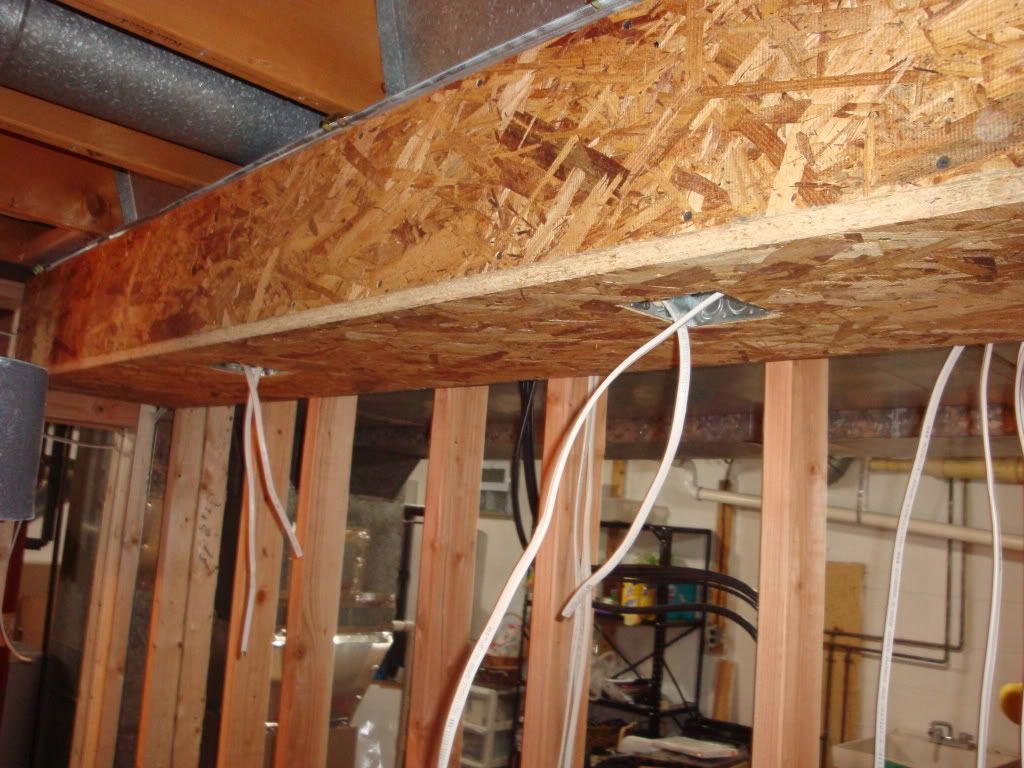

I am about ready to build the soffits. The two running along the sides of the room will be built before drywall as they need to box in a beam and some HVAC lines to other parts of the house. I will be using the plywood + drywall method to save ceiling height. Each soffit will have a dedicated piece of channel reinforced with extra whisper clips to hold a 2x2. Another 2x2 will be attached to the wall and two pieces of plywood will form the frame. Does anyone have any recommendations for what screws to use for attaching the 2x2 to the channel? I don't know if fine threaded drywall screws would be strong enough as it will weigh quite a bit.

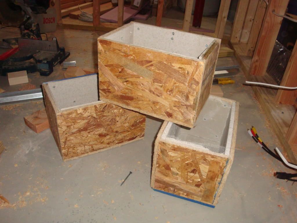

Weekend update:
I didn't get as much done as I would have liked this weekend. Unfortunately I didn't factor in the extra clips that would be needed to support the soffits so I need to order more Whisper Clips. Get ready for a call tomorrow Soundproofing Company!
I did start building the backer boxes for the recessed lights. Man, they take longer to assemble than I thought. There's a lot of plywood and cement board to cut but they're coming along.
So I need to finish the backer boxes and then build the soffits. Then I can move on to installing the drywall and the dead vents. My goal is to have drywall hung by the end of next weekend. Wish me luck!

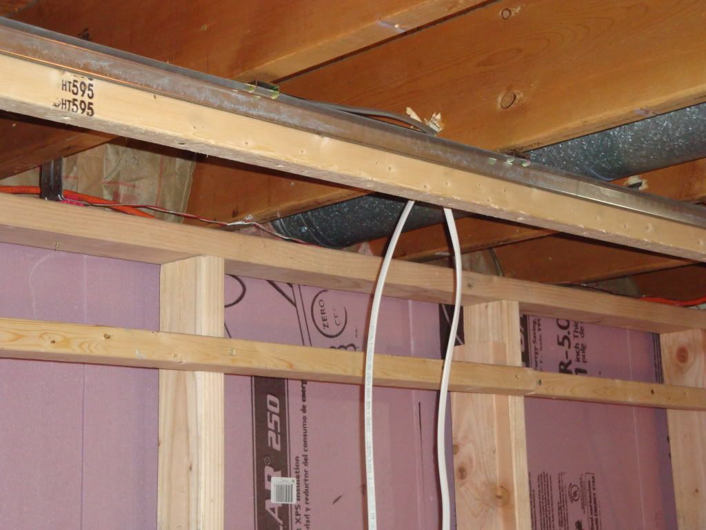

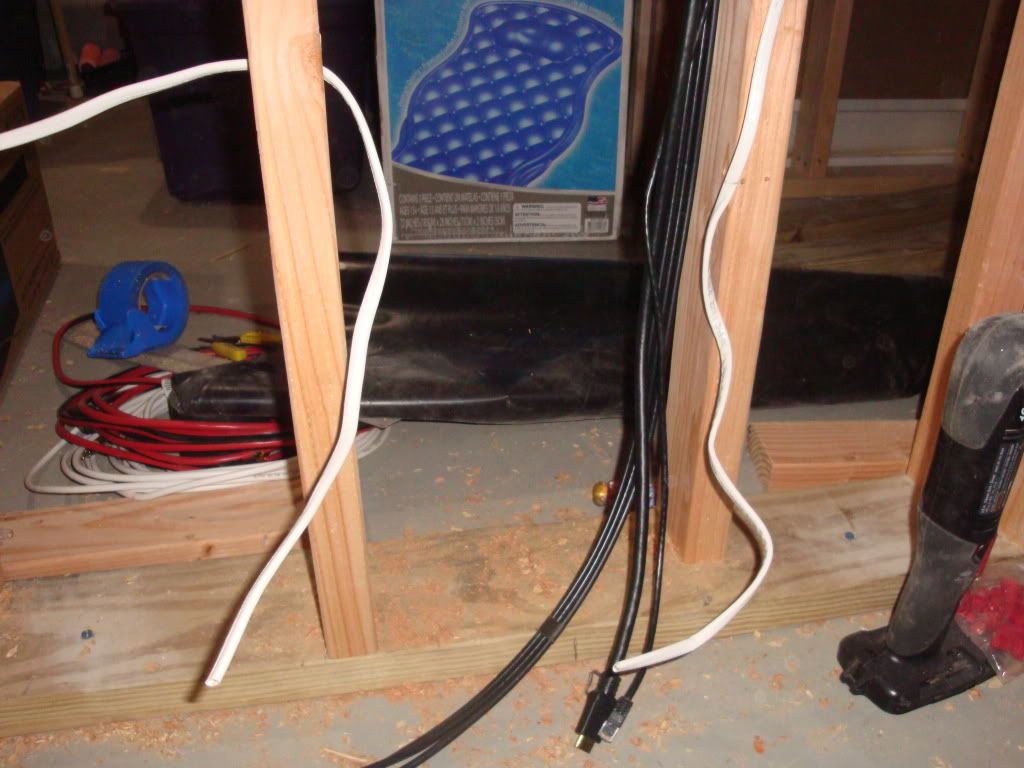

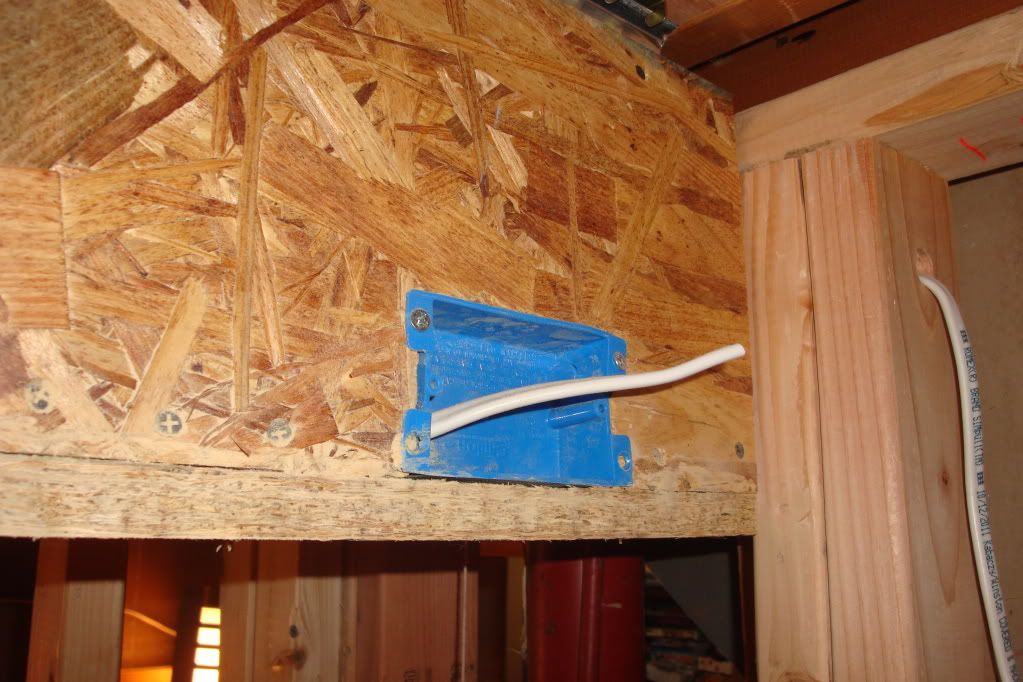

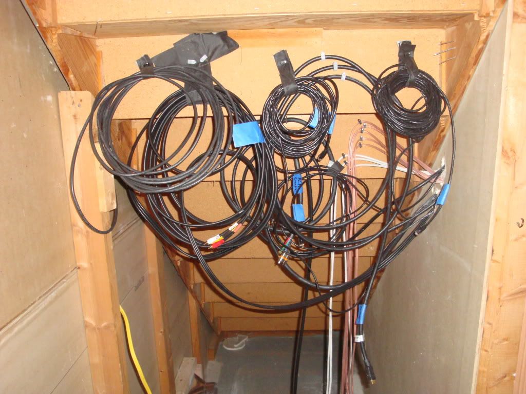

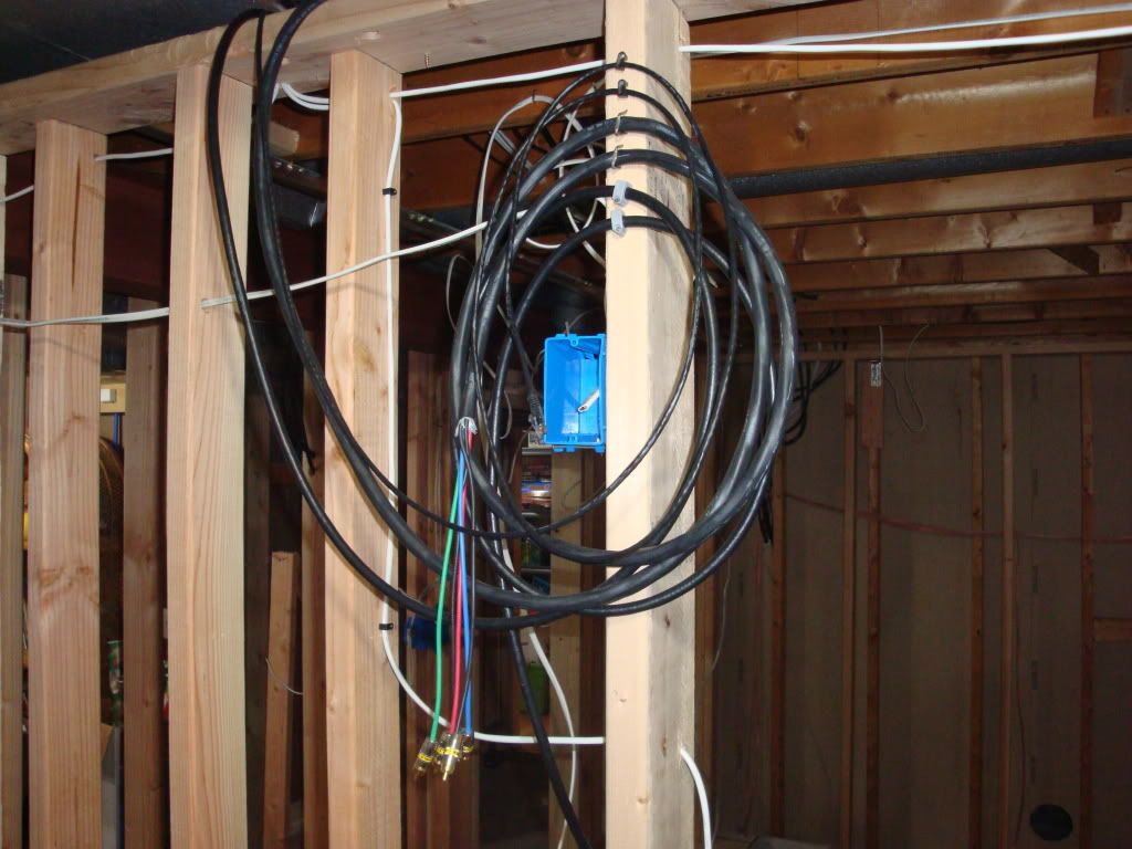

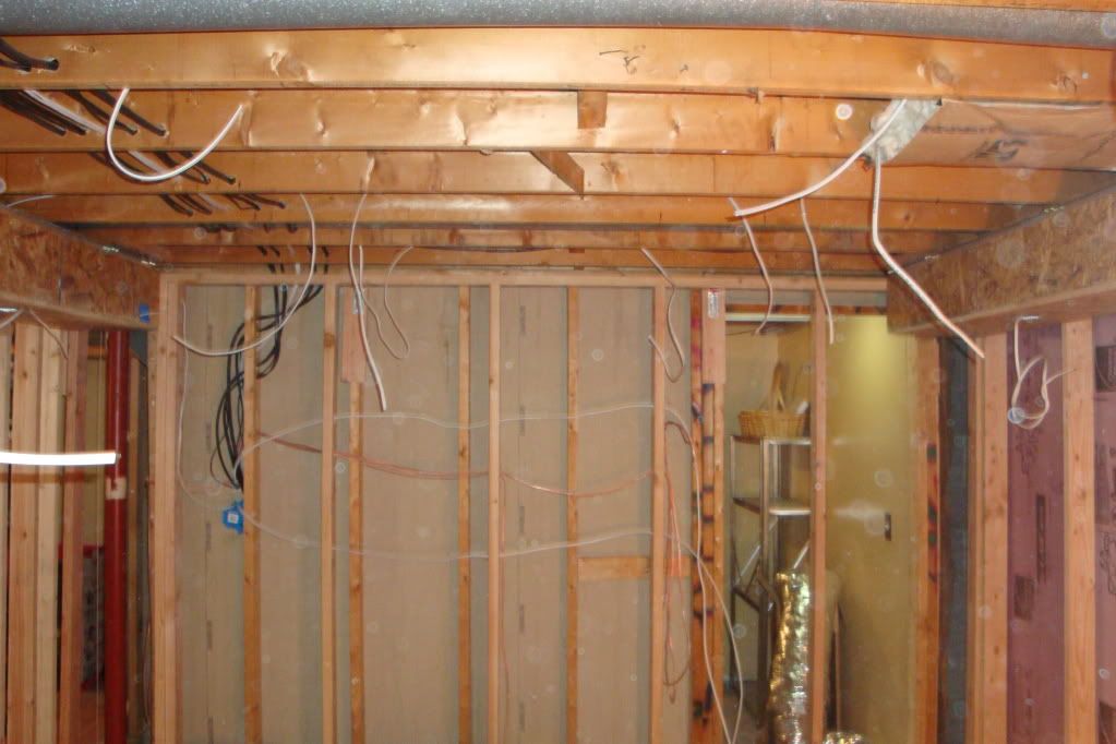

I finished running all of the low voltage for speakers, projector, internet, etc. into the equipment closet under the stairs. I've done some pretty big musical theater light rigs but nothing compares to this. I've never seen so many wires for such a small room. This is coax for the cable box, HDMI to the projector, HDMI to the wallplate in the room, ethernet supply, ethernet to room wallplate, Cat 5e to projector, RCA snake to projector, composite video and audio to wallplate, 5.1 speakers with two lines to the front left and right for bi-amping, and a line to the back for bass shakers plus a dedicated 20 Amps. I'm still deciding on if should wire in for front height speakers now but I don't think I have enough speaker wire. I might get more and do it.
Here is a shot of where the wallplate in the room will go. It will have HDMI, ethernet, and composite video and audio. This is for if someone brings a video camera, game system with wired controllers, etc. so that it can be used inside the room since all of the equipment will be housed in the seperate closet outside of the room. There will also be an electrical outlet.
Here is where the projector will be housed. There is an outlet, HDMI, Cat 5e, and an RCA snake with 5 cables in it in case I ever need to run component video or something else like that.

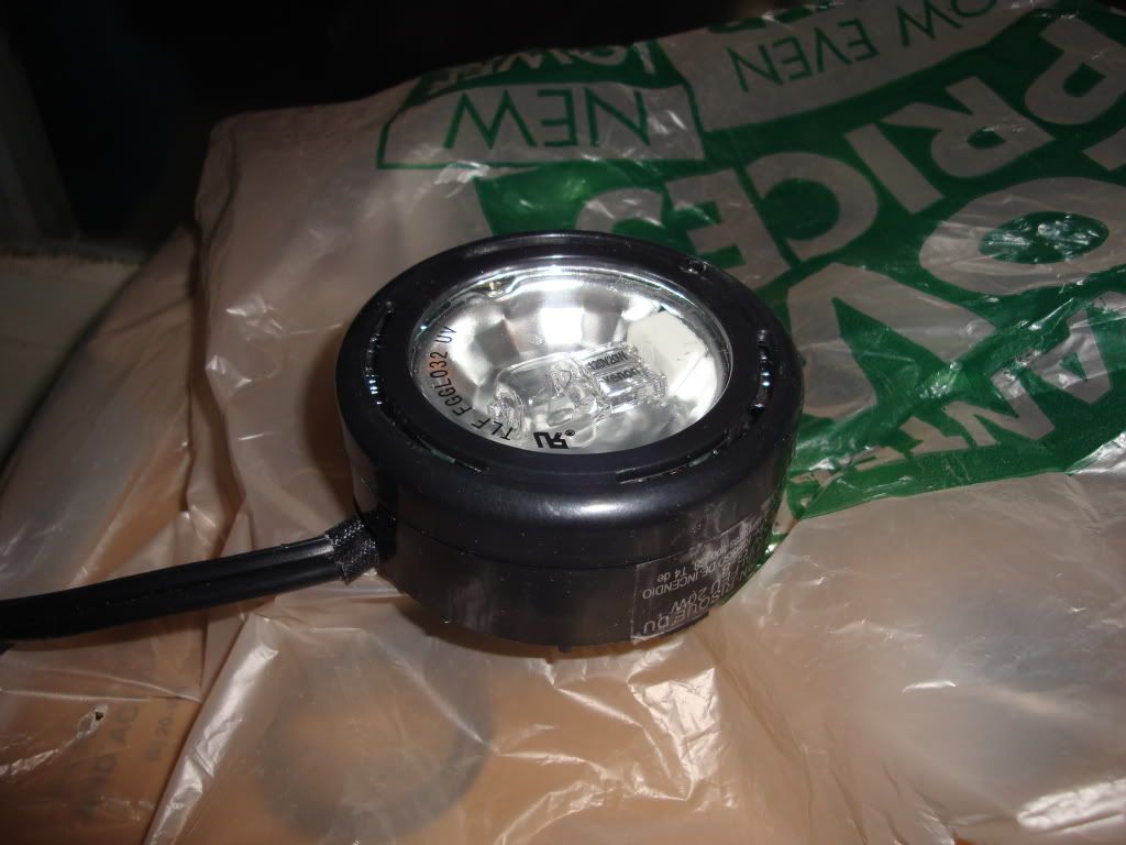

I've changed my lighting plan around a little. There will now be puck lights in the soffits and above the screen instead of the 3" recessed lights I originally planned for. This is because the soffits would be too large if they concealed the beam and had to fit the lights. I will be putting three puck lights in each side soffit and two in the back soffit. There will also be two in front of the screen. These will be about 8" from the wall to provide a "wash" effect. I will also be putting four of the 3" recessed lights in the ceiling between the soffits to provide more light. Rope lighting will also be concealed in crown molding around the soffits. So that's four zones of lighting: soffit pucks, screen pucks, ceiling cans, and rope light. The current plan is to just use four standard dimmers. I can't afford a Grafik Eye right now but there is always the option to upgrade in the future.
Puck Light:

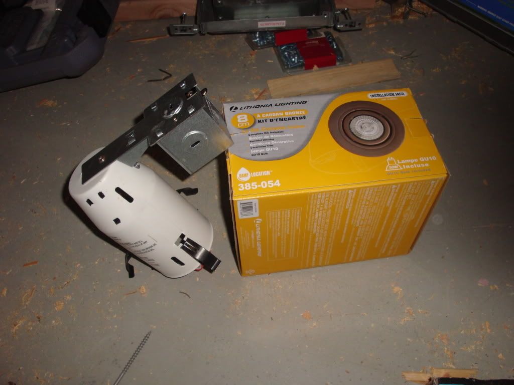

3" Recessed Can:

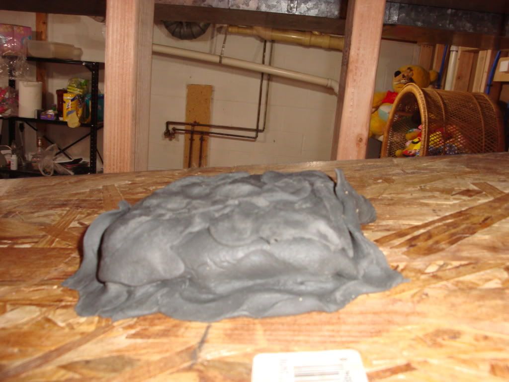

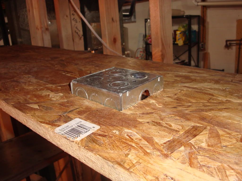

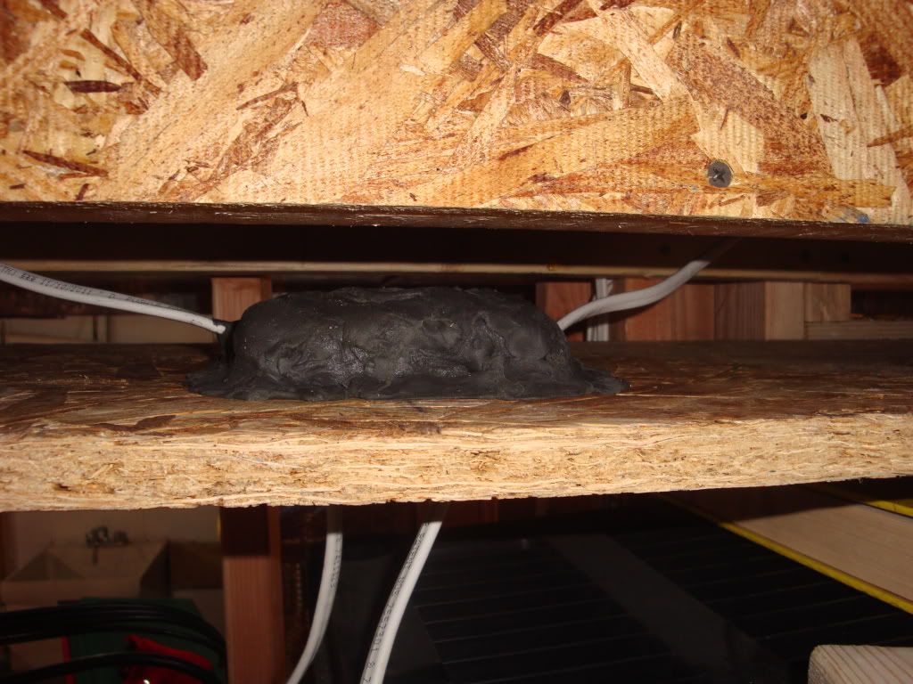

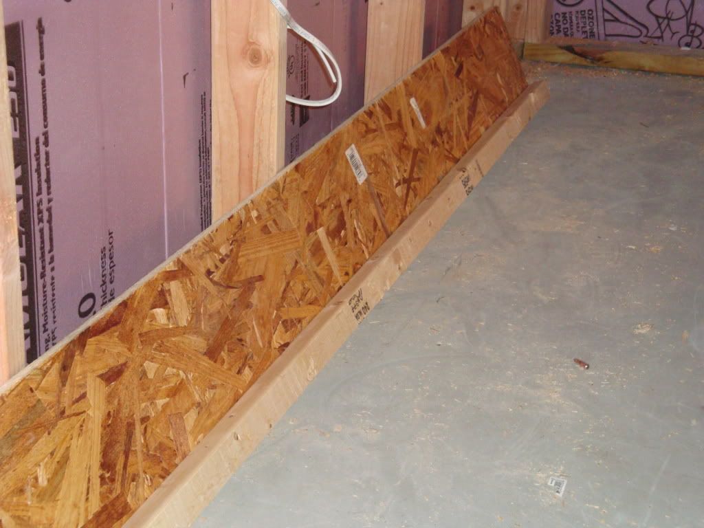

Backer boxes for the ceiling cans:

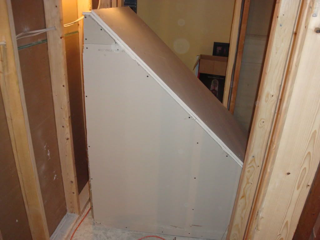

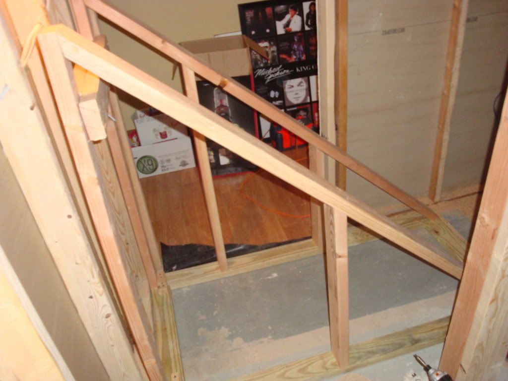

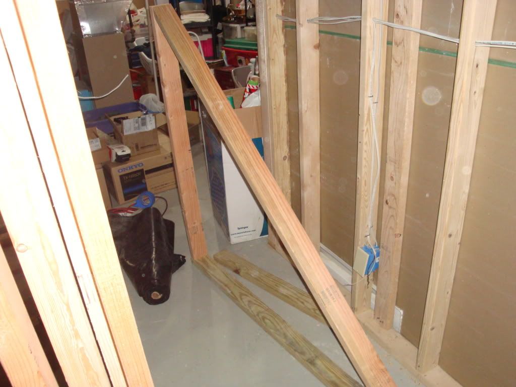

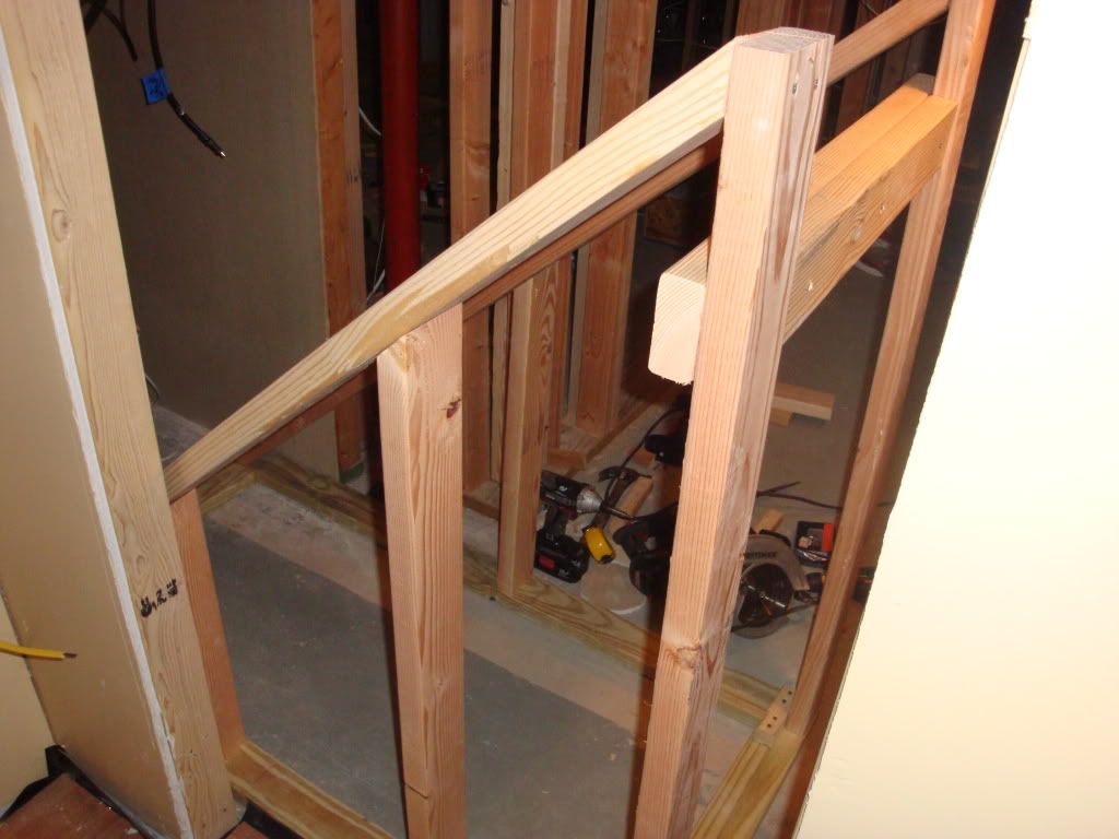

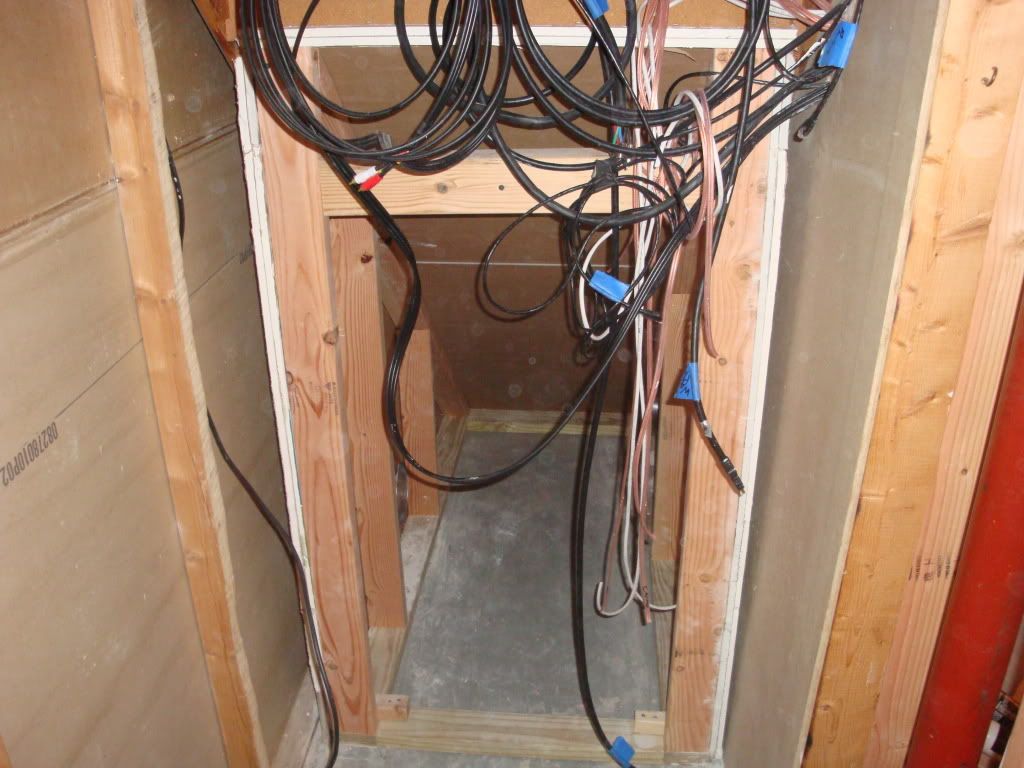

I have also started construction on my somewhat unconventional dead vent which will go under the stairs. There will be a supply in the front and an exhaust in the back of the room. The exhaust will have an in-line fan which draws air out of the room. It will be controlled be a variable speed controller inside the room. The supply in the front will be unpowered and will work off the principle that air will naturally flow in from the decreased pressure due to the exhaust. Both will have dead vents but the only place I could put the supply one is under the stairs. So it will be built according to Ted White's specifications but will be in the shape of a triangular prism. Here is a pic of one side of it:
I will complete the framing, cover the sides, top, and bottom in DD+GG, and then slide it in under the stairs. I will then connect the flex duct with some bends, fill it with fiberglass insulation, and cover the front with DD+GG. Then I'll frame a wall in front of it to hold the shelving for the equipment. Here's a pic of under the stairs. You can see the hole where the 6" duct will enter the vent from the theater. The register on the otherside is in a hallway. This is where the air will be drawn from.

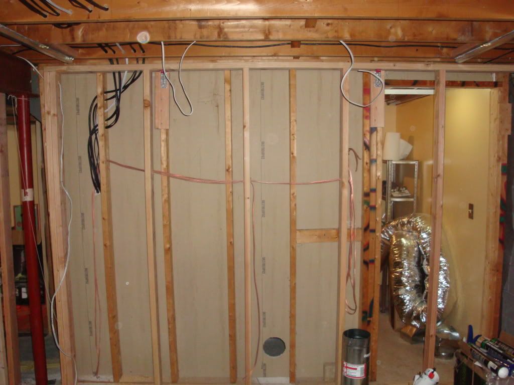

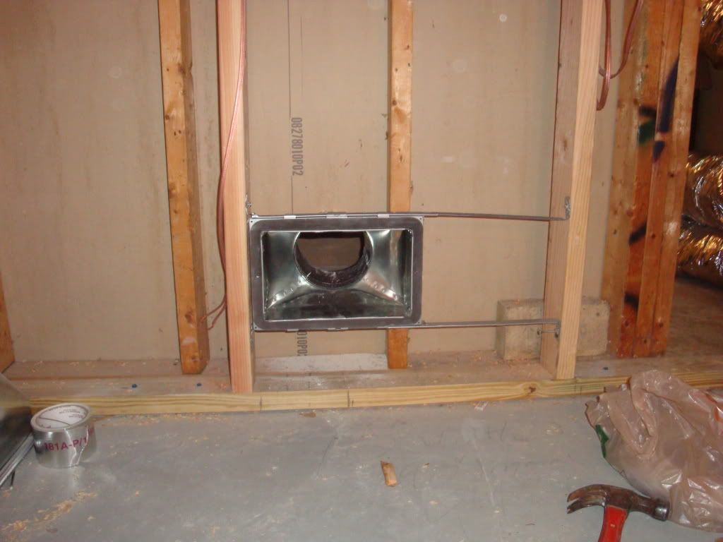

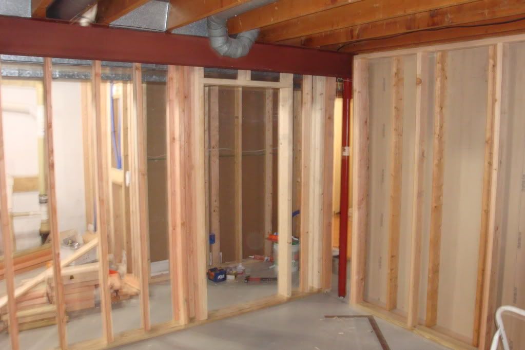

And here is a pic of the front screen wall. The hole is where the register will be located inside the room:
So my plan going forward is to finish the dead vent, frame the wall for the equipment shelves, build the soffits, and then install the sheetrock. I have all of next week off for the holidays so my goal is to have all the sheetrock hung by the end of January 1st.
If you made it through this extremely long post then thanks! I look forward to any advice or comments you might have.

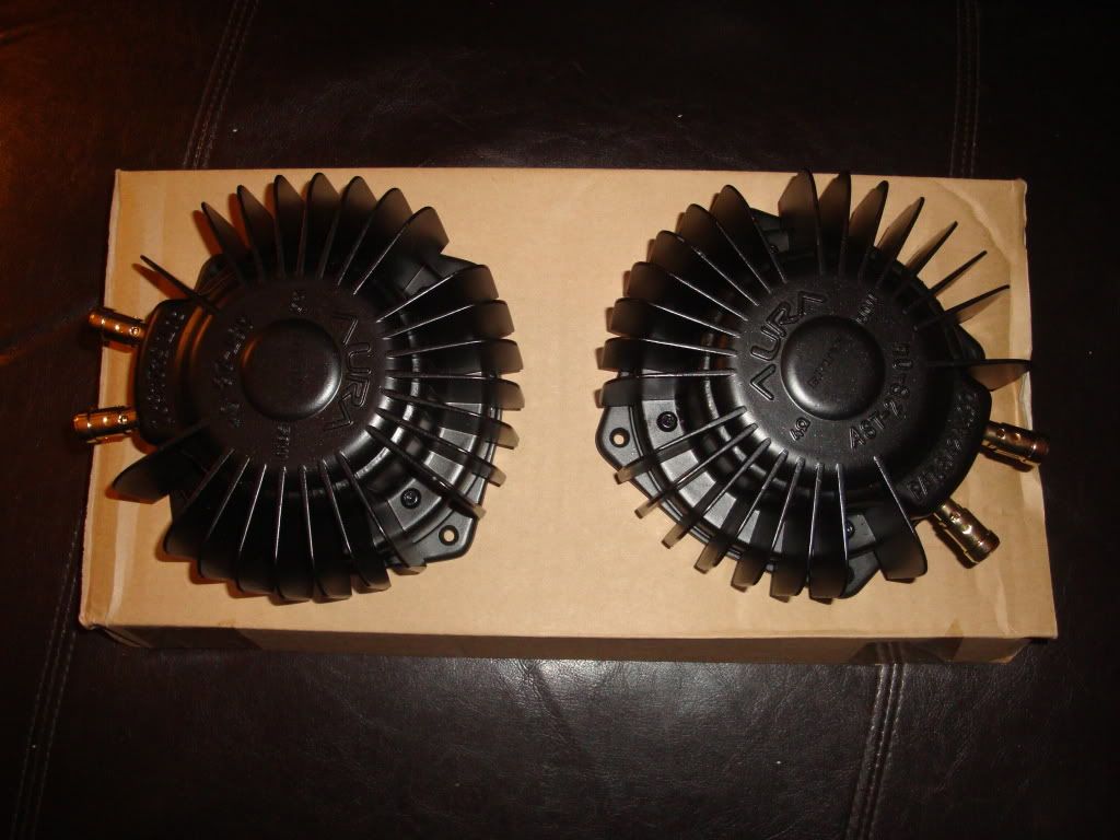

I also received some early Christmas gifts that I couldn't be happier about.
A pair of Aura Pro Bass Shakers from the grandparents:

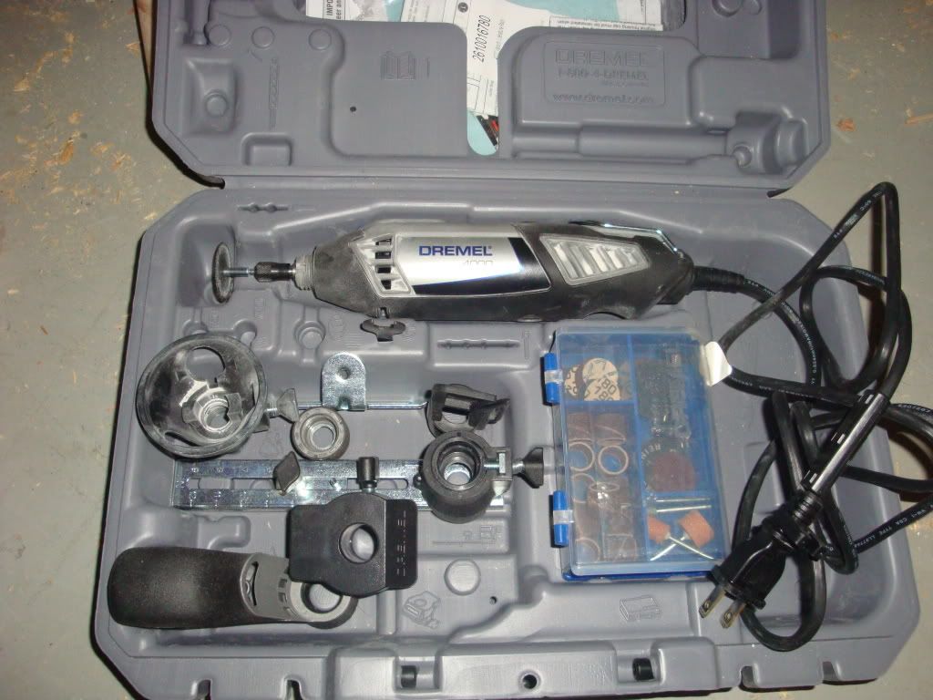

And a new toy to help during the build:
Dremel 4000, perfect for cutting holes for lights, outlets, etc. in drywall.

Well I do believe it is time for an update!
Everything is moving along nicely on the theater. Here is what has been accomplished since my last post.

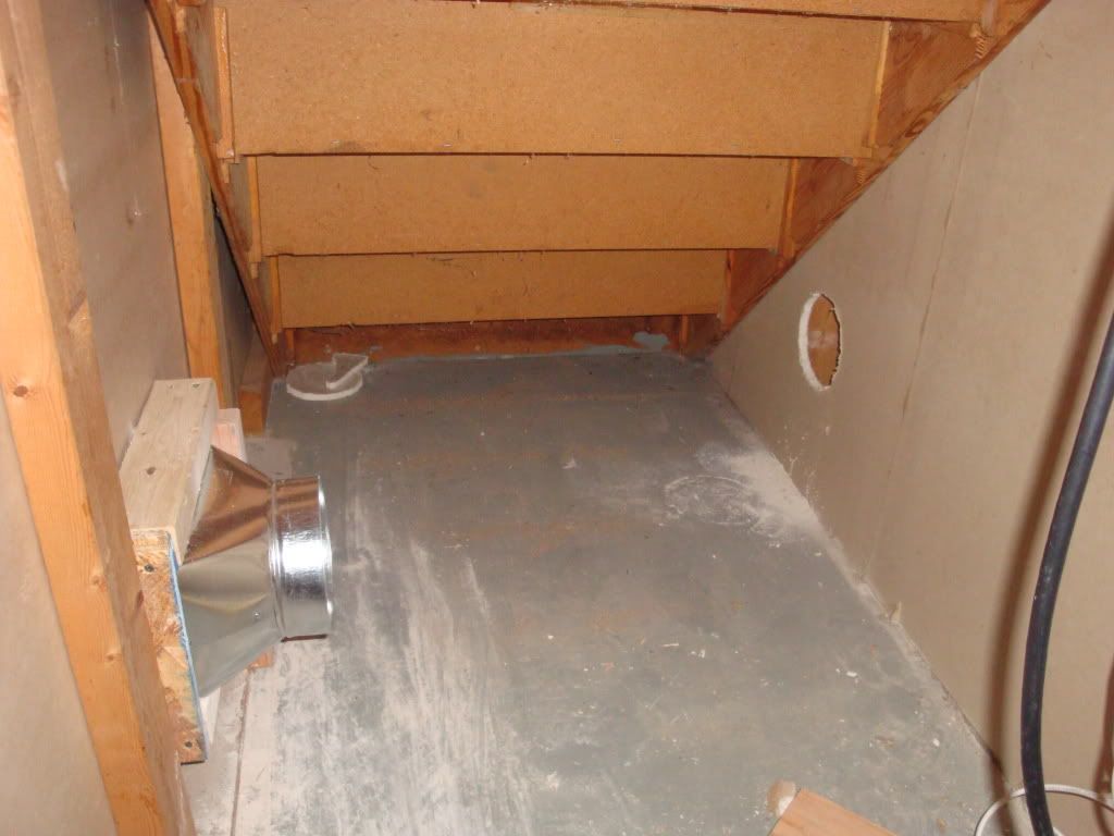

First I finished my unconventional dead vent under the stairs. The framing was completed:
Then the top and sides were covered with a double layer of drywall and green glue:
The whole thing was then pushed under the stairs (it weighed a TON at this point) where I cut the holes to receive the ducting from the hallway and theater:
The air will be drawn from an adjacent hallway to the theater:

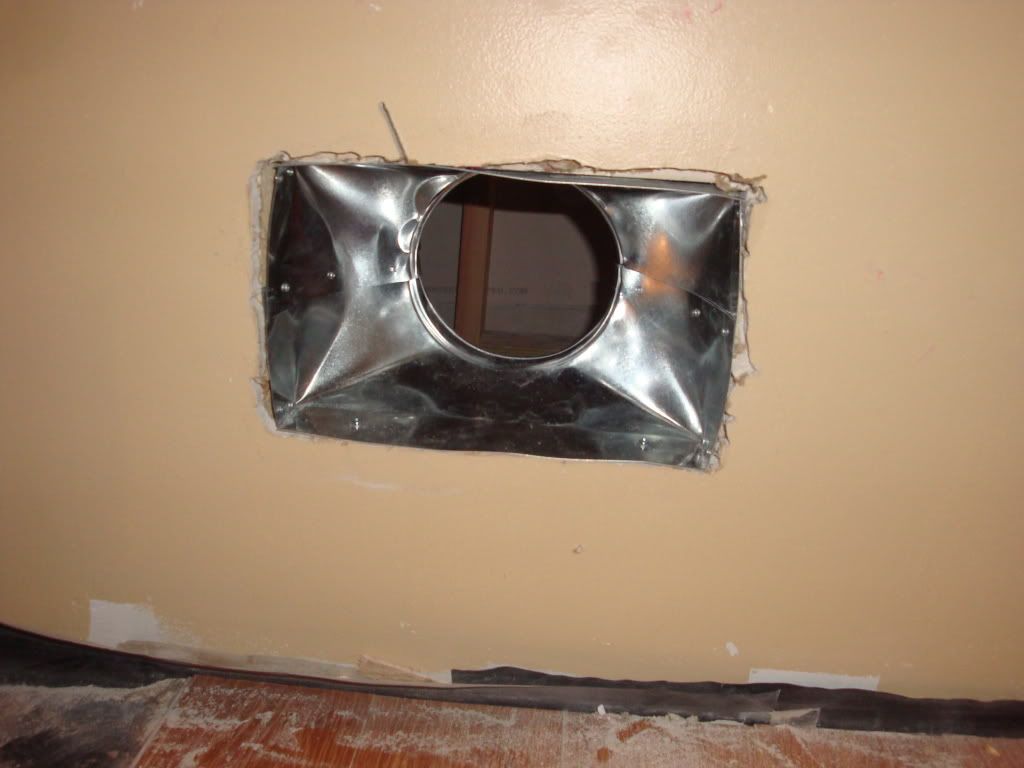

The register for the theater is located on the front wall in the center of the room under where the center channel speaker will sit:
This is the supply for the theater. The return register will be in a soffit at the back of the room with another dead vent. I now need connect the flex duct and fill it with insulation.

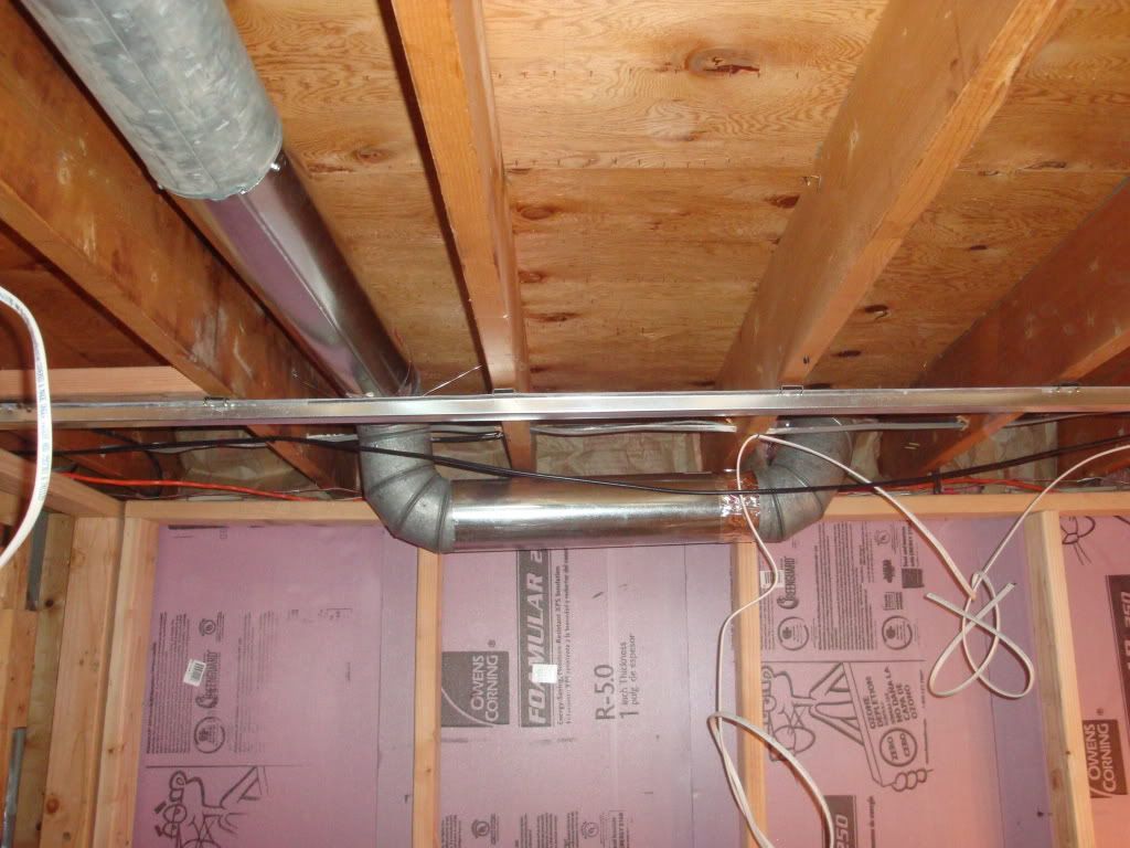

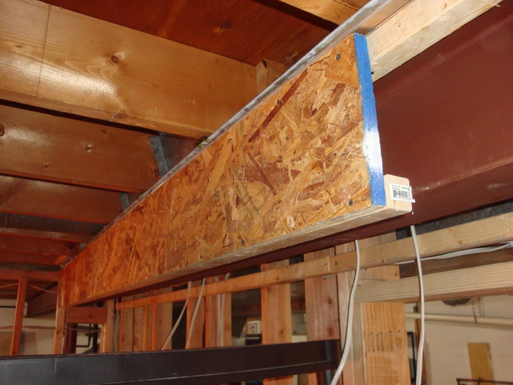

Next I had to move an HVAC supply line to a register in the dining room. Due to my new lighting plan a recessed light now needs to be housed in the joist space that the supply resided in. As a result I had to move into an adjacent space. This also got it out of the left side soffit. Here is what it looked like initially. It is the elbow hanging down by the I-beam:
I removed the elbows and capped off that line. I then cut a hole in the supply trunk for the new takeoff and ran the duct through the new joist space. It then drops down on the other side of the room to get back to the dining room register.
The piece hanging down below will be concealed by the soffit on that side.
The next step was to construct the two side soffits. I decided to build them before drywalling the whole room because of the fact that they had to conceal the I-beam and HVAC supply. I used the OSB + Drywall method. First I installed a dedicated piece of hat channel reinforced with extra whisper clips:
A 2x2 was then attached as a top piece and another 2x2 was attached to wall. I got 3/4" OSB cut into strips of the appropriate width at Home Depot (SO MUCH easier than ripping them all down myself). I attached another 2x2 to the 8" piece that makes up the vertical face of the soffit:
This piece was then secured to the 2x2 on the hat channel:
Next I had to devise a way to preserve sound isolation with the puck lights which will be housed in the soffits. The lights have a clip which attaches to them so that they can be installed like remodel light cans. To house the electrical connections and preserve sound isolation I installed 4"x4" electrical boxes. First a hole was cut in the soffits at each point where a light was to be installed:
The electrical box was then inserted into the hole and screwed into the soffit on the sides:
The box was then covered with a 1lb pug of duct seal for sound isolation:

After the drywall is installed on the soffit I'll go back and cut a hole the diameter of the light in each box. Then I can just pop it in.

I also installed an electrical box on the front face of one of the soffits to serve as a connection point for the rope lights in crown molding. This box was also covered in a layer of duct seal on the back.
And that's where the room stands today!

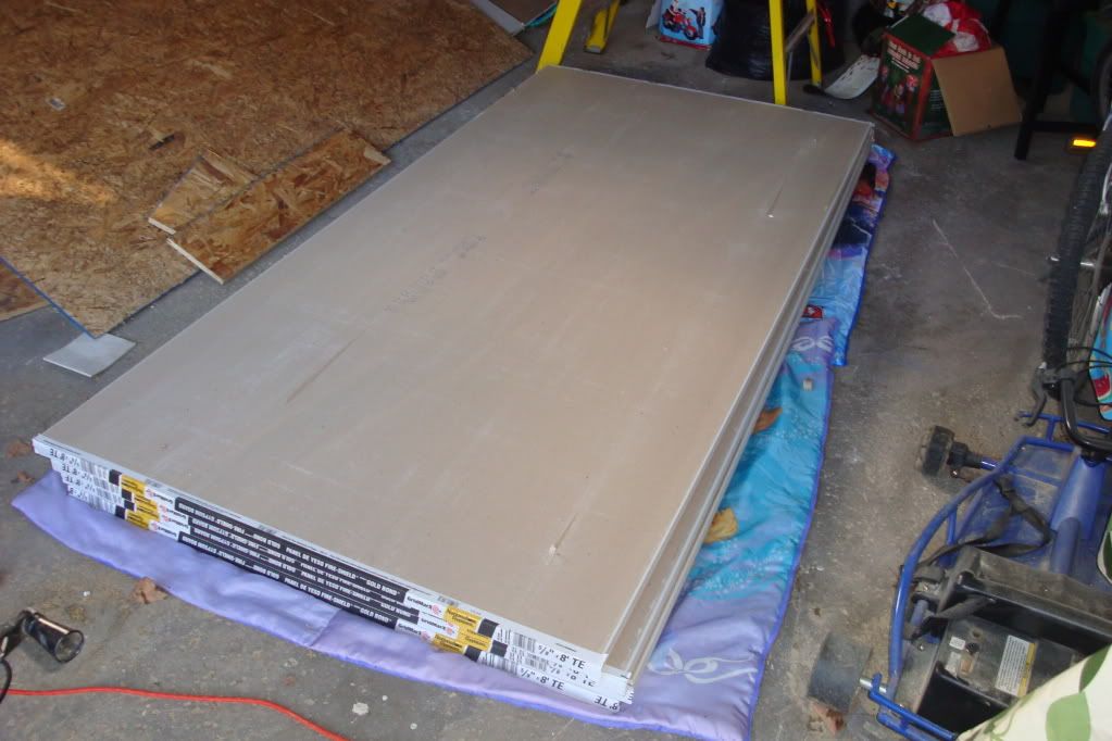

I used a coupon last night to buy all of my insulation and half of my drywall.
I only need twenty sheets as I had some 12ft pieces brought in when we cut a hole in the foundation for an egress window. That was before I decided to do double drywall or I would have had it all brought in then. Yay for carrying it downstairs!
Oh joy let the itchiness begin.
This week will be spent installing the insulation and transporting the drywall into the room so that I can rent a drywall lift on either Saturday or Sunday and begin installing drywall.
The romex was inserted into the box:
And then the bottom piece of OSB was secured to the 2x2 on the wall and the 2x2 attached to the bottom of the vertical piece to form the complete soffit:
The soffit on the other side was built in the same way. Here's what they look like if you're sitting and looking at the screen wall:
