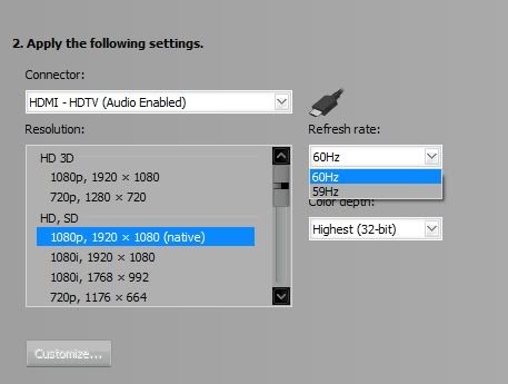

I would like to run my Windows desktop at 2D. However, once I add 3D capabilities to Windows using Nvidia (which creates 1920x1080@24Hz and 1280x720@60 3D resolutions). However, when this happens, my 1920x1080@24Hz option is no longer available in 2D.
If I try to create a separate 2D 1920x1080@24Hz custom resolution, Nvidia will say that I already have this PC resolution.
Anyone with an modern Nvidia card and has messed with 24Hz and has 3D capabilities on their TV would most likely know what I'm talking about:

I am using driver 280 and have a GT520 Card connected with HDMI 4.1 to my Samsung 59D8000 Plasma TV.
Can someone tell me how to fix this?
The 24p 3D mode in 2D works but the picture quality is really bad compared to the normal one.
Btw, I am still using the 280 driver because all newer drivers have problem with the HDMI sound (DTS is stuttering) and couldn't find any solution online why this is happening. I am using the Denon 1912 receiver.
As you can see from the first picture, there is no more 24Hz option ;(
Thanks for your help.

You mean in the NVIDIA settings (see pictures from my previous post)?
post #15 of 32
In windows desktop r click screen resolutions--->advanced---> monitor tab in the drop menu there should be a list of refresh rates.
Ahh... I remember now when I had my GT 220 I had to manually disable 3d in the nVidia control panel to get 2d 23Hz, it's the one Achilles heal of nVidia's 3D implementation. With my ATi setup there is no user input everything just works, but then again I always have my HTPC set to 23Hz. VLC takes care of my NTSC recordings just fine without switching refresh rates.

Hmm, that is exactly what I mean.
