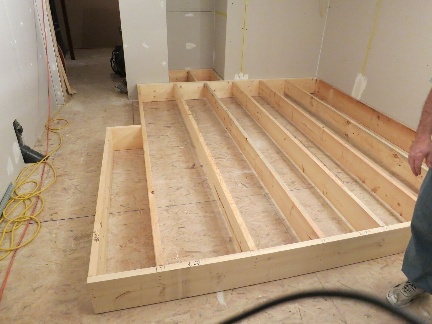

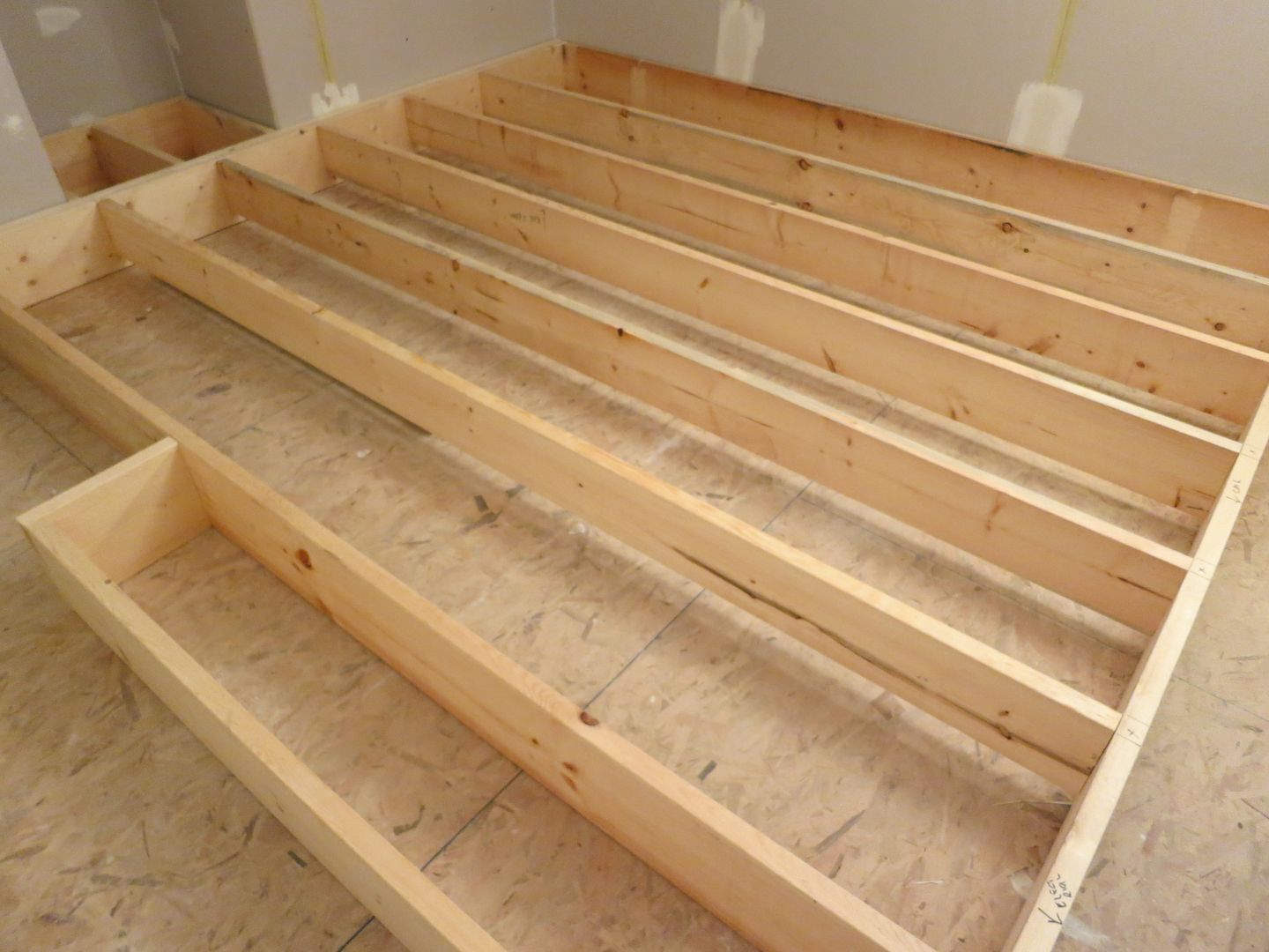

Building the Riser
The Erskine design of the riser involves a perimeter of 2x10s, cross members of 8x10's. The 8x10 space is insulated and an air gap is left at the bottom. a corner slot vent is cut turning the riser into an absorber. The technical details and determining the volume and tuning appropriate for your room are His intellectual property and you should engage him for help if you are interested.
"...an air gap is left at the bottom (of the riser)...."
How do you prevent the insulation from slipping down over time?

Good question! I'll answer it with a cryptic response...per usual. Is the insulation causing the resonances or the cavity formed from the joists that are causing it? I guess the real question is, does it matter if the insualtion is touching the floor or not?
post #183 of 320
DIY, In this case the insulation flange was stapled to the joists.
Shawn, just following the plans from your company.

My longest 2x10 span is 129" on a 2x12 perimeter. Should I use joist hangers?
post #186 of 320
IMHO not unless you are planning on having 20 people dancing on the riser. I didn't use them.
post #187 of 320
Did you secure the riser to the floor?
I wont be able to get the framing nails into the 2x10 (decking) studs from outside the perimeter framing on the back wall (the way I would have liked). My option then is to toe-nail them in, but never having done this before, not sure if they will hold the weight.

What's the purpose of putting Green Glue between the layers of decking in the riser and stage? Roofing felt?
post #189 of 320
I've built risers/stages with double layers with roofing felt, and Per DE's instructions done triple layers with GG. After thumping around with my size twelve dance shoes I actually prefer the later and that will be the way I would do my next personal theater. It was more rigid and quieter.
Big - I wanted to ask you about this construction method. I have seen Dennis' proscenium plans where two layers of 3/4" sandwich a layer of 1/2" with Green Glue in-between. This makes sense to me for trying to prevent sound vibration from transmitting into the floor and creating flanking noises in other rooms.
But for the riser, I don't really see how green glue and/or felt would come into play. Isn't it best just to glue (construction adhesive) and screw two layers of 3/4" ply with nothing in between for the strongest connection? What exactly does the felt do? Or what is the benefit of using Green Glue in the riser? Thanks in advance for the input!

The roofing felt is inexpensive, and it prevents wood to wood squeaks.
