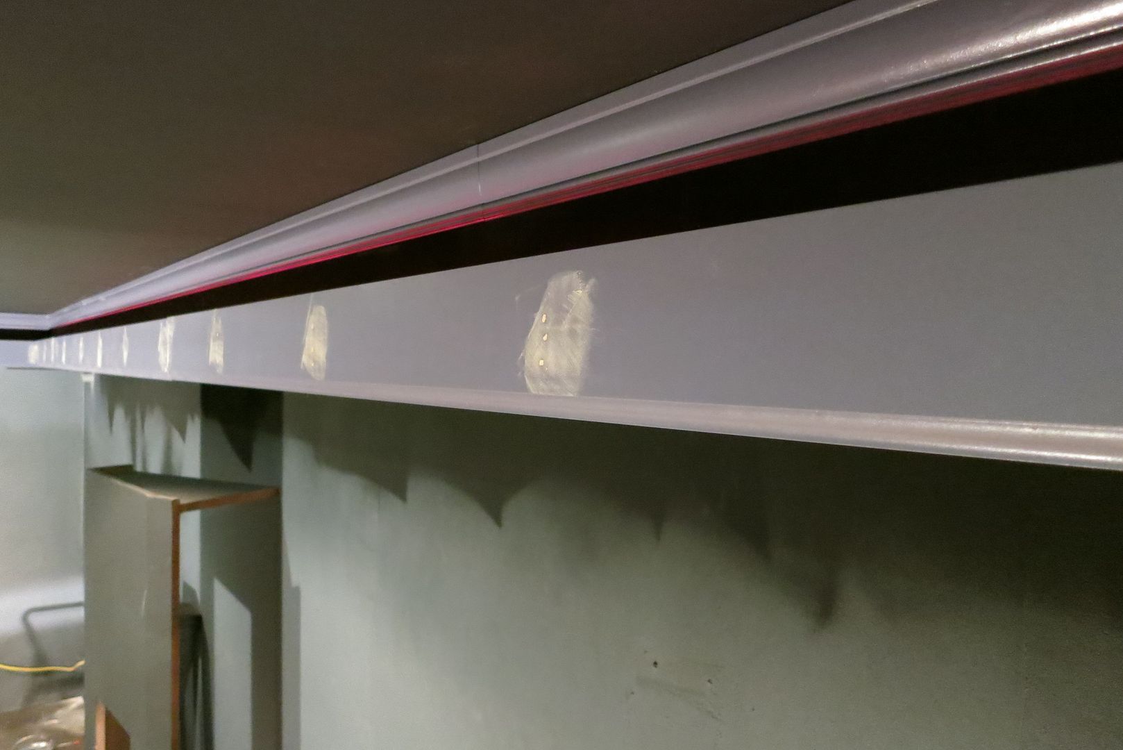

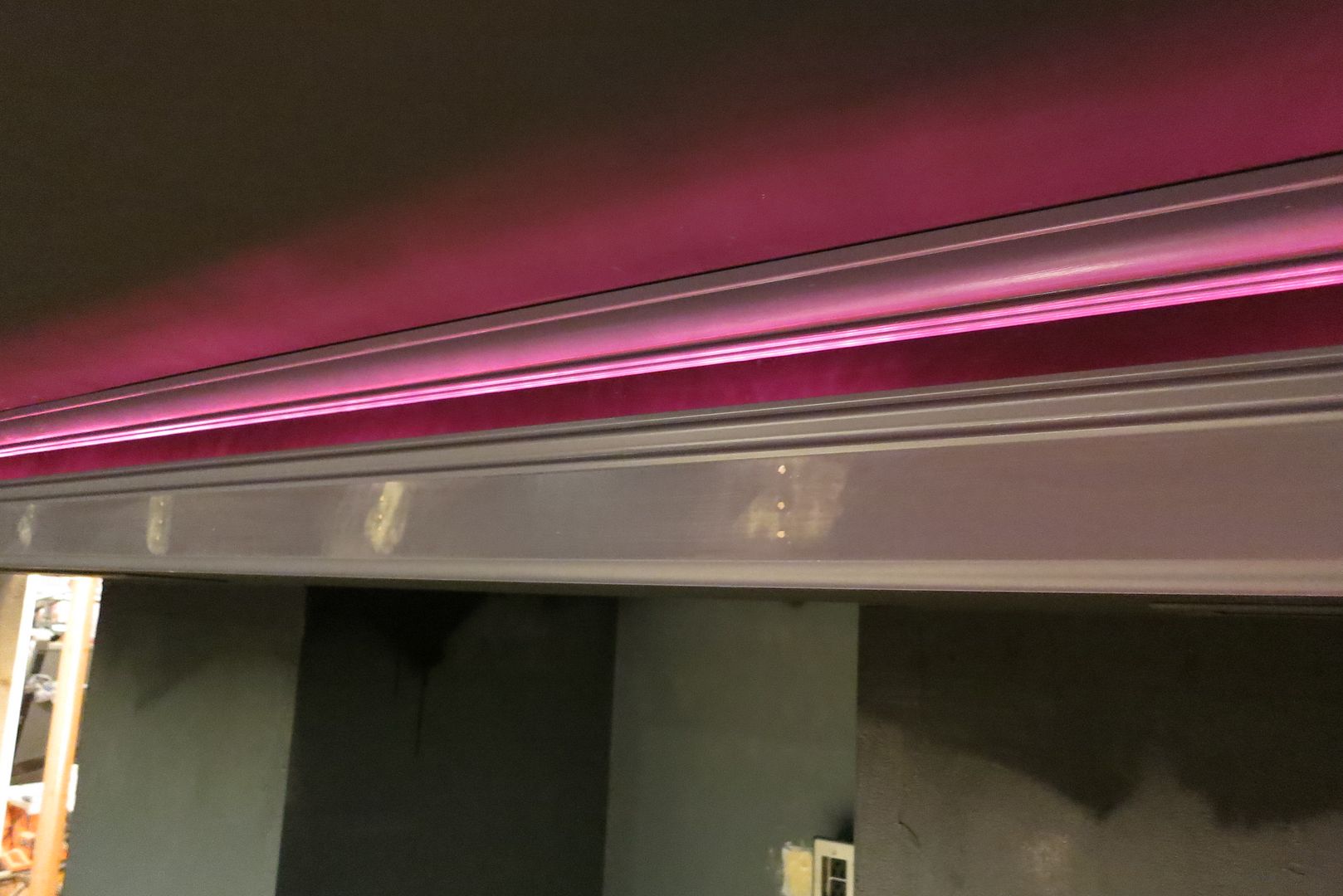

Some more details of the light tray.
The outer edge is two pieces of molding. First an upside down base molding
Then a smaller piece for the upper edge.

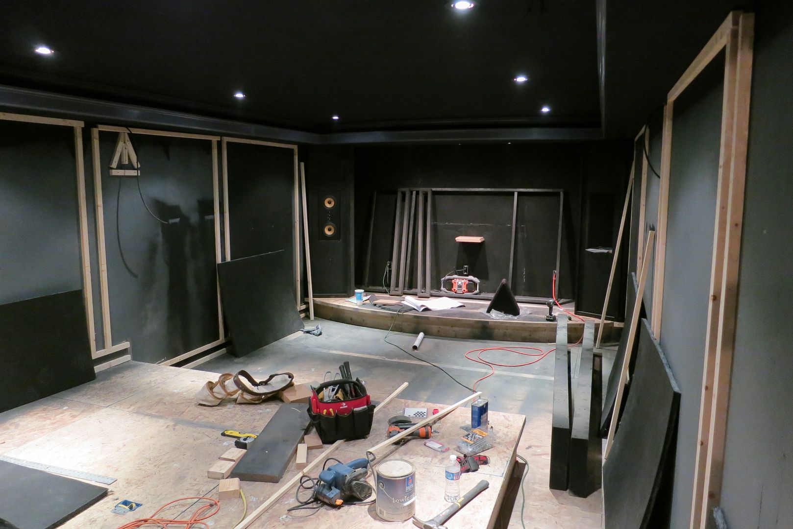

Works starts on preparing for the acoustical treatments and fabric install

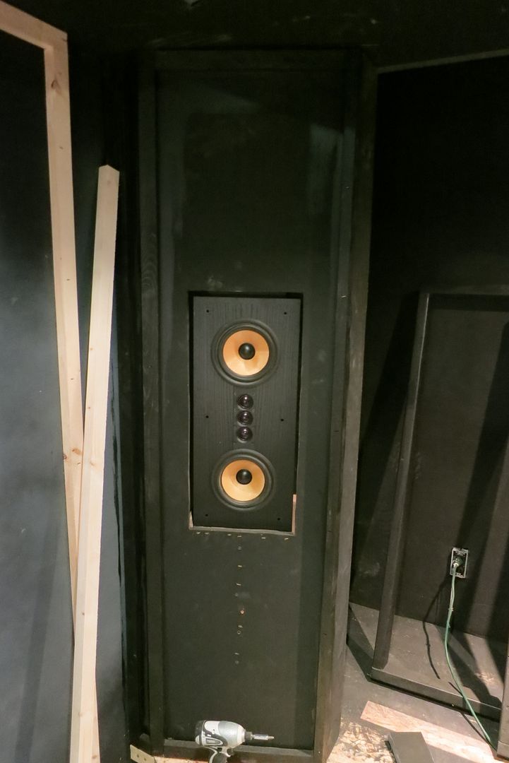

test fitting of the speakers
Just as I left tonight
Should have some good shots tomorrow as the finish details start coming together.

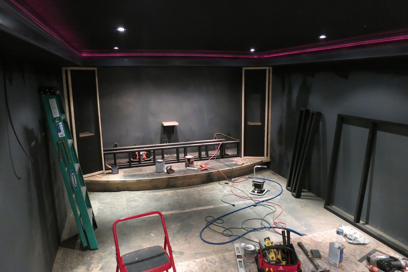

Just some quick shots. I will backfill with explanations later after the last push to wrap this up.
