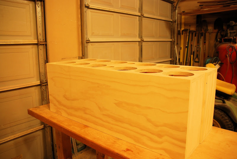

Since I cut 6" through holes, the 3/4" shelves had a little overhang, which I smoothed a bit.
