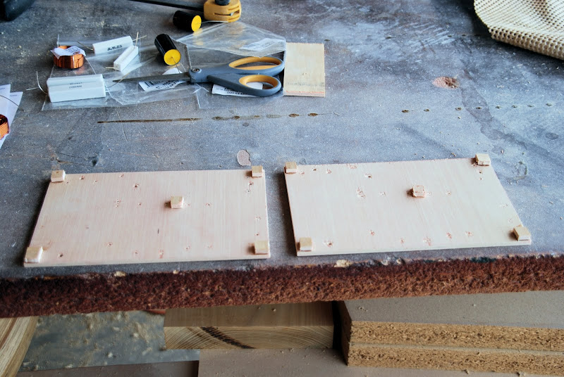

I upsized one pair of coils, so I could get some that were in stock, since I was in a hurry. If yours look different, that's why.
I epoxied some small standoffs on the underside, to allow room for wires.

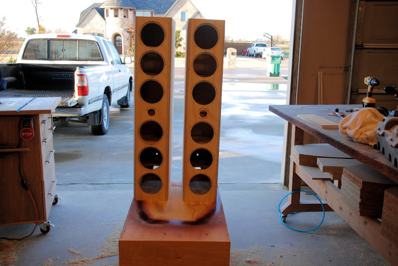

As always, an excellent job em......Dusty! Coming from my days in the profound field, corrugated metal grills and Duratex should do the trick. They'll bring less attention to themselves on stage and should be durable enough to last a few years. And before you finish em don't forget pole mounts, recessed handles and corner guards!
post #97 of 253
Thanks for the useful tips, Mahyem13.
If I can get the Duratex locally, I may go that route. I'm pressed for time though, so handles, stand mounts and corner guards might not make it. Hopefully, the recipient can take care of the final touches as needed.
post #98 of 253
No need to do it yourself as it requires a special gun and it's messy. Just take em to a Rhino Liner place and let them do it. Hardware I mentioned can always be added later.
