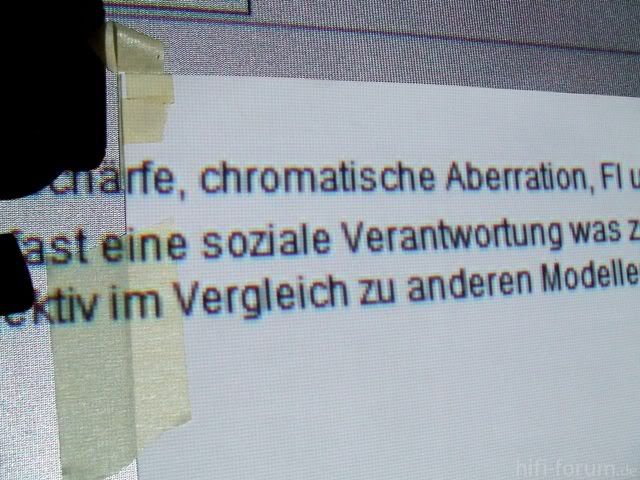

Now on to some concerns. This is my first DLP and it certainly is not as sharp
as I hoped. I have the same 'problem' as a guy from a German forum. They think it is either chromatic aberration or color fringing. I'm looking at you Coderguy for some guidance here! Should this be expected or absolutely not? These pictures are from the the forum, I didn't bother taking any of my own as this is exactly what I'm seeing. I also played with just about every setting possible in the menu, changed from floor to ceiling mount and inside out mirror, and covered all possible zoom ranges, focus and lens shift. If it is indeed chromatic aberration, do I have a bad lense??
It is not as noticeable from viewing position, but it definitely makes the overall image feel soft. This happens with both my sources, my htpc and ps3 as bluray player both through HDMI. I am really curious if this was what projector central's pre-production unit was suffering from?
Edit: updated information on this in post 44

Only the first picture with the grid pattern is useful. I'd say it's about average for a 0.7" single chip DLP. Not as sharp as the best, but not too bad. Pictures with PC text are hard to judge because of ClearType and other edge smoothing effects that's being applied to fonts. Most people don't have them turn off properly (there are multiple settings in Windows that need to be turned off along with scaling) even if they try to.

I understand the text on computer thing. I made an 800MB pic today in Photoshop and same thing. Same thing with text on bluray, and noticeable on hair (and fur) on bluray. would love to fix this part, as I am wowed with everything else.
You need test patterns specific made to test pixel level sharpness, not pictures or images of text. Then make sure you have 1:1 pixel matching (no overscan), and focus the lens. Retry different zoom and lens shift positions to find a sweet spot for the lens. I don't think there's much else you can do.

Take a pic/look at the projector's OSD menu. That is usually the sharpest of all text, etc.
