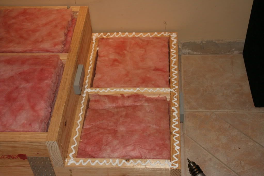

I stuffed the pink shi.. STUFF into the colums to fill the hollow...hollo...holl..... echoing boxes. Hopefully this will make a difference to the overall sound of the room.
I stuffed all the columns' tops and bottoms. I used this brackets to fasten them to the walls onto the strips of MDF that I previously stuck to the walls. Worked great!
Here's the pics of all the columns covered, stuffed and fixed to the walls - hurray eventually this part is done.

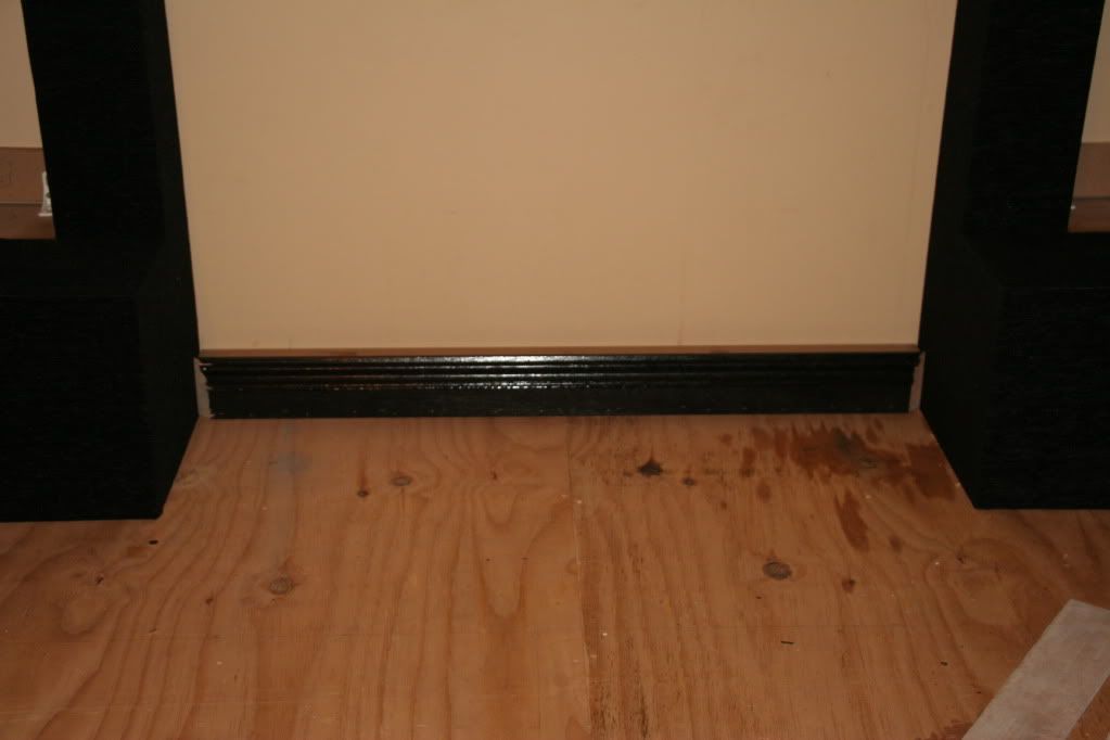

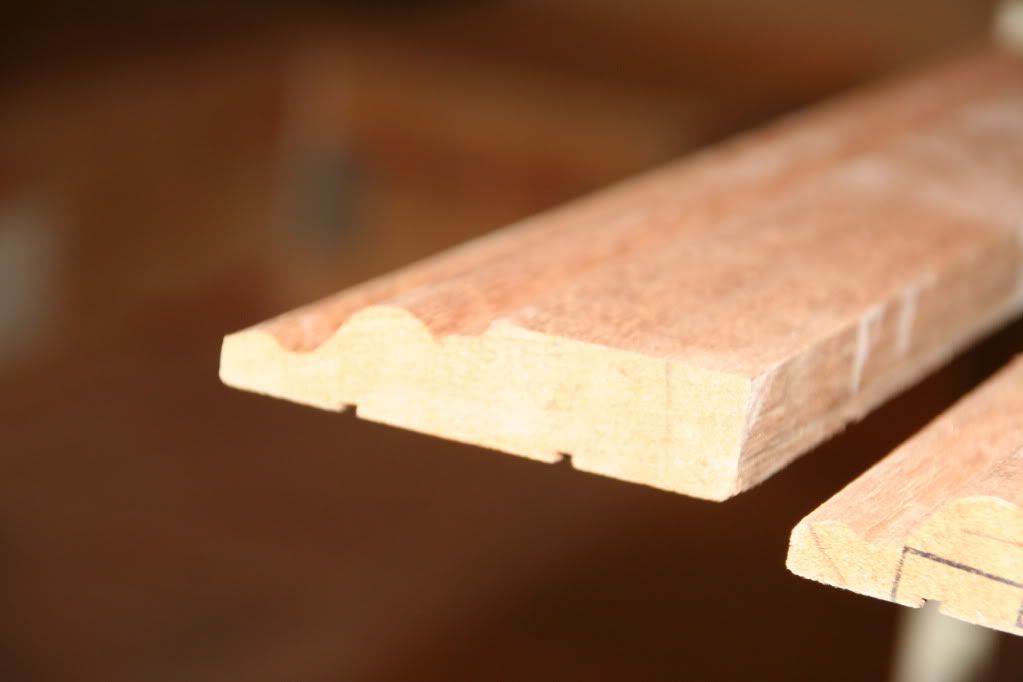

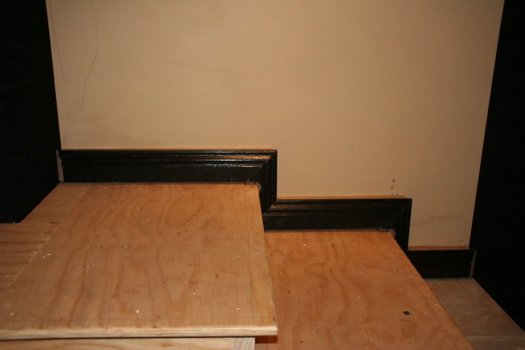

I got the skirtings and painted them ....... yes?......BLACK!
Here's one of the profile:
All painted and busy drying ... and I'm a little high from the fumes.
And a close-up:

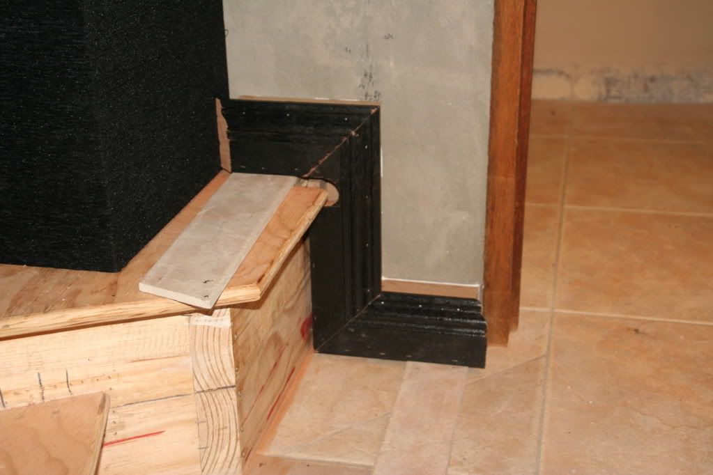

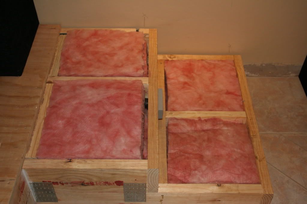

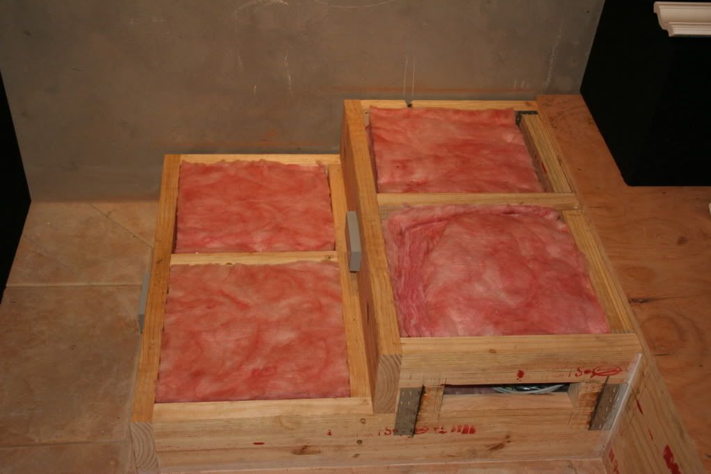

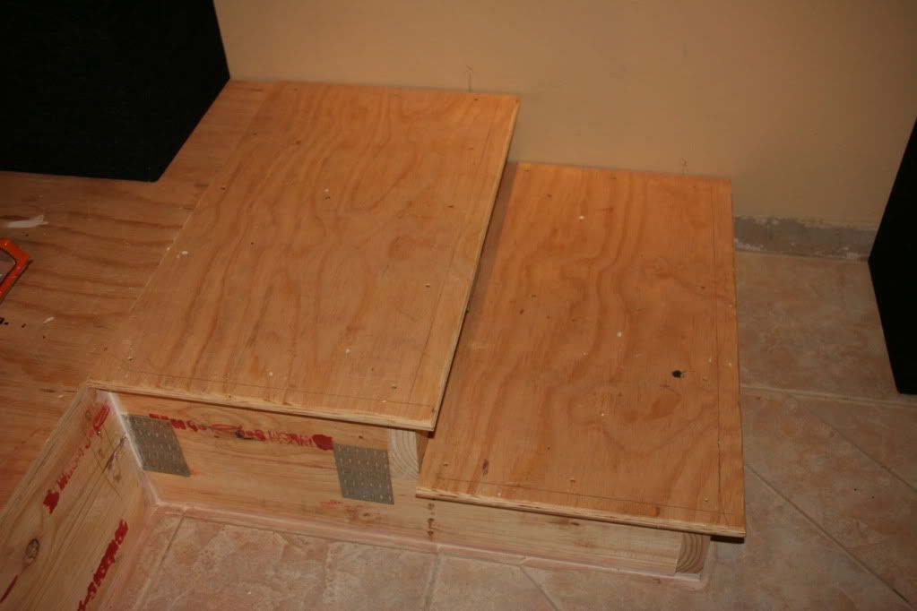

The steps also got closed-up. I stuffed them with the Itchy stuff and sealed and screwed them tight.

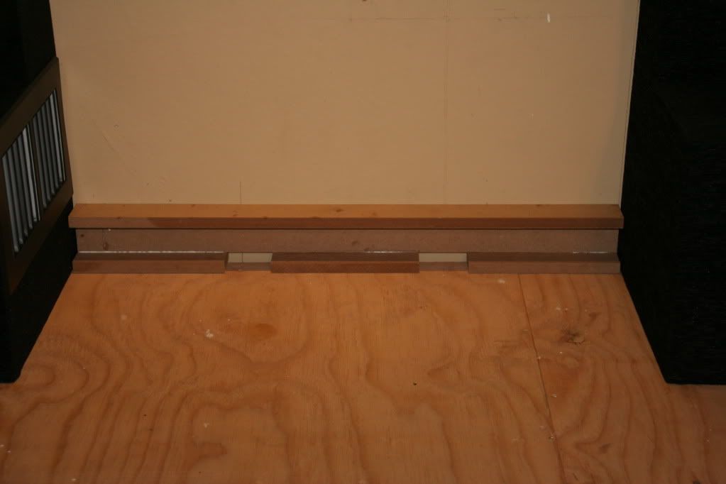

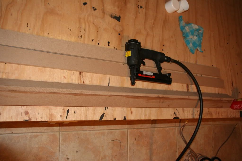

The skirting needs to be away from the wall because the fabric panels will be 2" thick and rest on wood strips just behind the skirtings, so that it looks like a normal wall. To accomplish that I had to make a kind of backer-box thingy to keep the skirting from the wall and from the floor in order for the carpet to be tucked under it. This is how I made it:

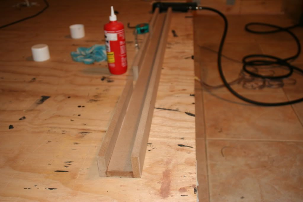

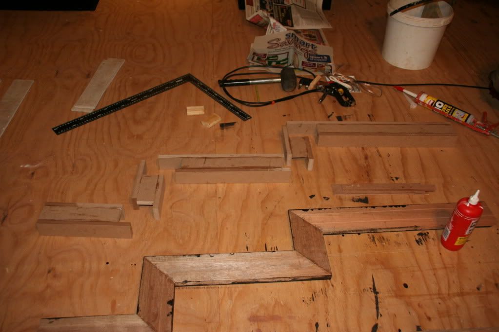

First I glued and nailed two strips of 2" broad MDF toghether:
And then I glued and nailed on shorter strips like this:
And it ends up looking just so:

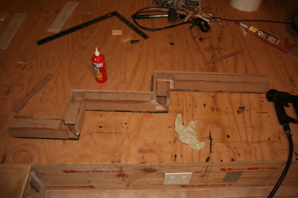

Here it is just put in place to see if it'll fit
And the skirting put against it:
"This is the way we stick the glue,.. stick the glue,.. stick the glue! Early in the morrrrnniiigggg!"

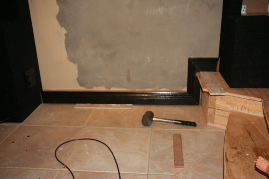

If you look again in the picture above, (in case you've missed it), I've used 2 floortiles as spacers under the skirting to leave the gap for the carpet - (as instructed by the guy that'll lay the carpet)

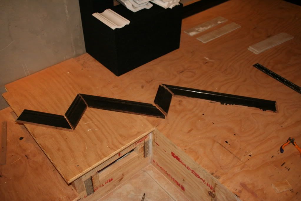

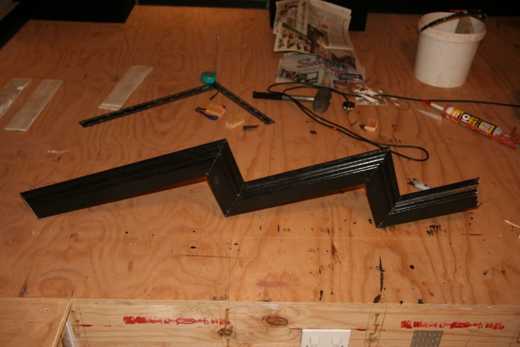

For the skirting at the stairs, I've stuck the skirting together first, and then made the backer-box to match.

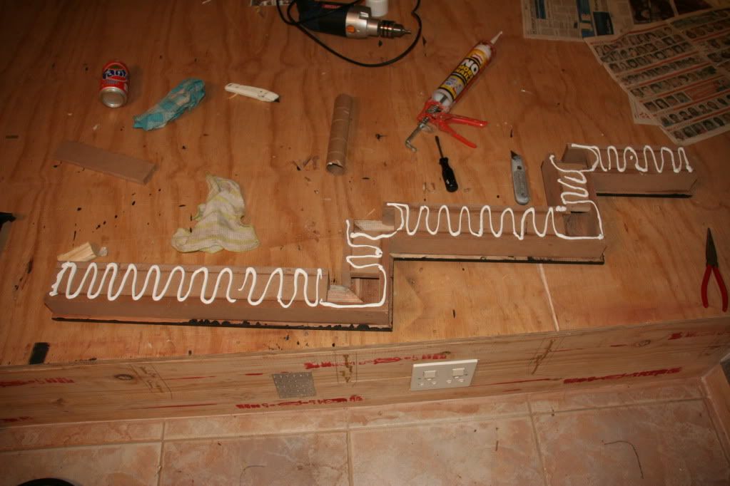

The next step came because of my own stupidity. I thought I'll save time and effort by just letting the carpet butt against the skirting where it will go over and under the steps, but the ANAL-ist in me drove me to just do it propperly and cut out the gap for the carpet to go under it as well. So, after the whole skirting-backerbox contraption was stuck and nailed toghether, I had to wangle it under the big standing drill and use a hole-drill to cut a hole and the use a box-knife to cut away the rest to get it to look like this:
The staples is just to keep the seams together while the glue dries and will be taken out. Lot of liquid nails to keep it stuck forever hopefully.
And stuck to the wall:
And the other side as well:
The little piece at the stage by the door:

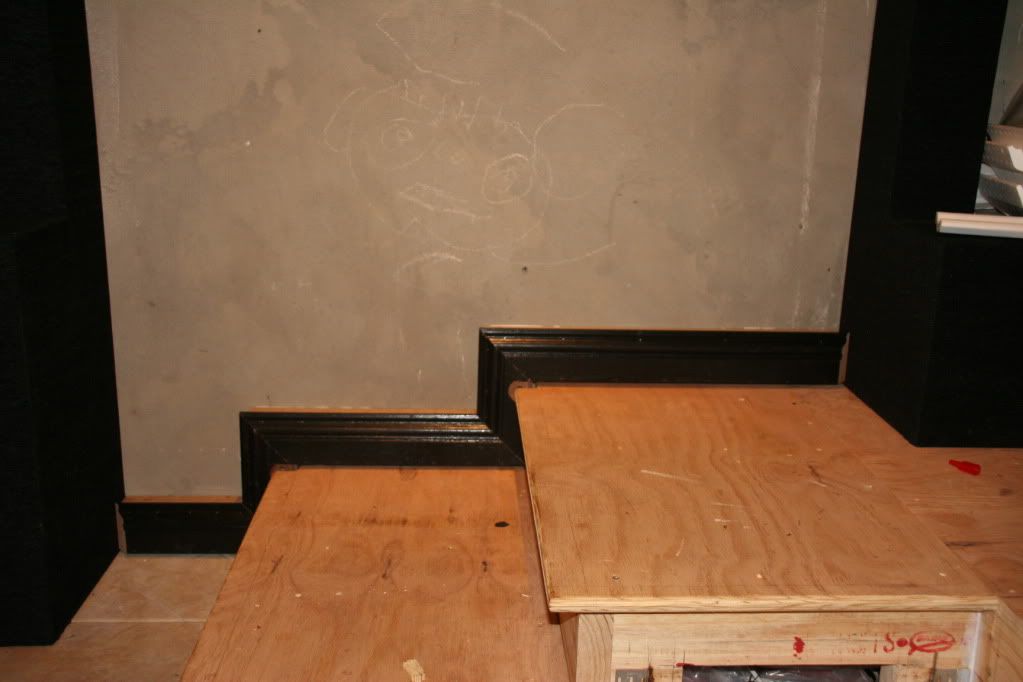

This is the opposite side to the door at the stage. I used a rubber mallet to lightly tap the skriting so that the glue will stick propperly to the wall.
All the skirtings will receive a final paint layer after the gaps are filled and edges smoothed.

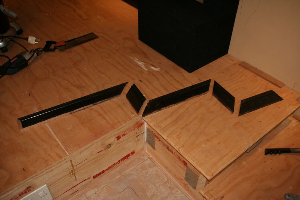

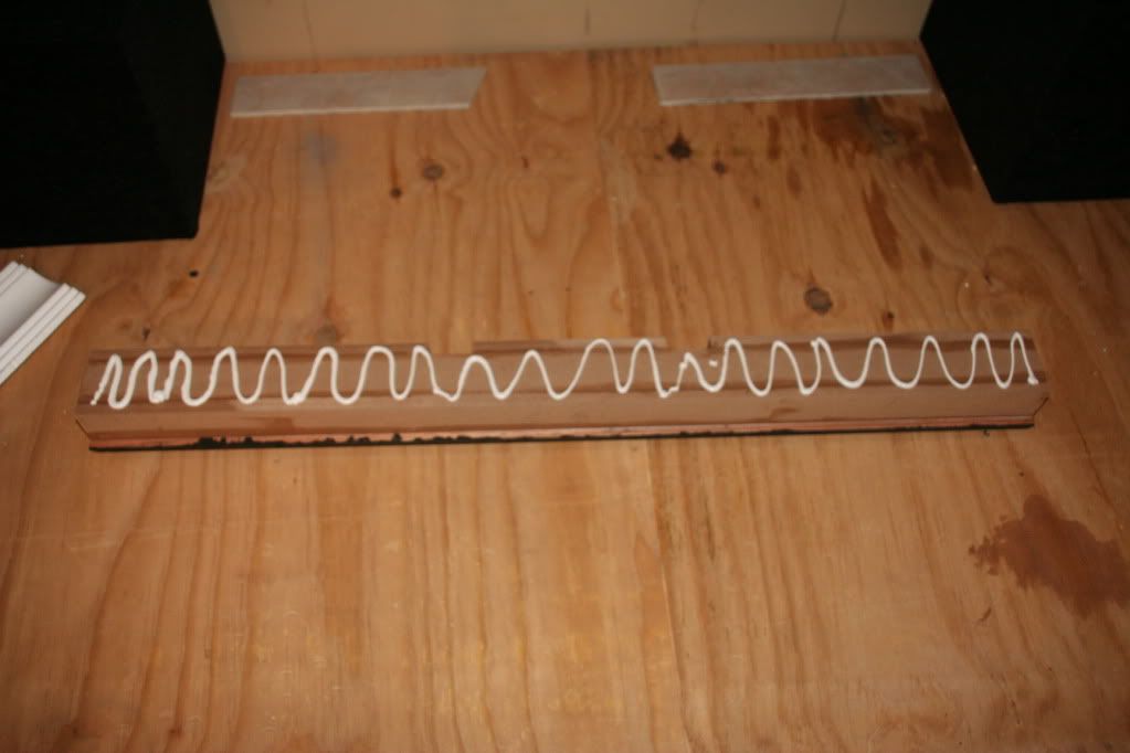

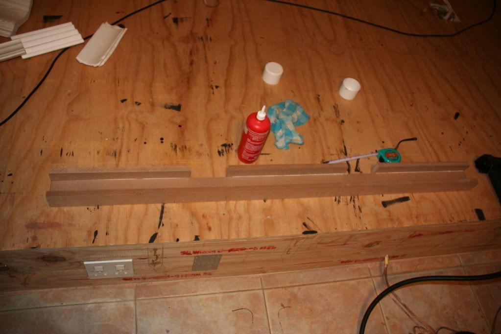

Here's the beginning of the skirting that will go on the stage:
Pardon all the stuff lying around the place. It's starting to look like a rats nest again
I made the skirting in one long piece (4.2m) and put it on the stage.
I used hex-screws (I think that's what they are called) and screwed the whole thing tight to the stage.
Here are some pics of the skirting finished and painted around the room:
And on the stage:

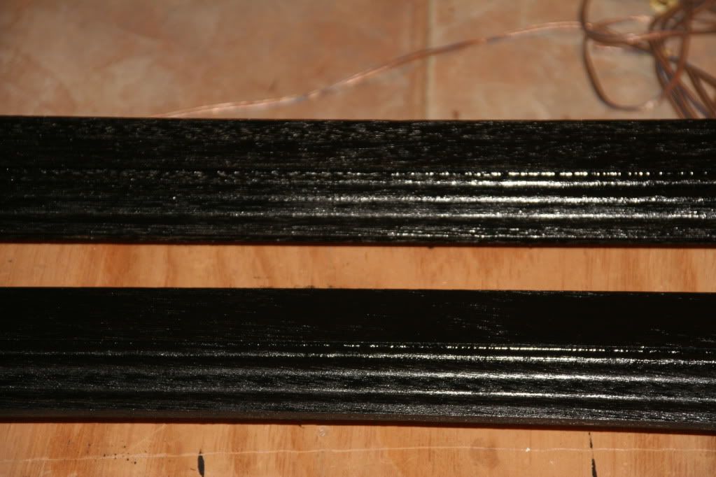

I got the cornice (crown moulding) as well. After looking at alot of samples and asking the wife's input, we decided on this pattern:
I think it will look nice together with the square shape of the columns and the little blocks on the cornice.
I got 14m - hope it's enough.

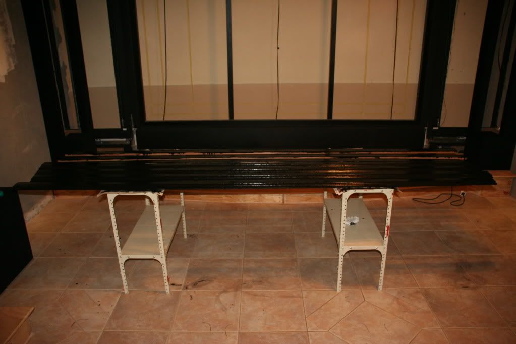

The cornice all lined up , waiting to be blackend.
Those little squares sure do look nice, but boy, what a pain in the sphincter to paint. The paint collects in the little pockets and must me brushed out with the paintbrush. I managed to put one coat - lets call it the undercoat - on and let it dry. I'll do the rest of the 58 coats later when I'm in the mood for painting again.
I hope I can cover these things with 3 coats at the most. We'll see.....
First coat on and busy drying.

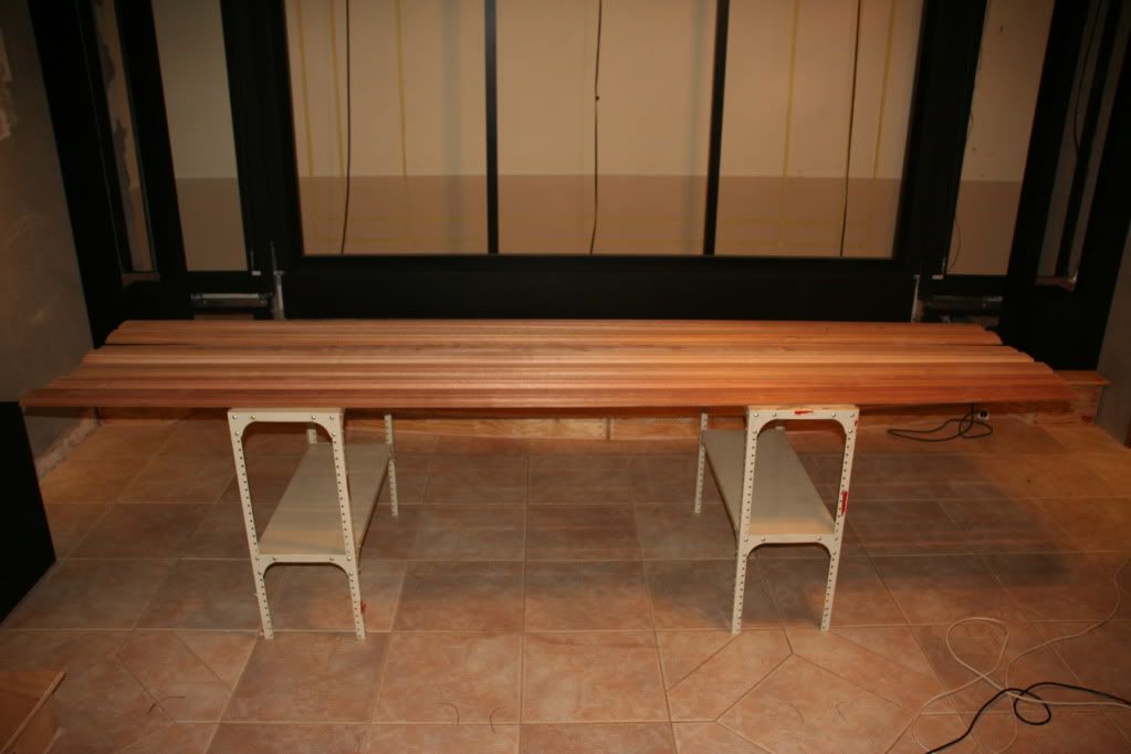

Just when I thought the end was in sight ....... Oh noooo ...... another BIG woodpile:
Here's a shot of me standing next to it for scale!!
It's the MDF strips for the fabric panels.
