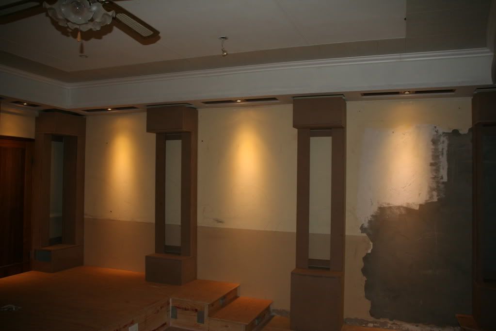

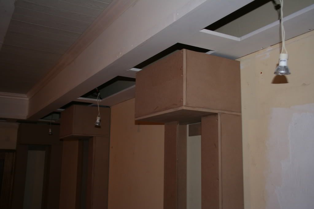

I see there's something done that I have'nt posted the pics of yet. Here is the front left and right columns in place. You'll note that they are basically the same shape as the rest of the columns, but only a bit narrower as to not overpower the stage and screenwall. Also their grilles will be on a 45 deg angle angled towards the screen - something like this [/ \\] to "pull" the eyes toward the screen.
And here's a shot of the whole screenwall as it looks with columns.

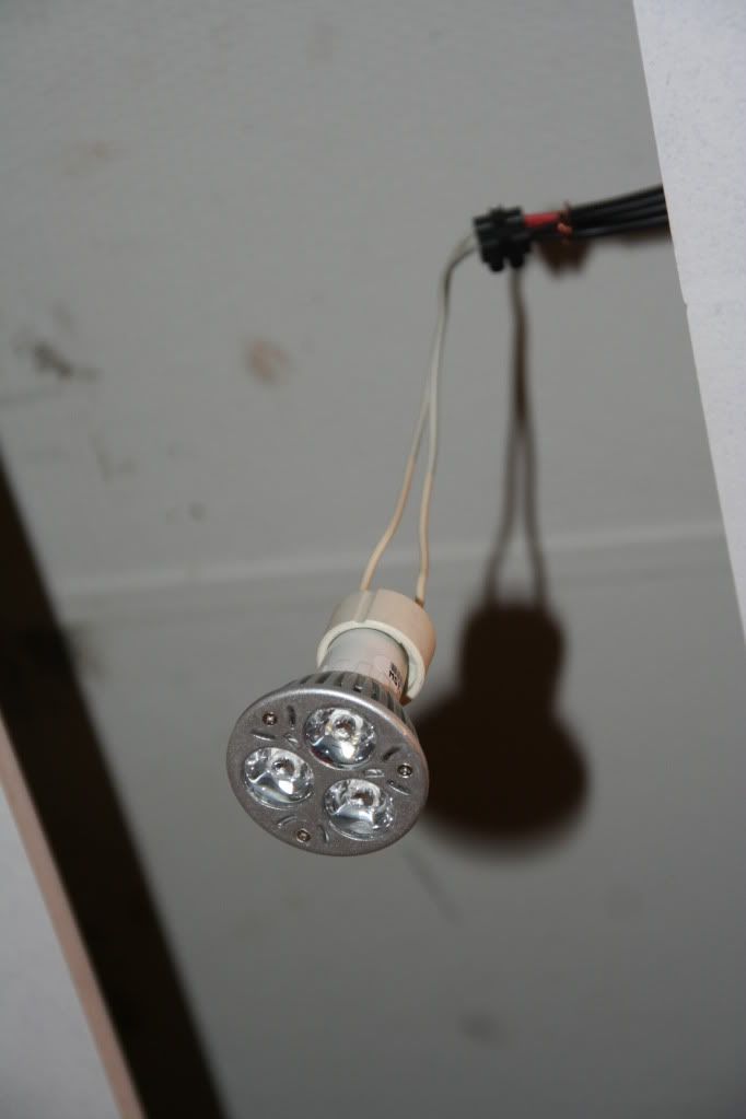

I got a nice surprize this morning when I arrived at work this morning. My LED downlights have arrived. There's 15 of them - 3w 220v dimmable 3 led. The sales lady said they were equivelent to 40W halogen lights in brightness. I opt for the warm white ones since I don't like the white light that LEDS usually cast. I'll check them out tonight as soon as I get home.

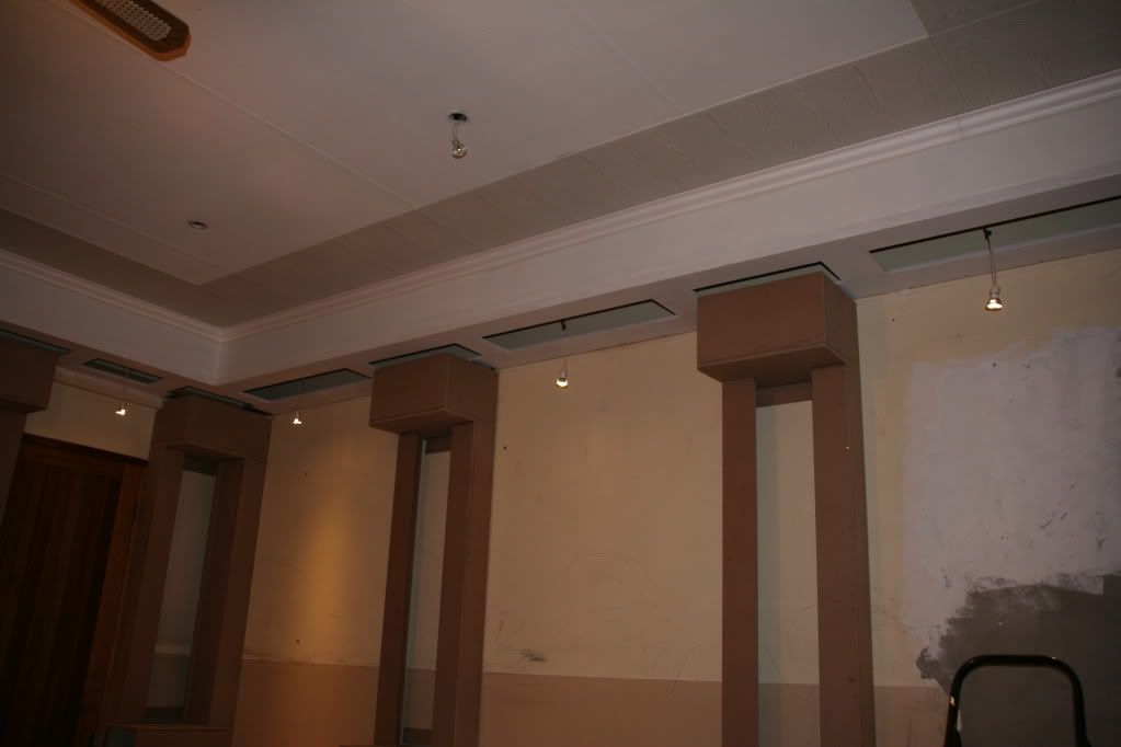

Here I put up the styrofoam ceiling panels to cover the ugly nutec ceiling between the soffit and where the star ceiling will go, and also, you've guessed it ....... styrofoam cornice. Yes you've read correctly STYROFOAM. It seems here in SA we don't care much about safety and combustable building materials. If there were a fire, God forbid, the ceiling will be gone in a FLASH but luckily my brick walls will still stand
And a close-up of the tiles and pattern on it.
I'm not sure if I should paint the woodgrain pattern or leave it as is. I think there must be a light colour for the strip lights to reflect of, not so? What do you guys think? I'm thinking of leaving it as is and keep the side of the soffit white as well. I don't think there will be much reflecting from the screen since it wil be in an "alcove".

Finally, all columns back in their spaces and the room cleaned out. From now on all cutting, sanding and dirty jobs will be done in the garage and not in the room any more. Fabric and dust don't go well together (hope I can keep the place clean)

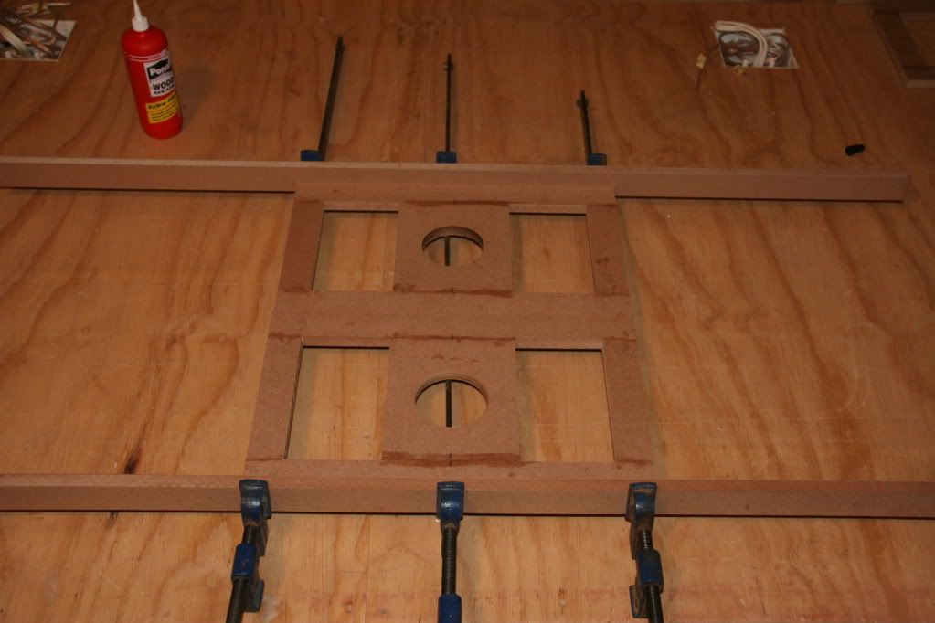

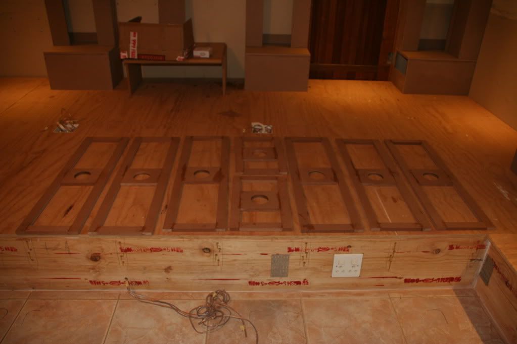

I've been busy with the downlights and their panels. Here's some pics of the downlights all wired up and ready for the panels.
And here they are working.

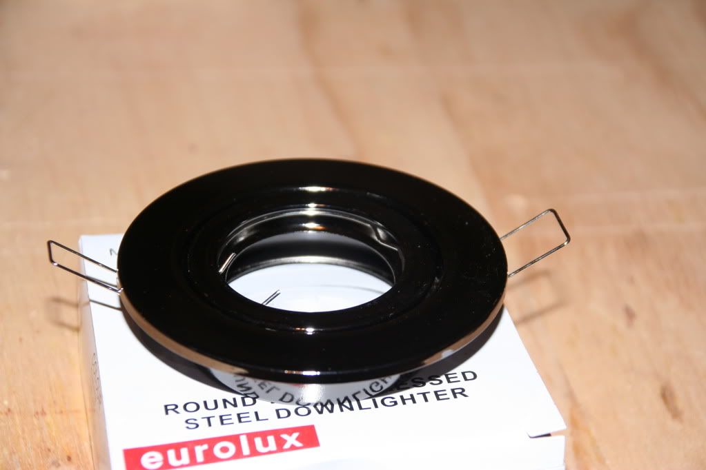

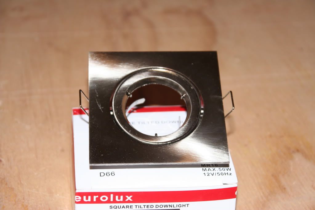

This is the downlight holders that I got. The 8 under the soffits is square and satin chrome, while the 4 under the proscenium is round and gun metal colour.

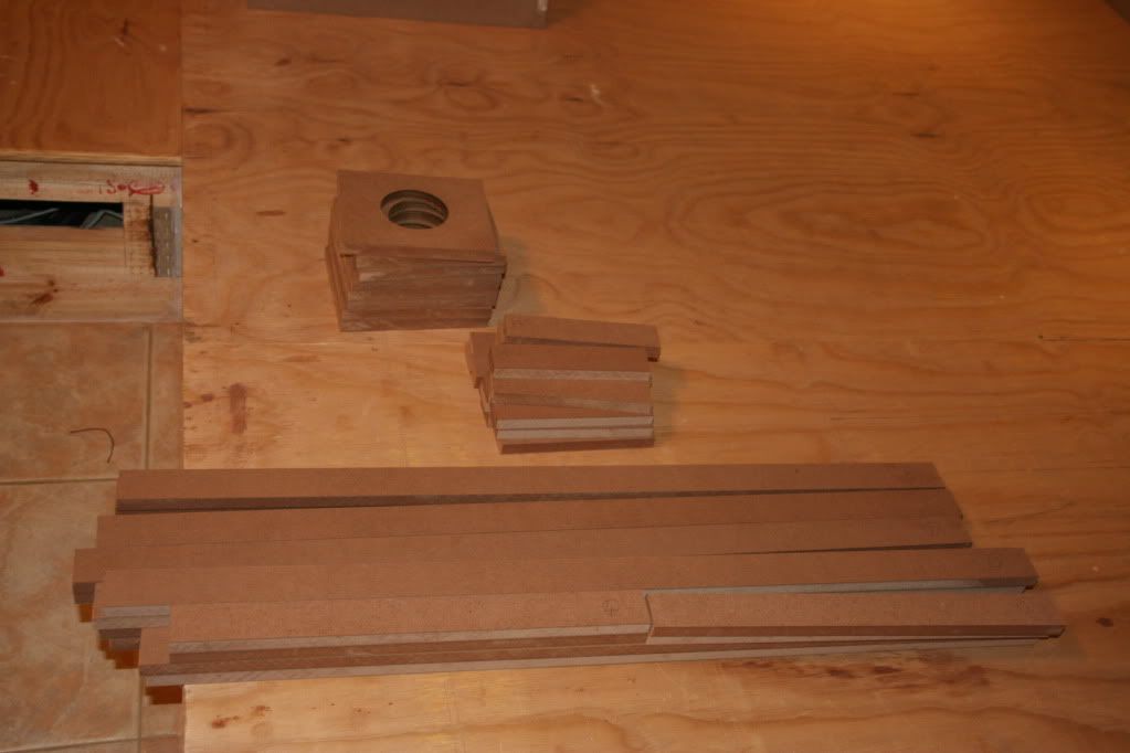

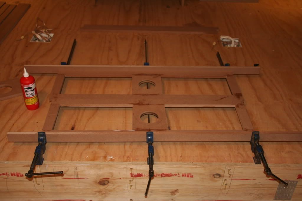

The pieces of the frames is cut form MDF and ready for assembly. There is 6 long ones and 2 smaller ones.
Here's the first two being clamped:
And here's the two mini-me's in a thight situation!
After whatching glue dry for a while, eventually all frames are ready for the next step.

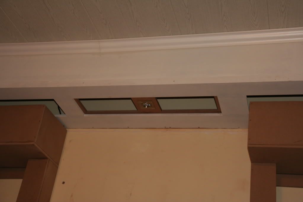

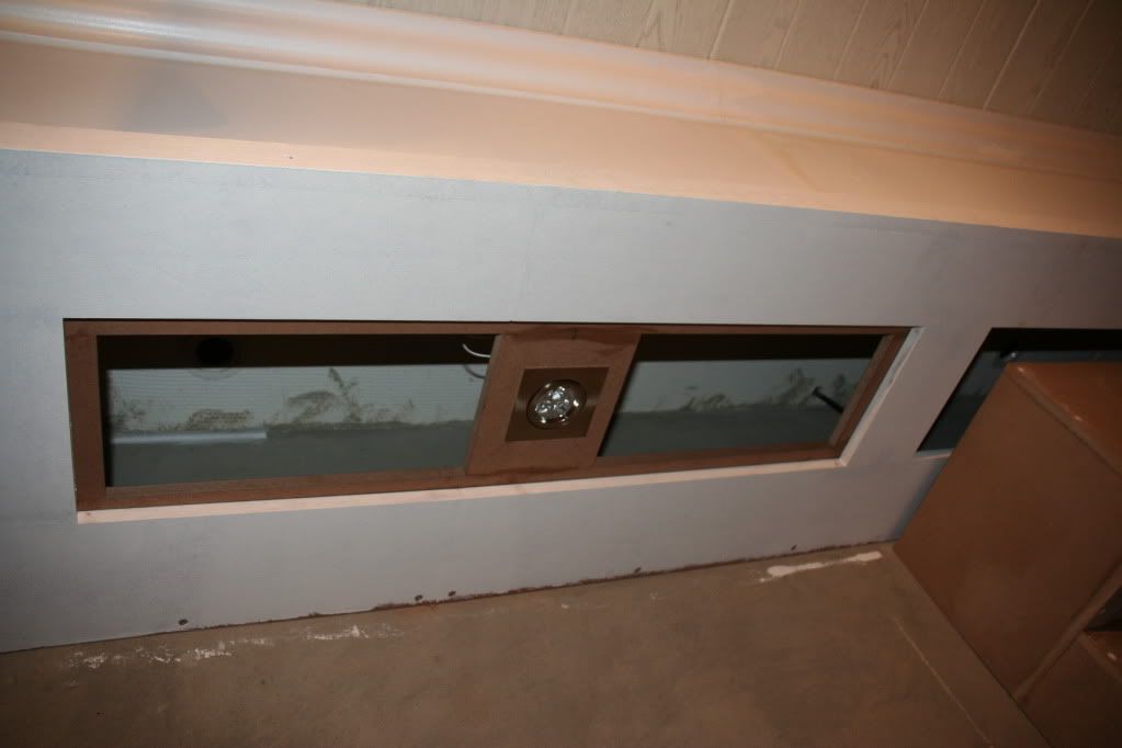

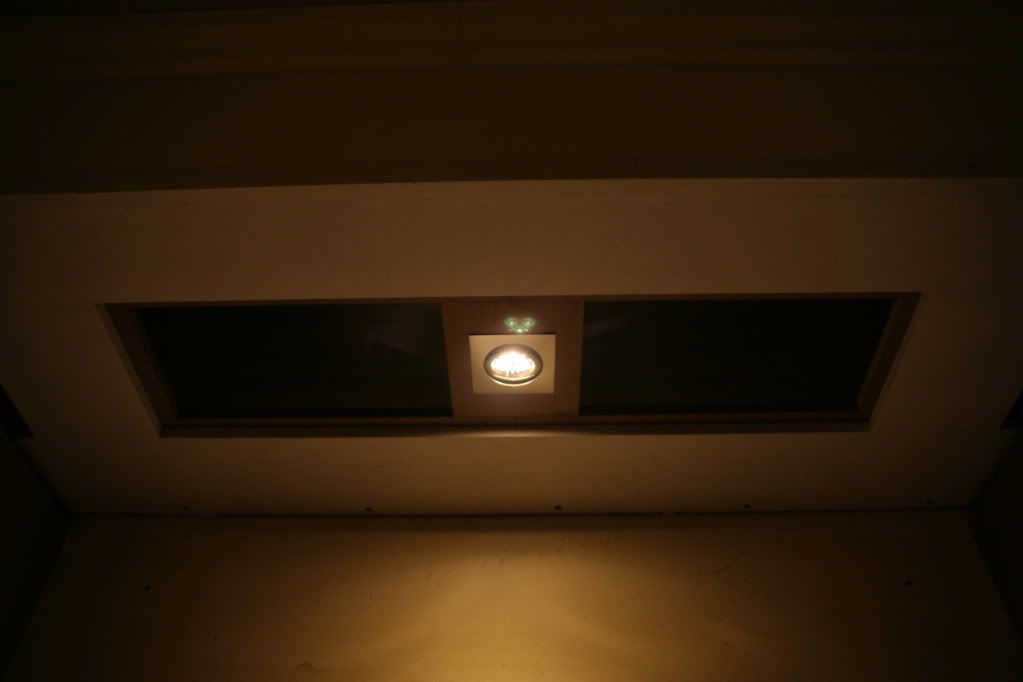

All the frames will be covered with black velvet at a later time. For now I put the holders and the lights in - I'm very happy with the results
I've angled the lights towards to wall so that they'll light up the wall panels later.
And a closeup in the dark.
The lights illuminate the room quite nicely now, but I think it will look much darker when about everthing in the room is black and the only other colour will be the red panels. I hope it's not too dark. The reflection of the light from the proscenium downlights on the screen will also light up the place better I think.
