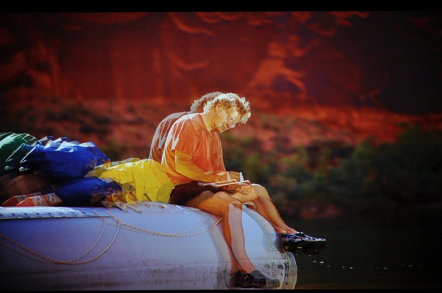

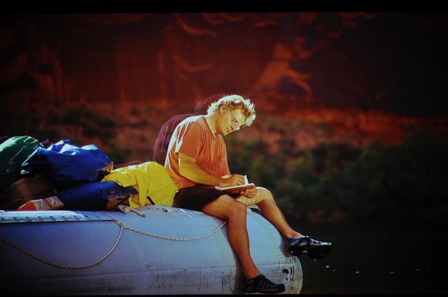

post #299 of 363
this is a particularly tough scene in Grand Canyon for the JVC's.
