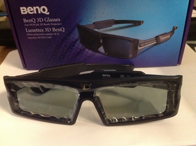

The new style Ben Q glasses arrived today. They are very light and comfortable (I wear prescription glasses). The lenses look slightly larger than the ZD201's, I'll have to compare them side by side when I get home.
Overall very nice construction with an easy to access power button.
The real question is, are they going to perform the same as the ZD201's in regard to the ability to completely block the red flash from both lenses. Peter Gabriel's 3D concert is very easy to see this with since it's a relatively dark stage concert with a lot of dark areas of the screen.
let's find out tonight how they compare.
I decided to charge these now so they are ready to check out tonight. I noticed the instructions state 'Only use the including charging cable, other cables may damage the glasses'. It's not the typical microusb blackberry type charger, it looks like this:
These might be the lightest glasses in my collection. They weigh 38.5G or 1.3 ounces. The Sony glasses are 59G, ~ 2.1 ounces. The ZD201's are ~ 50G.
speaking of the ZD201's, they keep going down in price, almost the same price as the new BQ's. I'll know in 10 minutes tonight if these are as good as the 201's.

that took a lot longer than 10 minutes. I'm seeing some strange behavior with the new glasses that I need more time to evaluate.
all following comments are regarding the glasses ability to block the red flash. With my HP screen and the brightness of the W7000 in 3D, this is very noticeable to me in dark scenes with the various glasses i've tested.
The new BenQ's on first impression seem to leak more of the red flash through than the other glasses i've tested (including the original BQ). It's easy to test, just pause on a dark scene (space scene in Despicable me is good to use) and A/B the glasses at the same time.
The ZD201's are excellent at blocking the red flash in both lenses. I have several pairs, it's not unique to a specific sample. There is something special about the lenses they are using that completely blocks all signs of the red flash.
I'll test it more this weekend. It's a shame because they are very comfortable and light weight, plus have a great sync. But seeing red flash leaking through the lenses is going to drive me nuts when I know the 201's are perfect in this regard.

These look identical to the new BenQ's, even down to the power button location and style. It's likely that BenQ and Viewsonic have OEM'd them from the same manufacturer (the same way Optoma and Monster licensed the same glasses from BIt Cauldron)
I haven't had a chance to revisit my findings from the other night, I'll get back to comparing the glasses this weekend. It's looking like the ZD201's are going to be the king of DLP link glasses for a while though.
