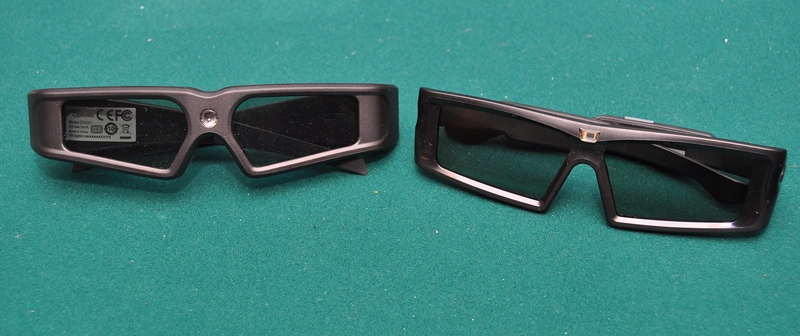

Been reading about 3dtv dlp glasses they claim no white nor red tint any comments from anyone? Has anyone tried these?
I think they all claim to block the red and white flash, but there are wide variances as to the actual performance of the glasses.
The ZD201's are ~$100 and are the first pick to match with the W7000. The less expensive True Depth 3D's are the 2nd pick due to comfort (large lenses for prescription glasses) and very good ability to block the red flash.
These are the ZD201's next to the new BQ glasses
The glasses in the back, left side is the True Depth 3D's.

Zombie10k, for me the ZD201s tend to fall off which is why they hurt as I cram them on. Not huge deal as have watched only a few 3D movies and may get wraparound connector and performance very good. Do see the True Depths have bigger lenses which would be nice for my prescription glasses. But (for bigger heads) do the hooks at the end help keep them on the ears better than the ZD201s? And are the arms longer to get around the ears?

The True Depth 3D glasses are larger and better suited for those with prescription glasses.
