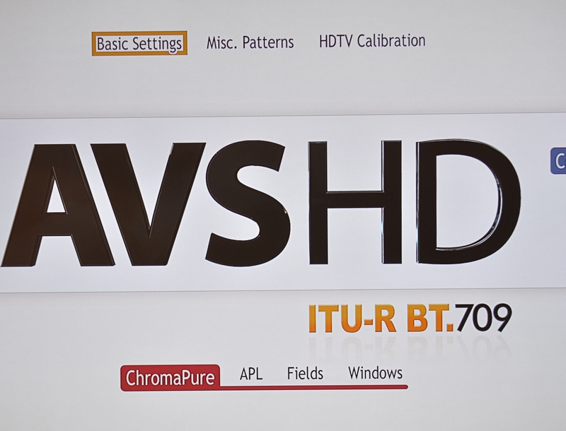

I went right for the single pixel test on the AVS HD disk. I could tell right away it was fixed when the main menu for the AVS disk was on the screen. it's a big difference from before, especially on a nice sized 142" screen.
So far, this is looking great. I put on the 'Art of the Flight' which is reference quality source footage to show the best (or worst) of any projector. It looks great on the W7000.. finally!
