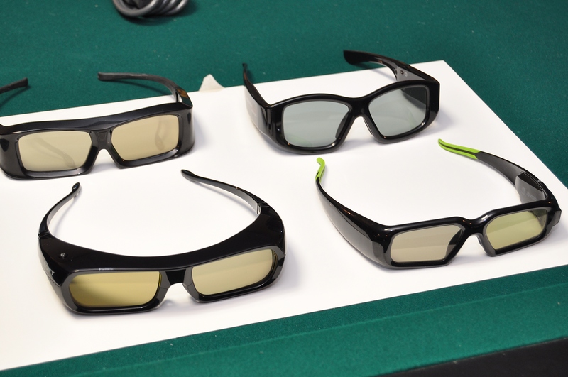

Elkhunter - it's good that the projector worked for you. I thought you'd like the brightness with the torch mode on the HP screen.
it sounds like the MV3D's are your only choice. These are pretty big compared to all the other glasses including the Epson's. They have come down in price and I recently tested them to work fine with the 5010.
The MV3D's are in the upper right.
regarding 3d glasses, are the MV3D glasses the same as the optoma glasses used with the HD33 and HD83 (8300 in states) if so will they work with the HW30 and W95 from Sony? with regards to the PS3 glasses can't seem to find them on best buy for $50, cheapest at $69.99.

So is the consensus still that the best glasses for the 5010 are Epson's own glasses, or has that changed over the course of discussion?
While I am waiting for my Himedia 900A to get here, do I need anything more than either PowerDVD 11 and/or TMT5 (along with an Nvidia card, of course) to play back 3D? Or do I need some other software to make this all work on a PC? I already have DVDFab Passkey installed, along with Slysoft's virtual drive software (I forgot what it is called) for reading ISOs, so I think I am good to go, but I just want to check to be sure...
Hi, it's been confirmed that the Optoma glasses and the MV3D's are the same glasses by the manufacturer 'Bit Cauldron'. You should have no problems with them on the HW30 or VW95.
Bob - I think it's a matter of comfort and fit. The MV3D's are larger than the Epson's and might be more comfortable for those with prescription glasses. They both have similar performance.

One thing that annoyed me with my Optoma demo was the Glasses rims. Is there
a better brand glasses that are bigger that can be used with the Benq?
One other thing that hasn't been discussed is the signal sent by emitters. I
have heard that they can play and mess with other equipment. Is that still
happening?
I thank any responses in advance. In NZ we are really starved for info as there
are not many here with the HT addiction.
Thanks Dono

Originally Posted by Badas View Post
Hi Guy's,
I have been reading this forum with a lot of interest over the past few weeks.
Firstly I have to say it is great reading and thanks for the great effort put into
it.
I have been wanting to make the 3D leap into my HT, but have been very disappointed
with the projectors on display.
I have seen last years JVC (X3 I think, base model). Way too much flicker and ghosting.
I hated it. I thought I will just stick to 2D.
I then viewed recently the Panasonic 7000 and was shocked this got great reviews. I thought the
3D was terrible.
I just about gave up totally when a staff member told me to try the Optoma 33. Wow for a cheap
projector I was impressed. I then went back and viewed the 83. I watched for over an hour and
didn't see any ghosting or flicker. I now want to put something in my room.
I have a great 2D projector. Cineversum Blackwing 3. Based on the JVC RS40.
It really blows me away and I am super happy with it. So I was thinking of running a 2 Projector setup
adding a projector just for 3D (will never be used for 2D, so I don't care about 2D performance).
I am from New Zealand and we really are in the middle of nowhere. Optoma is the only DLP
brand sold here. We don't get Benq.
So here comes the questions.... Is there no Love for Optoma in the USA as
I really don't see much discussion on them?? Is there something wrong with them?
A lot of discussion here has been on how ghost free the Benq is. Is it similar
to the Optoma? Because they are both DLP based.
I am going to take my kids to Disney Land this year. Soon. So I was thinking of
picking up the Benq and putting it in my bag to take home if it is that good.
happening?
Thanks Dono
You should add the Epson 5010 (or 6010, but not the 3010, which apparently ghosts much worse) to your list for consideration. IMO, ghosting is simply not an issue with this projector. It may not match DLP's almost completely ghost free image, but the overall effect is solid, smooth and as "real" looking as I've ever seen in a 3D display. YMMV, of course, but if you can, try to audition one before you buy something else.
