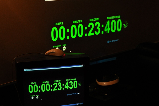

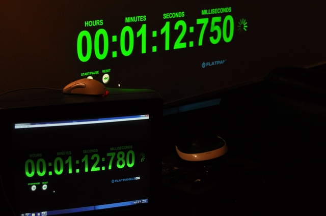

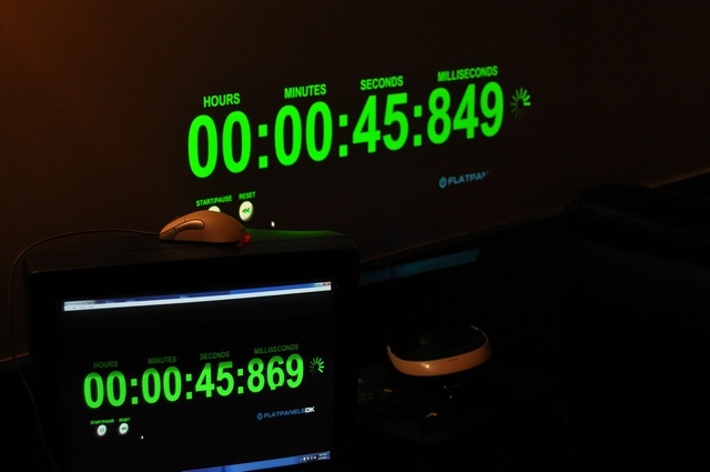

Thanks to WhiteTrash66 for recommending the 'Gaming' Mode. I've often skipped over this preset and don't think about it much.
I went back and did 10 samples. The average is now about 30ms in 'Gaming' mode. When you change this mode, the screen flashes for a second, almost like the processing is changing. Colors on my HTPC still look fine, I don't see any real difference in the image.
There were some 20's and some 40's, but on average, it looks to be about 30ms in this mode.

What type of test is this and how is it run?
post #226 of 3271
It measures how fast a projector (or any display for that matter) displays the information that being fed to it. For movies, this is irrelevant, but gamers take these measurements seriously. When you combine the lag time of the internet connection to the server, the lower the ms of lag time, the better.
In fast paced games, milliseconds is the difference between a kill, or being killed.
in order to run the test, it's recommended to use a high quality CRT as the baseline since there is little to no lag on this display. The screen on the computer is split between the 2 screens. Then you take a high speed picture with a camera to capture both images at the same time. The time that the projector shows 'behind' the time of the CRT is the lag time of the display.
As we found out, different modes have different effects.
It's interesting to think that Sony might have taken this into consideration being that they also make a popular gaming console. I have no idea if there is a connection, but 30ms is pretty good.

You rock, thanks. 30ms would be fantastic. So, now this PJ goes to the top of my list!
Big thanks! This may be the tipping point for hw30 over the jvc for me...

no problem, it does look like Sony put some thought into this 'gaming' mode. Even the desktop response is quick in this mode (moving windows around quickly), there is no perceivable lag between the CRT and the projector.
game on!!
