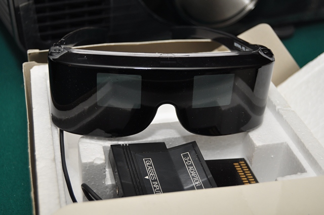

Do these 3D glasses look familiar to anyone?
These are the original active shutter 3D glasses for the Sega master system. Considering they are 25 years old, it looks pretty good with some of the 3D titles.
post #2842 of 3271
