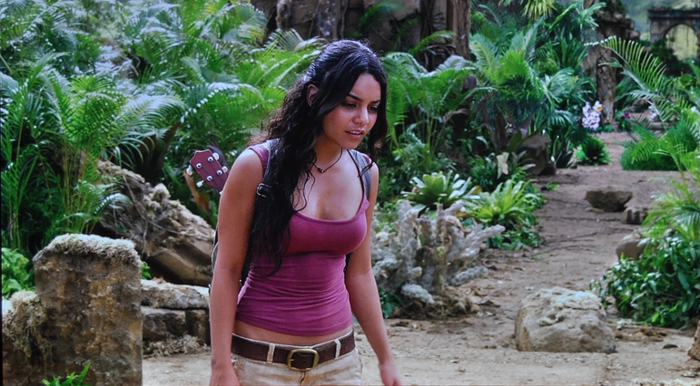

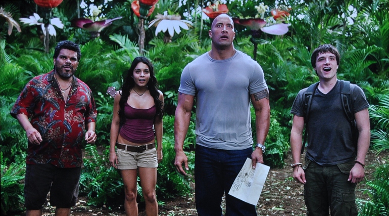

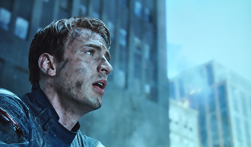

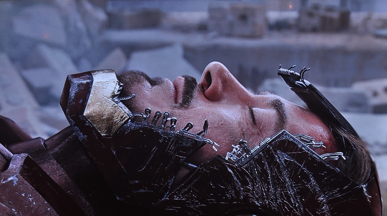

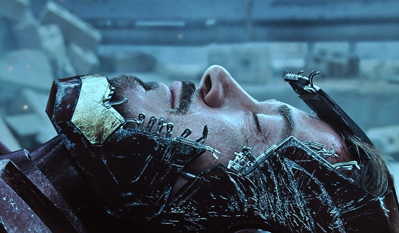

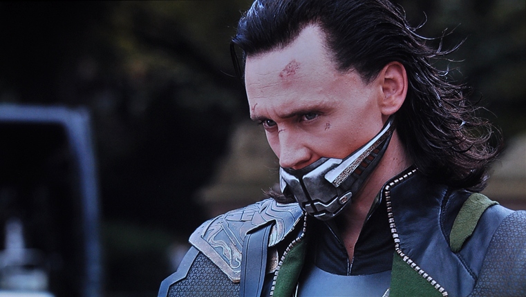

A3D - great 3D for a conversion, sound track will knock your socks off. All shots through the left lens.
It looks like your projector needs to be calibrated for 3D, the color temperature through the glasses is too high (in 9000K region). But then again I guess the image won't be as bright because red is lacking here.
There are some unique, somewhat drab colors in specific scenes in this particular film.
same calibration through the left lens. Taken right after the same viewing as Avengers 3D.
Plus the camera's white balance reacts to the tint on the glasses, etc. It looks quite nice in person.

Not to mention the other variables that affect color...
Even if we had reference level monitors perfectly calibrated, and his screenshot was achieved with near neutral color balance from the source, well you STILL can't judge colors from a single scene because the original shot in the way they have the camera setup (or just quality of the camera or settings) and the lighting affects the color. Even when they are outside under the SUN (and the SUN IS D65), but the problem is if you have anything reflecting the light or if they have a UV and ND filter on camera to film in the sun. So the ND filter is neutral (yah but probably not other settings they adjusted to the image after the filter was attached, always so many variables). Movies don't even use D65 lighting most of the time anyhow, you might have better luck with a documentary filmed outside (but even then...). You would need a scene that had a confirmed D65 image which was very carefully color matched in balanced lighting. Every time you added a new source (for instance the camera taking the screenshot), then you would need to re-match the color balance again.
So we're about a nickel short and 3-4 color balance measurements.
Also, you can't blame someone's calibration because all of our calibrations are wrong to some degree if you want to get down to it (drift + meter errors + software bugs + reflective surfaces + sat tracking + concessions we make). My projector might look a lot more accurate in a given scene, whereas in another scene it looks worse than your projector.

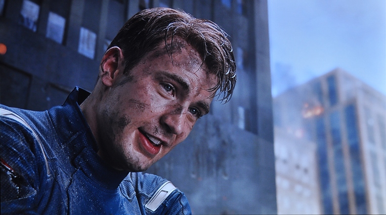

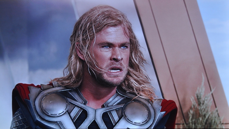

The above photo still look blueish, assuming it was shot under the blinding sun. It's only an assumption though as I haven't seen this source. But I definitely see wrong color temperature on known sources when I see one. Here's your photo against source (screenshot taken from the file):
I totally believe you it looks gorgeous nevertheless. And it may be indeed your camera WB settings (you should've checked it before posting then). I simply suggested it may look even better if calibrated through the glasses for 3D specifically. smile.gif
Edited by Elix - 9/19/12 at 8:34am

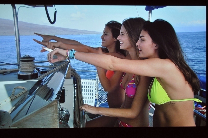

well now add the picture of the girls lol would love to see if they improve
I did calibrate behind the glasses a while ago before sending it in for the recent firmware update. I'll go back again and check. The screenshot does look more blue than I am seeing in person, I think the white balance is being thrown off by the tint on the lens.
btw, I posted to show lack of crosstalk, etc. Capturing accurate color behind the glasses is a challenge.

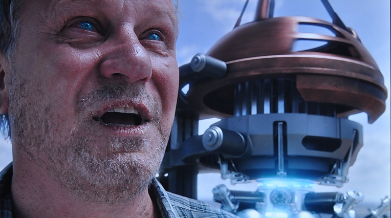

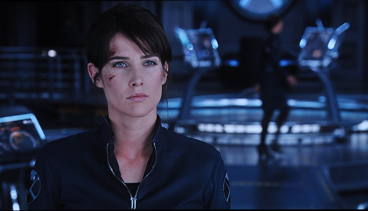

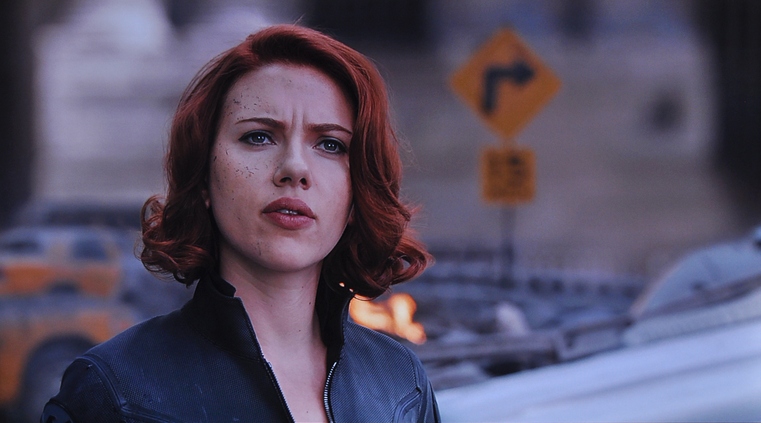

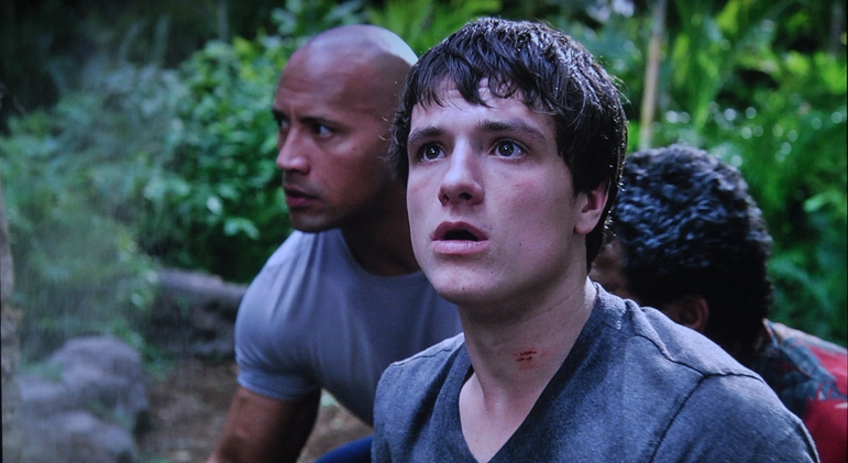

Elix: I went back and did a quick recal through the glasses. I have a test disk that displays a 100% IRE in 3D mode. Color looks great through the glasses.. very close to a D65 cal in 2D mode.
I white balanced the Nikon D90 against the 100% IRE in 3D mode. The screens look a lot better, but it's still pushing blue in the image and this isn't matching what i'm actually seeing (saturated blue areas are less in person, lighter grey). I'll have to experiment more with the white balance, the tint of the lenses must be throwing it off.
I thought the 3D conversion was very good.
AV3D, Left lens - 142" 16:9 2.8 High Power.
Can you smell what the rock is cooking?

zombie10k.
Now these are some sexy pictures smile.gif They look like there's nothing more to wish for from a projector...
They still are blueish but it's closer to D65 now. I think in this case (if you're not seeing this much blue in person) you could've adjusted WB in photoshop or lightroom (but I prefer Nikon Capture NX2) to make them look more like you see it in person. Here're some photos of my FW900 24" CRT monitor I did with my D90 smile.gif I matched WB and exposure/contrast to match what I'm actually seeing, I see nothing wrong with that.
dsc7844o.th.jpgdsc7845v.th.jpgdsc7841p.th.jpgdsc7843m.th.jpgdsc7840c.th.jpgdsc7846.th.jpg
zombie10k.
good advice, I am being lazy by shooting in JPG... I used to shoot in RAW all the time and edit in Nikon Capture, great program. There's no doubt the camera is being sensitive to blue, I'm not seeing the same thing with the eye.
I'll go back this weekend and run some RAW's through capture NX to see if I can match it as close to the eye as possible.
