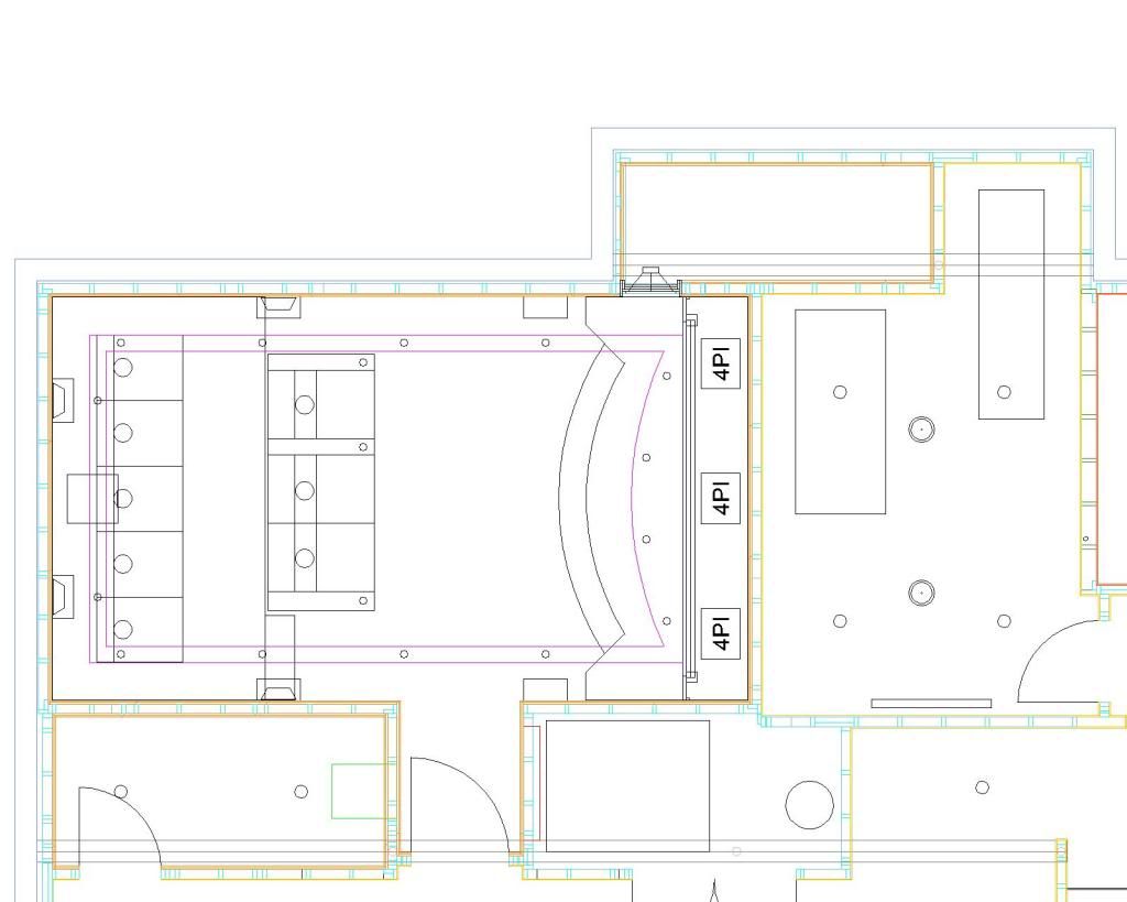

After playing around with the layout a little more (based on feedback I have received) here is the latest version.
The IB chamber is a little small at about 5x Vas for (4) subs but I still think it will be ok. I plan to stuff some insulation in the and try and bump that number a little. This layout also opens up a little room up front between the main speakers for additional subs if I find that the IB just isn't enough (hope that isn't the case but it never hurts to have room to expand ).
I shared half of the foot of space that I gained with the workout room and used the other to shift everything (screen and seats) forward in the room to get the second row a little farther off the back wall. I'm clear of the back wall by about 14" now. Not sure I want to sacrifice pushing things forward more at the expense of viewing distance (front row) from the screen. Current front row viewing distance is 11'-6" from a 130" wide screen.
