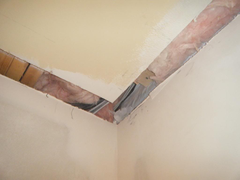

Spaceman's suggestion to cut the ceiling had me change my focus away from the wall again. Given the ceiling is not springing back downward I think a tweak on HopefulFred's suggestion might work out:
Remove strip of ceiling drywall all around room.
Cut a smaller strip of OSB to keep stair-step overlap. No need to worry about cutting into wiring or ceiling not springing back.
Insert new pieces with drywall screwed into OSB on both ends to keep it in place.
I am really hopeful this will work but please burst my bubble now if you see potential problems. biggrin.gif

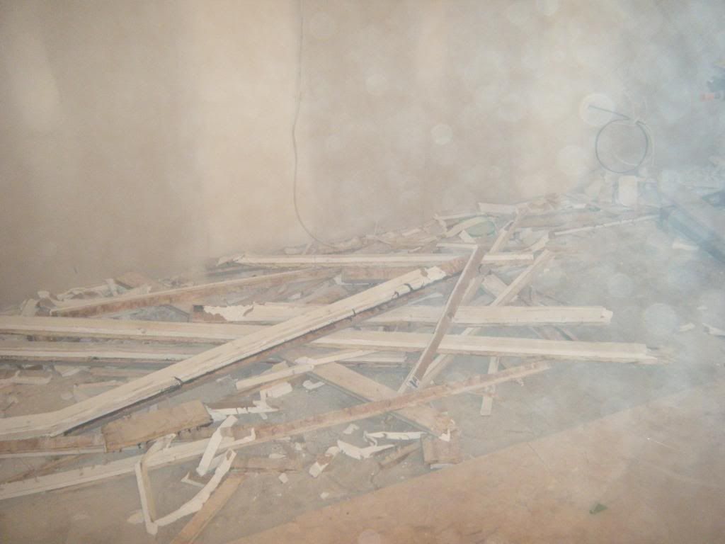

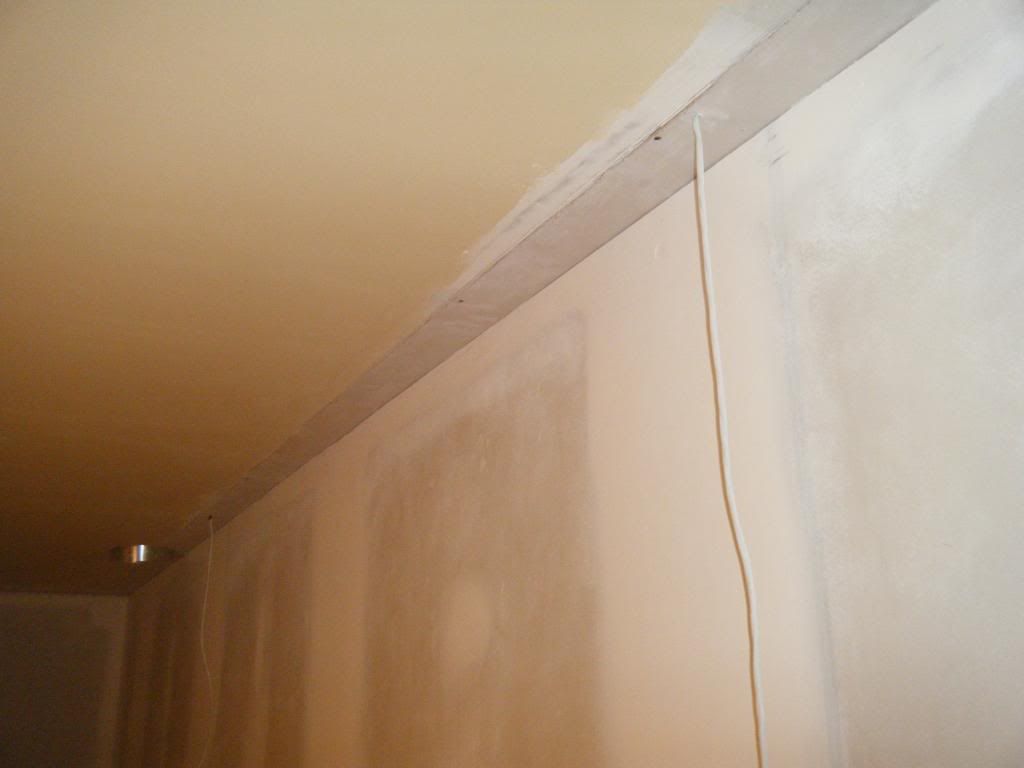

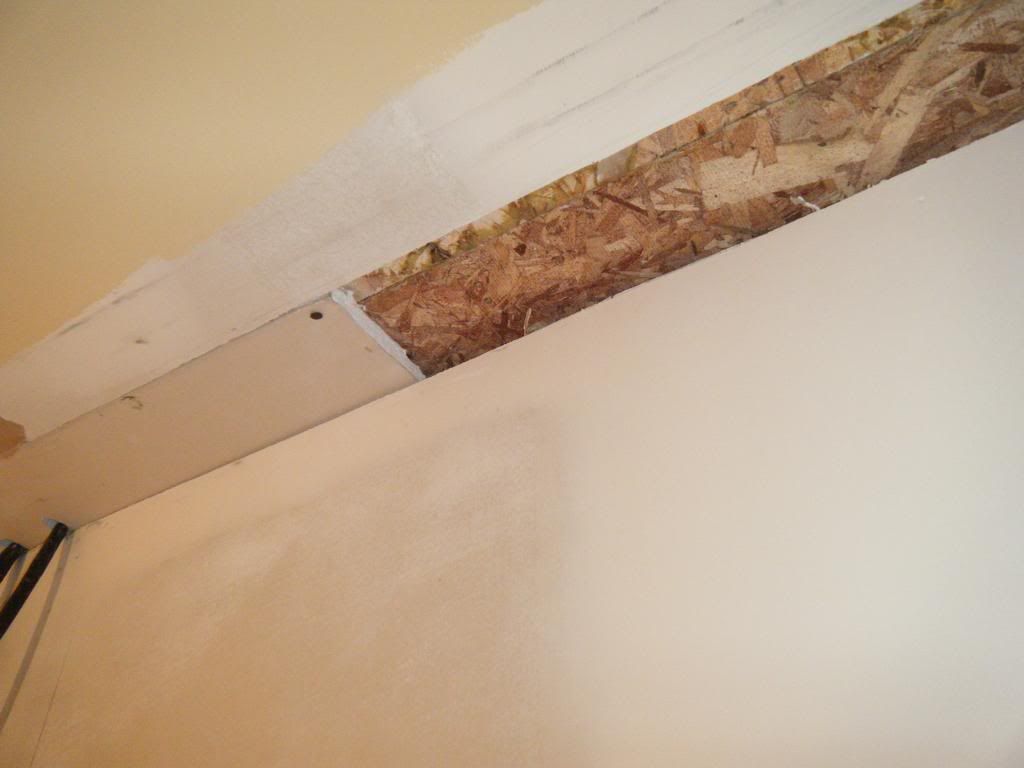

....and now in the interest of not being loganed, here are some updated pics.
Cut away ceiling along perimeter wall. I also cut the drywall further back than shown in this pic to allow for offset seams.
Cutting through drywall with a circular saw creates a huge cloud of dust (good mask is important here biggrin.gif)
Replace both layers...

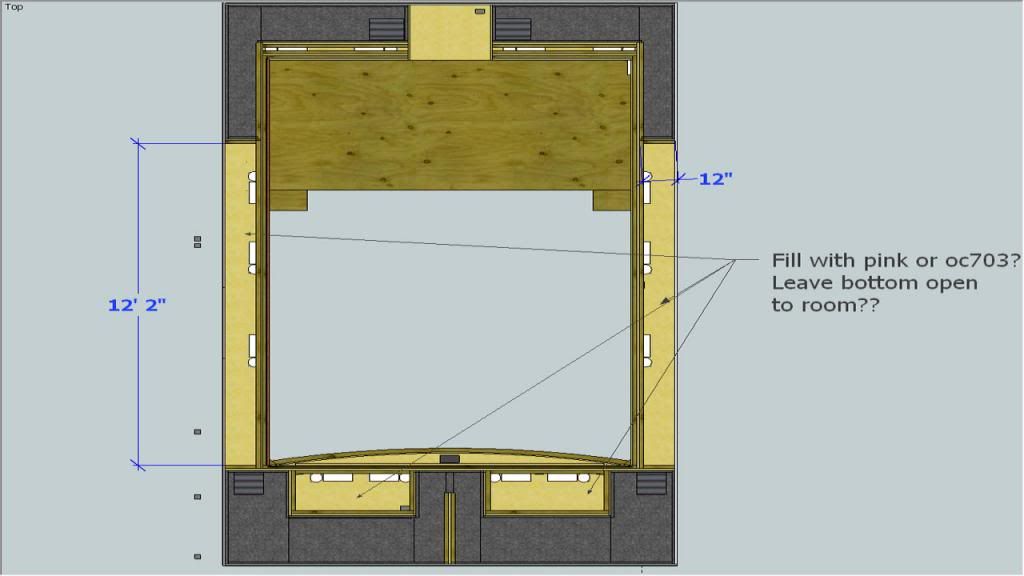

I am currently building my soffits and have sent bpape a question about opening up my soffits for some bass trapping. I may have to proceed before I get his response so maybe I could get some feedback here as well. I have 12' sections of my soffits on both sides of the room that will be covered in fabric. The side (ie vertical piece) of these soffits is already installed with 3/4" MDF. I have the choice of covering the bottom of the soffit with 3/4" MDF or simply covering the insulation with fabric for some additional absorption. The insulation (pink or OC703??) would be 7 3/4" high by 12" wide and 12' in length. Any thoughts? Thx.
post #477 of 548
Originally Posted by 235 View Post
...Now in a position for some forward progress
Sincerely - Congratulations! I know this has been eating at you. I'm glad to see you won't let it beat you. Also - I'm looking forward to seeing how you finish everything here. smile.gif
On the soffits... Have you seen this? http://www.avsforum.com/t/1443066/oc703-on-bottom-of-soffits and the reason that thread got posted: http://www.avsforum.com/t/255432/acoustical-treatments-master-thread#post_2176723
post #478 of 548
Thanks Fred, I looked at some of the posts you linked to and my best guess is that some oc703 in the soffits would be beneficial but maybe with some poly facing...
Edited by 235 - 1/22/14 at 7:29am
post #479 of 548
That was my conclusion as well.
