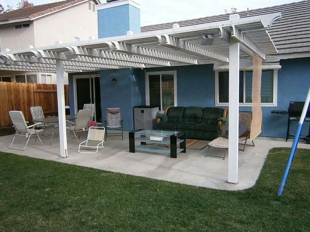

Hi Guys
I have been a member on here for a few years. I decided to make a back yard theater to watch movies and sporting events in the back yard when the weather is warm. I still have my indoor Dragon Fly fixed 106 inch screen that I use with a Optoma HD72 projector. I just purchased a Epson 8350 projector today. With all of these movies coming out that they shoot with dark scenes the Optoma's black level is just not good enough. This projector should be a pretty big improvement and I cant wait to get here.

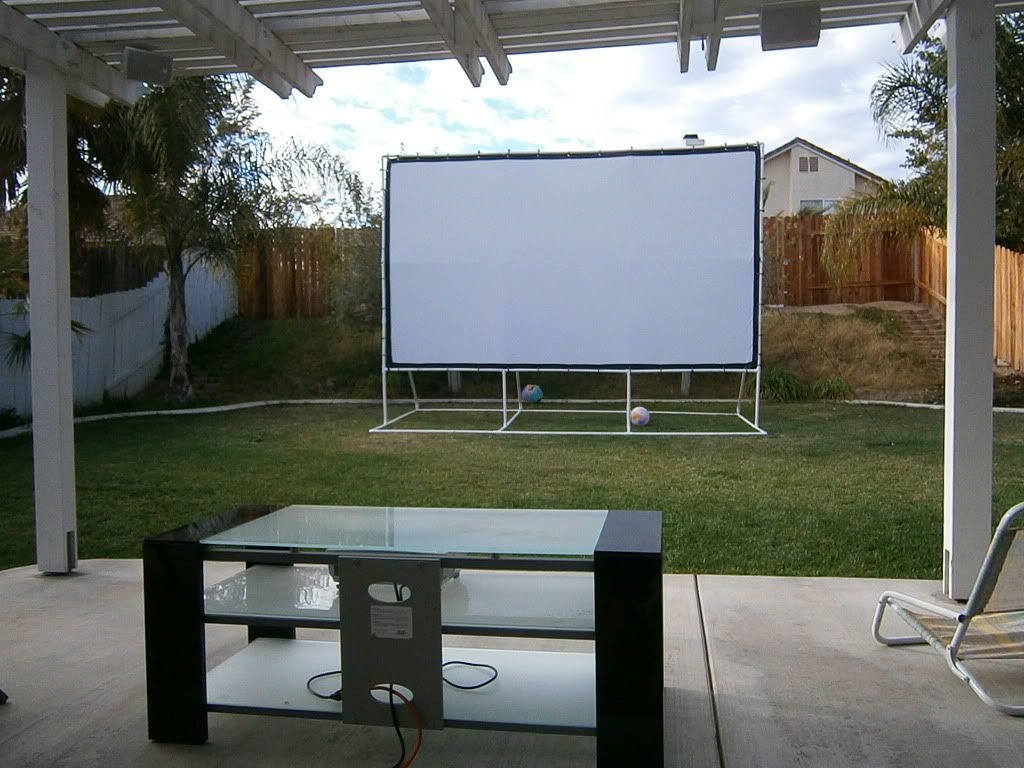

Hi, I purchased the screen materiel off of the internet. I bought it at http://www.carlofet.com/
I made the frame myself using 1 inch pvc that I bought at Lowes. It was pretty easy to make. It gave me something to do for a couple of days.
