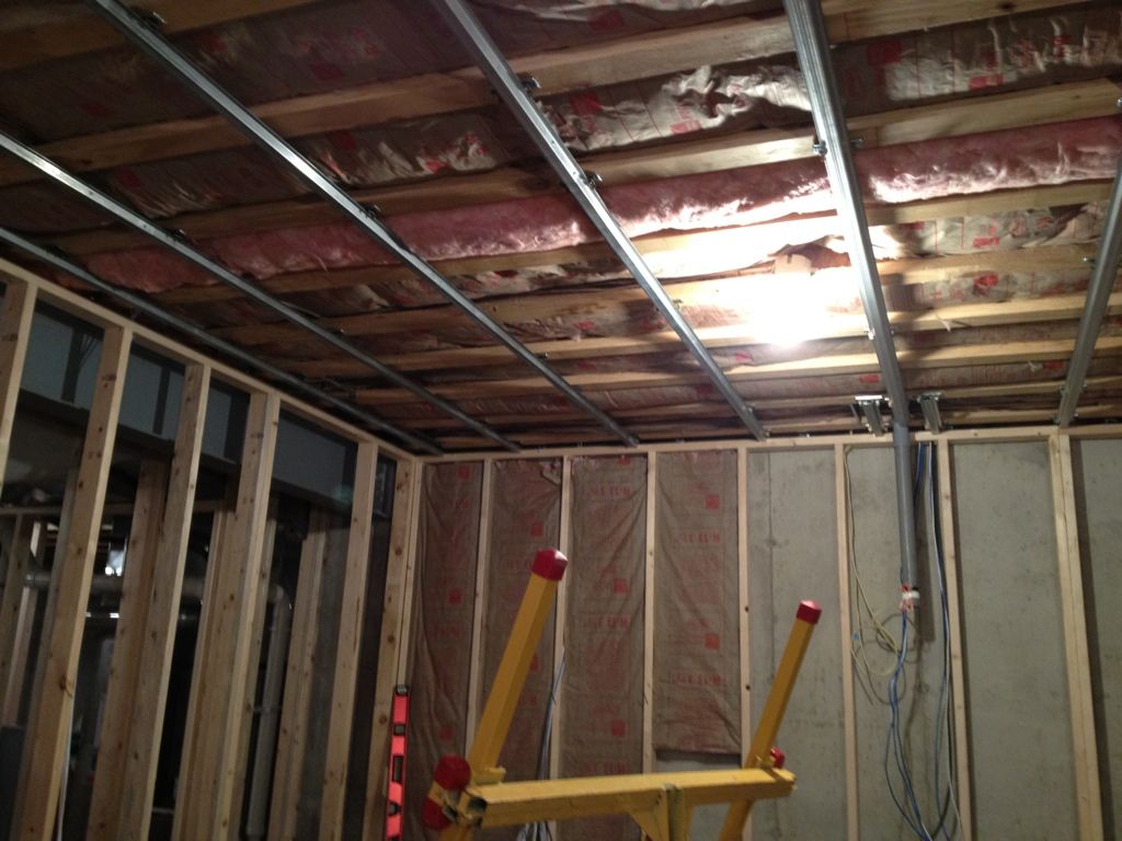

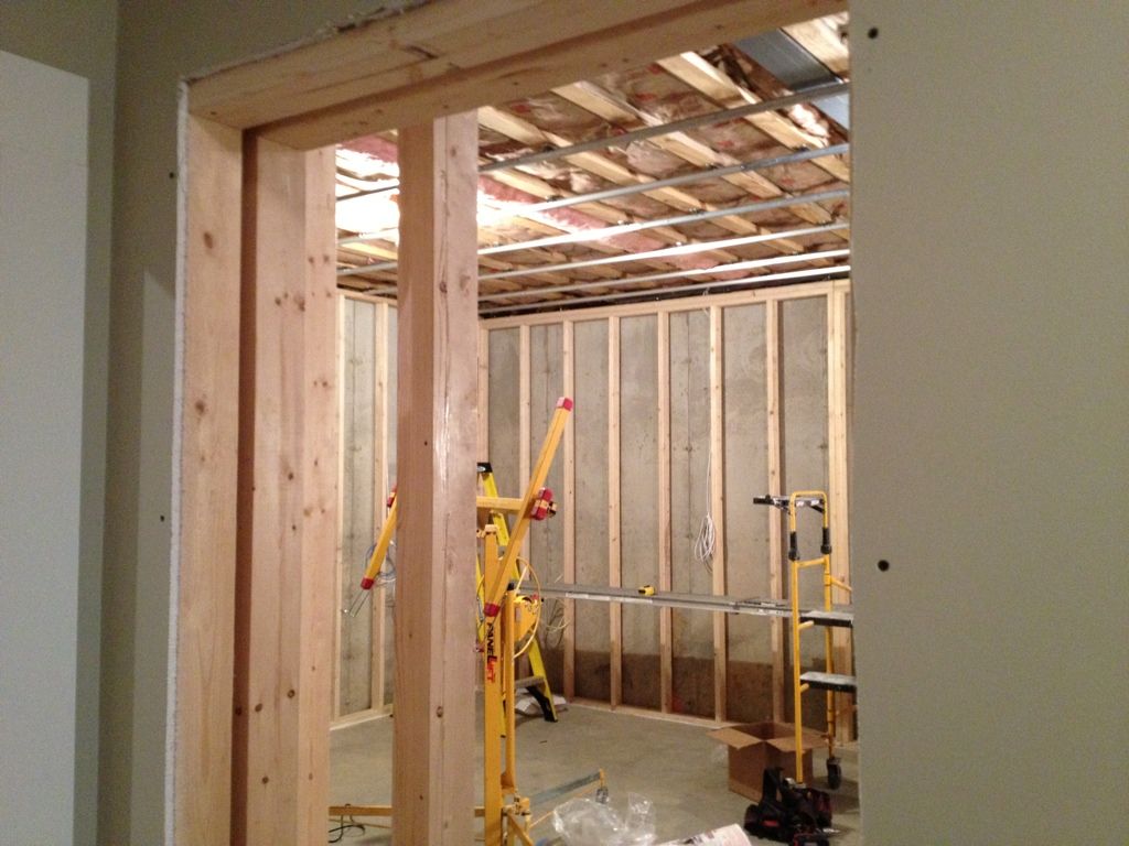

Slow progress but finally getting a move on. Clips/channel installed in the ceiling. Insulation going into the walls. Cut the doorway into the existing wall - really makes it feel like a room now.
Question about the screws that go into the channel. I've seen Big's recommendations to use 1 1/4" screws for the first layer and 2" screws for the second. My builder was wondering why the second layer needs to be 2" long if there is only 1 1/4" worth of drywall/OSB?

Seems to make sense that the 2nd layer has a longer screw since it needs to travel through the first layer to attach to the hat channel.
What materials and sizes are you going with?
post #153 of 205
Are you not using 3/4" OSB and 5/8" drywall? This is what I used. These add up to 1 3/8". I don't think a 1 5/8" screw gives you enough margin whereas a 2" screw is plenty long enough without being too long and shorting out your decoupling effort by contacting the clip. If you are not using these material thicknesses then you will have to shorten your screw length accordingly.
post #154 of 205
I'm using 5/8" OSB and 5/8" drywall...builder was just curious, he thought 2" was overlong, but didn't think it would be a problem.
