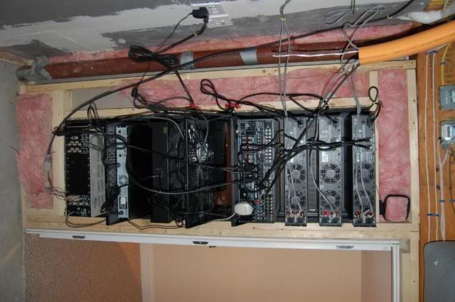

Keep in mind that Mid Atlantic has stuff for all kind of pro stuff. Some of its real heavy duty. You can also scour craigslist for any computer and/or telecom rack and likely fit that in. Since some of the pro stuff can be real heavy some mid atlantic stuff can use extra rails for extra support, or to place wire management devices.
If you want to semi-cheap out, and don't find a steal on craigslist, you can do what I did in my first HT, and by those rear rails only for about $50 and then mount them to a planned opening. See this pic from my old HT.
Then add the rails, shelves and faceplates and you are done. I did this and then discovered if you buy a middle atlantic door, there door is meant to be mounted to a full rack, not just the rails. I had to jury-rig the door. At that point it would have been easier just to get a local glass place to come out and do something.
Here is a pic with the rails in, and a few items that had rack ears.
The other disadvantage of the "cheap" route is that I didn't have rear rails for wire management, so it was kind of kludge.
I probably could have and would have improved it had I not sold the place.
All in all, I was like $50 for rails, $325 for shelves, a drawer ($100 alone) and blanks, and I don't remember the door cost, and didn't see it in my e-mail. Must have been paypal.
I really liked having a rack-rack though. Even though it was only for a month or so.

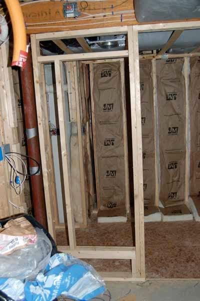

Soundproofing question
OK, I was standing in the unfinished theater space today trying to envision the construction process, and had a sudden fearful thought. If you look at the blueprint for the space below:
Notice that there is a metal I-beam with a metal pipe support which I am going work around.
In my rudimentary floorplan, the metal pipe stands in the dead space between the two proposed decoupled walls (red circle):
So my question is: will that metal pipe conduct sound into the theater, if it is inside that dead space? And if so, would it make sense to build the double stud wall on the "south side" of the pipe so that it is entirely outside of the two studs?
post #54 of 199
If the support is between the walls I don't see how it would hurt sound isolation. Make sure no part of the walls come in contact with it to preserve decoupling. Also when you put insulation in make sure to not compress it against the support to avoid recoupling the wall through the fiberglass.
post #55 of 199

post #57 of 199
How far apart are the two walls going to be to accommodate the post? Were you going to space them out around it or cut a curve in the top and bottom plate to fit it? Either way would be fine. The second option might give you a little more space.
Actually, the two stud walls are going to be about 2 feet apart. The reason for this is that I'm going to extend the already finished wall into the unfinished basement, and then enclose the HVAC unit and water heater so my son can't get to them. I figured that the bigger the air cavity, the better the sound attenuation.
post #58 of 199
Don't know if you've already talked to someone about this but that 2 foot space is a concern.
If the walls are that far apart then you will need to treat that 2 foot space like a seperate room. That distance isn't really room within a room but more like another room. Sound will shoot through your first wall and head right up through the floor between the walls. The walls should not be very far apart. 1 maybe 2 inches at most.

post #60 of 199
Hmmm...ok, thanks for the warning. I will look into that. Gonna be working with bpape on the design, so I will run it by him. The pipe and I-beam are problems then -- the beam is about five inches wide off the top of my head. I will measure the exact distance later. I have plenty of width in the theater I think, so if I have to make it narrower, I don't think it would be a big problem.
